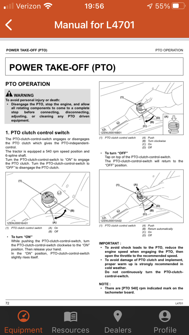

My L4701 is a HST with the twist knob for the PTO. Mine doesn’t have a clutch at all so you can’t use the clutch for anything.
The operator manual, which covers both HST and gear, makes no differentiation between HST and gear in its description of PTO operation so I’m assuming yours and mine work the same (except I’ve never had a problem with mine). For HST it’s like an off/on switch, so you can’t ease it in like you can with a clutch and lever system. Idle all the way down as slow as it will go. Push the PTO knob down and turn it to the on position and increase throttle as desired. It should pop back up a little bit, which provides a mechanical block to it rattling itself off without being pushed down a little (same as putting a turn knob 4WD truck in 4W low). If it can pop off by itself, I’d have to think there’s something wrong with the turn knob switch. It shouldn’t be able to move from on to off or off to on without pushing it down.
Of course the engine will die if a safety switch breaks contact, such as if you engage the PTO while sitting in the seat and stand up without disengaging the PTO. However, the knob shouldn’t be able to move without being pushed down.
If it’s not operating per the manual (pertinent page above) and it’s under warranty, I would suggest having the dealer take a look at it. Otherwise you might consider whether there’s a problem with the switch knob itself.
