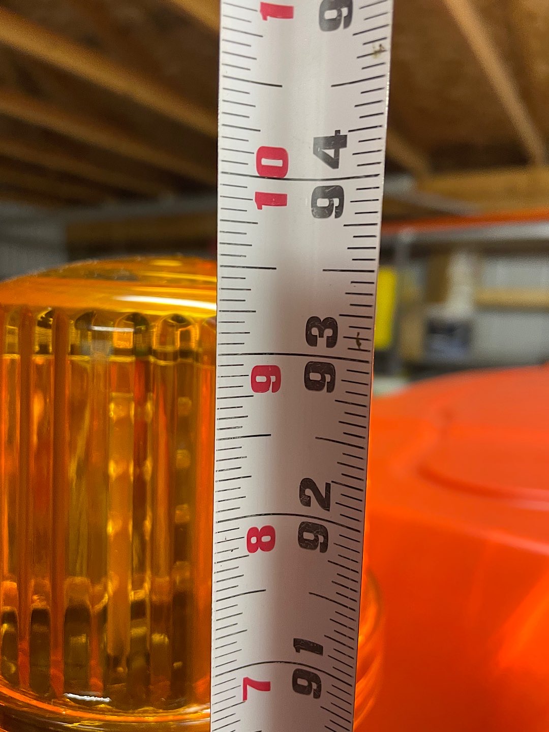

I found a site saying the 4060 is 97" with the Rops and 91" with the cab, and another site saying both are 91. I'm hoping for a real world measurement as 97 won't fit in my barn door and I don't want to fold the rops down all the time.
Heres my cabbed 4060 with flasher that sticks slightly above cab. R-4 tires.

I ended up buying the 4060, very happy with it. However it does NOT fit fit in my 8 foot barn door, pretty disappointed there. I asked the seller to measure it and he said it would fit. R4 tires with ROPS.

No way I'd be disappointed. Do you want me to take it off your hands? :)
That ROPS looks like it folds. Annoying to do, and annoying when you forget to do it. But that'll work.

It folds, but on our property I'll want the ROPS up pretty much any time I use it. We have some hills. Checked tire pressure, it's plenty low. I ordered a ballast box, maybe it'll get me to just squeeze in.
