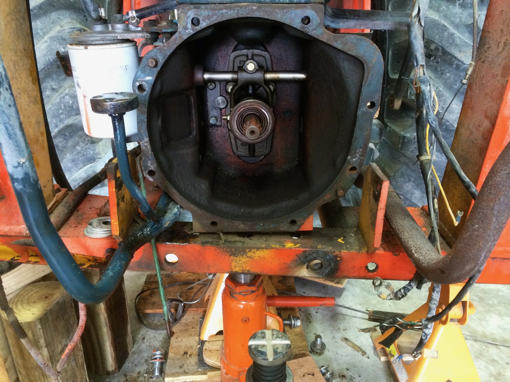

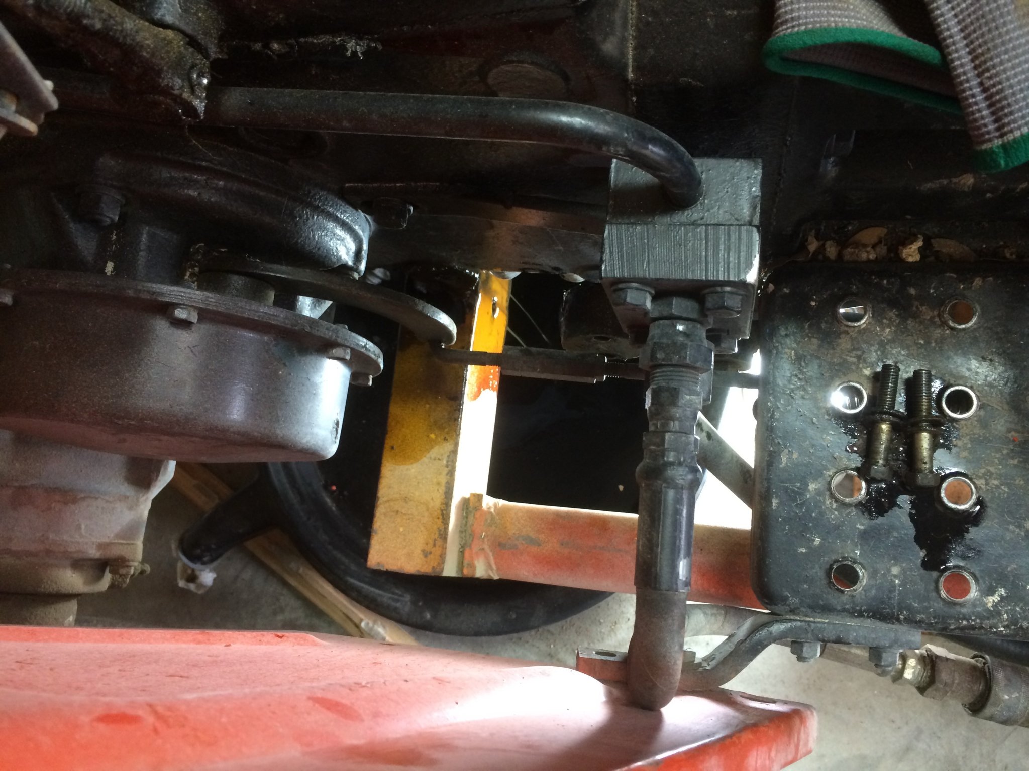

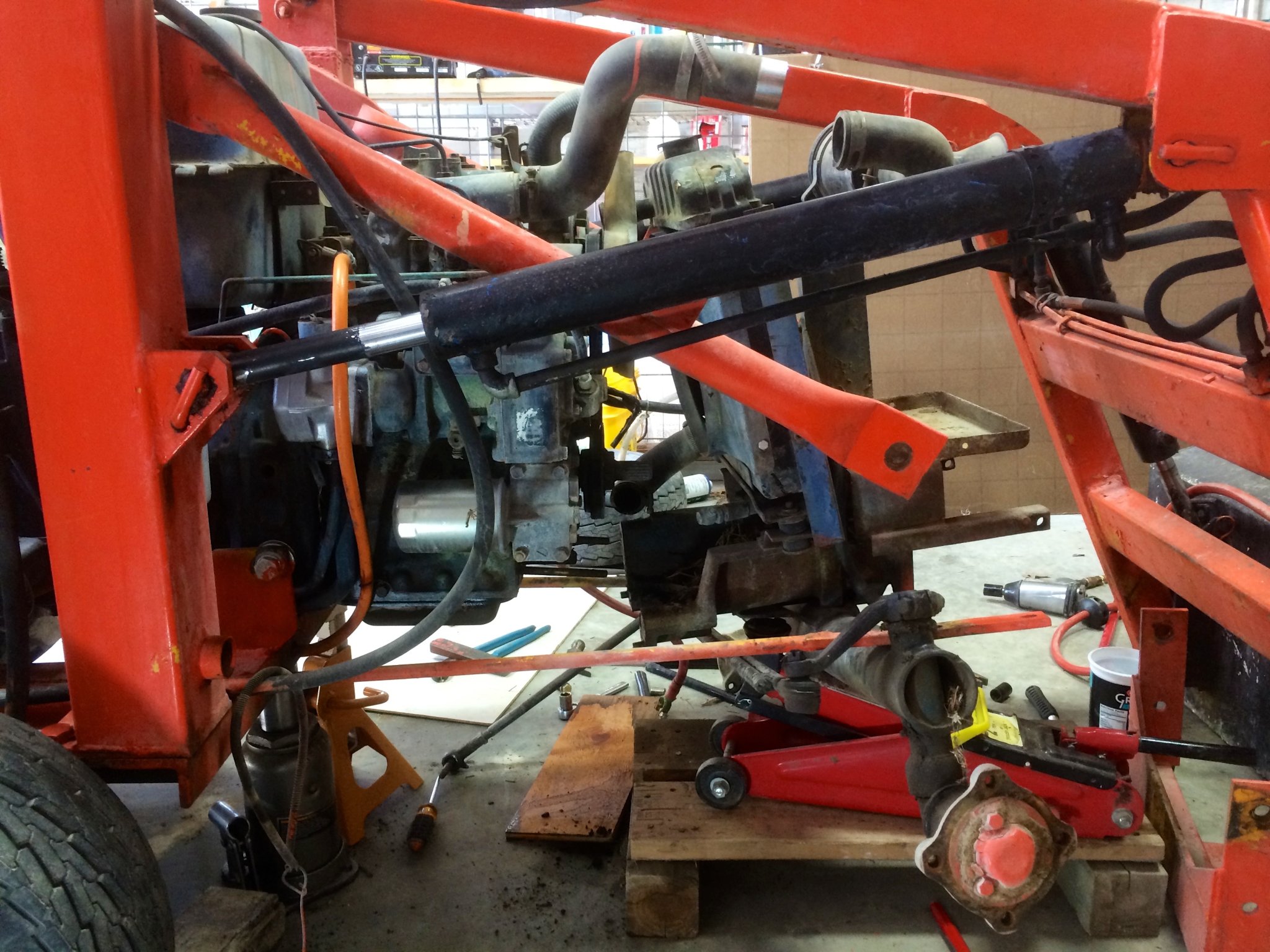

Don't know if these pics can help. This is when I had to pull the motor several years ago.
Only other thing that comes to mind is there are two large hoses running front to back with couplings right under my foot.
View attachment 114288 View attachment 114289 View attachment 114290
That helps. Are there two hoses connected to the block in picture #2? There should be.
One is pressure out to the loader and the other is power beyond return. There shoulbe also be a third hose going to the tank. I don't see it in the valve picture so someone probably used a loader valve that does not have power beyond. You will want to correct that when you install the new valve.
Yeah, according to the parts diagram there's a 2-port hydraulic block in the pump discharge line and the existing loader valve doesn't have a relief valve so . . .
Yeah - and no pressure relief is a much bigger issue than using tank for power beyond. With the new valve that's getting fixed as well.
You will need to purchase or more likely make some sort of tank return fitting. Being a machinist that should not be much of a concern.....

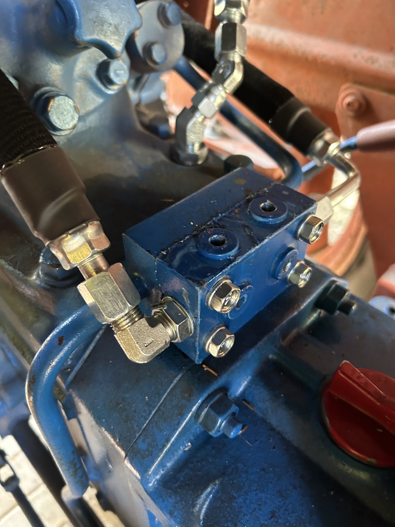

It really is a simple upgrade. I think your tractor will have a threaded port on top of the transmission to put a fitting into, then add one more hose to the system between the valve and the port.
I have a port on my L185 that is shown in this picture on the upper right with a 45 degree angle fitting in the port. The port size is BSPP G 3/8 and the other side on mine is JIC #6 male. I then used another 45 fitting JIC Female swivel to JIC male with a JIC female hose end just to make the hose route work better and I had the second fitting in hand. I remember both of the fittings being about $15 total. The BSPP port is similar to the SAE ports using an o-ring and nut to seal against the machined surface on the tractor.
Some tractors don’t have the port so a fitting is needed to get into the tractor and some people use the transmission fill port with a tee type fitting that is machined to fit the tractor port and have a fill port.
Strange - that outlet block looks vaguely familiar....
