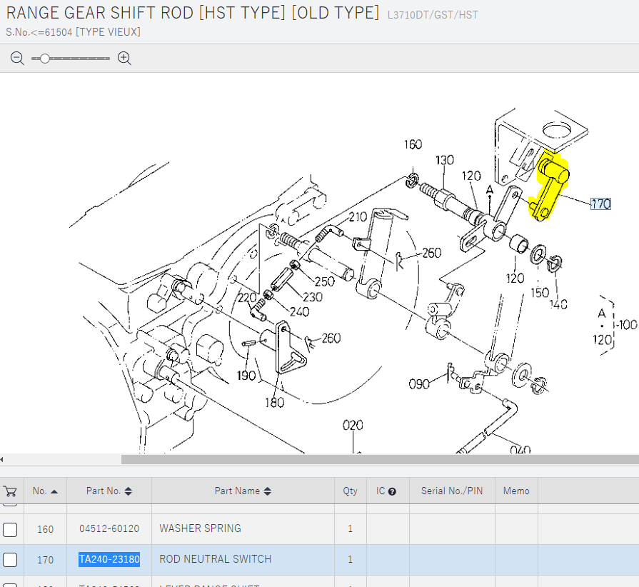

part of the adjustment linkage has loosened and fallen off. i am trying to identify the part and replace it. it is the piece that actually pushes the safety switch in. L3710

That's the switch for range, it's most likely a neutral Indicator.
Your missing on part:
TA240-23180

That looks about right. Thank you very much for the help. I will get one and let you know how it turns out.
