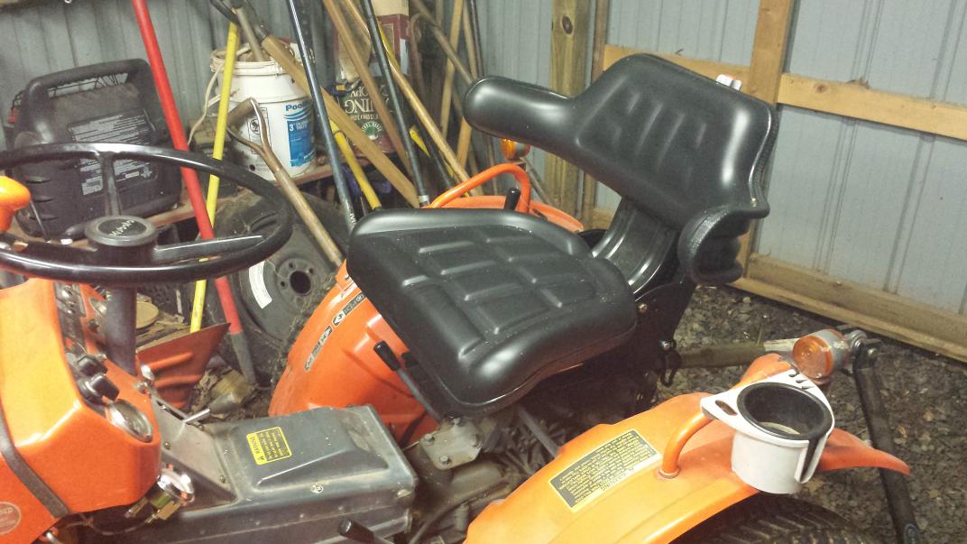

Do you have a picture of this installed on your tractor? Did you have to do lots of modifications to make it work?
I am also in the market for a seat for my B7100.
Thanks!
Jr,

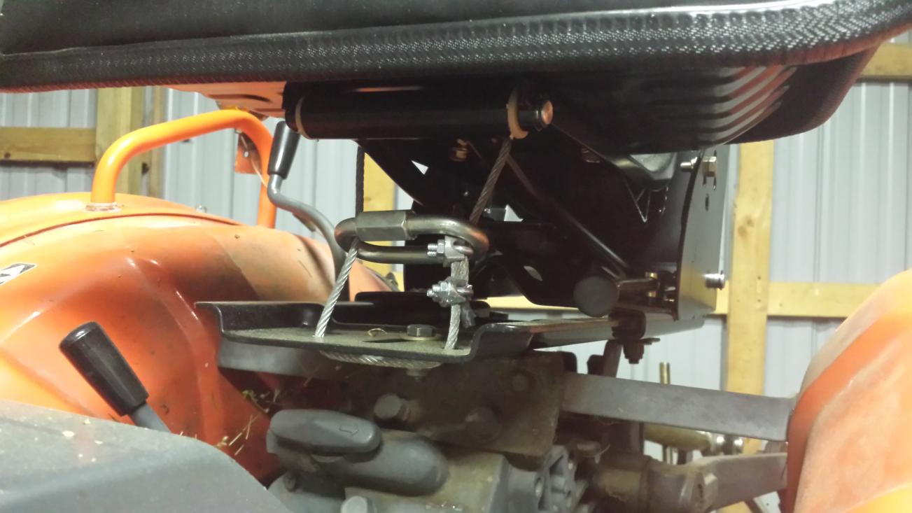

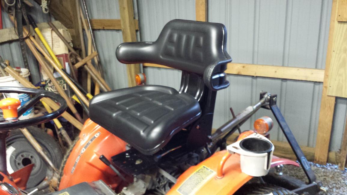

I have that one installed on my B7100 that needed a seat, the seat was completely rusted though. I cannot remember if I had to drill a couple more holes, I think two did matched up and I needed two more. Once installed I was a little disappointed at first - why? I was like a helicopter pilot! I was so far up that it felt weird to drive:eek: - everything was still in reach, but the way the "shock" absorber is designed in the back I could not adjust it to sit low enough.
I did make a correction to the seat and it is now excellent to use - armrests are made of metal and I bent them in a bit on each side to create a cradle effect.
Here are some pictures - to make it stay down, I had to run a small piece of cable through and clamp it in place to hold the seat as low as possible.
