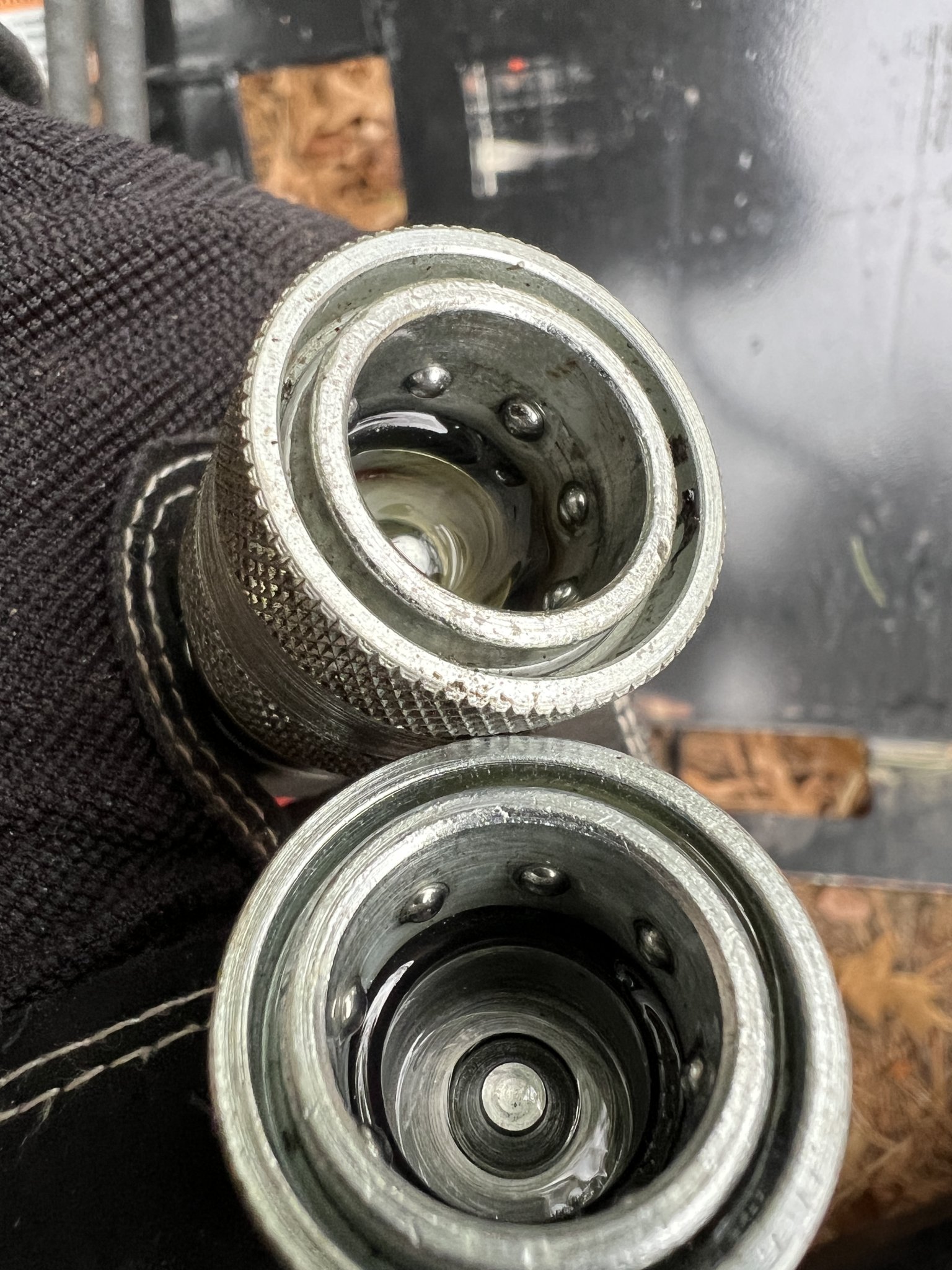

Coupler issue. It fits but slightly different and fluid not flowing. Top is the one on my old grapple, bottom is my new one. You can push pull a little after new one connected. Frustrated as not sure what to do… right now use my old one!
10,833
5,947

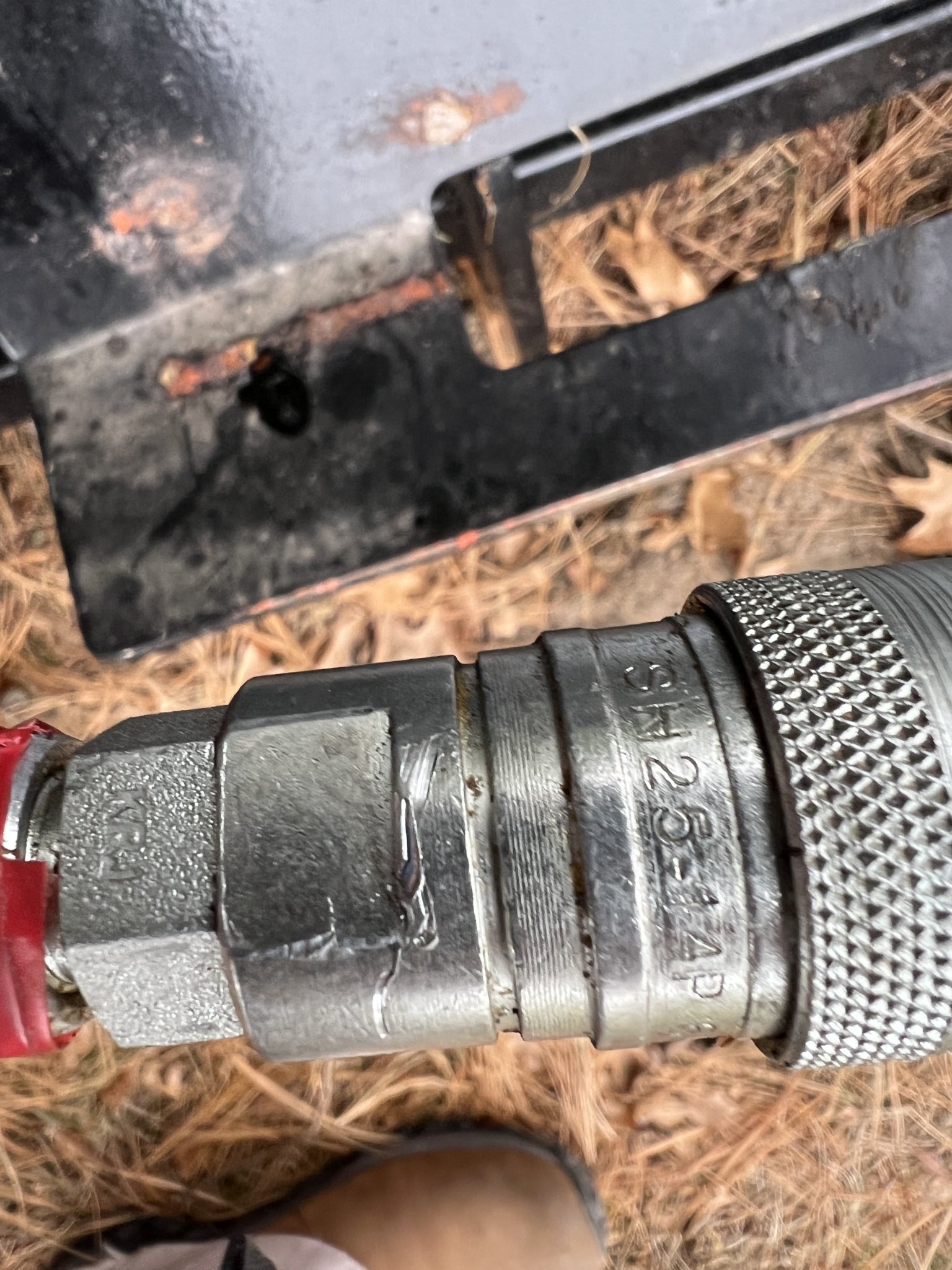

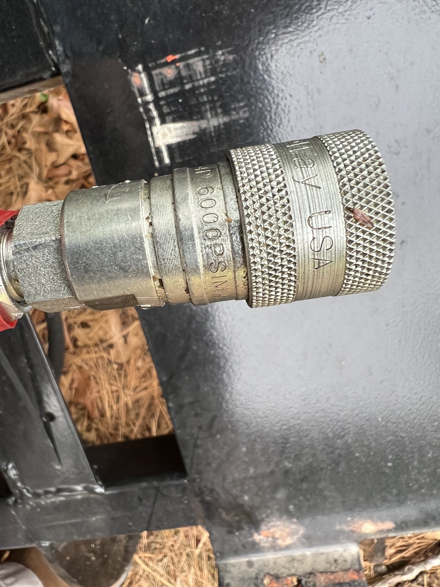

Get the part numbers off both couplers and post them here.
10,833
5,947
One looks like a Poppet style and the other looks like Ball style.
As long as they are the same series and size that should not matter. I have some of both style here and they interconnect fine. Sounds more like they are differrent series or size. Part numbers will tell that story.

As long as they are the same series and size that should not matter. I have some of both style here and they interconnect fine. Sounds more like they are different series or size. Part numbers will tell that story.
I have read where some people have problems mixing them, so I wanted to point it out to the OP.

Had some issues posting pics but here is the male connector on the tractor

Had to leave for a bit sorry!
pic of part number on old grapple (works)
