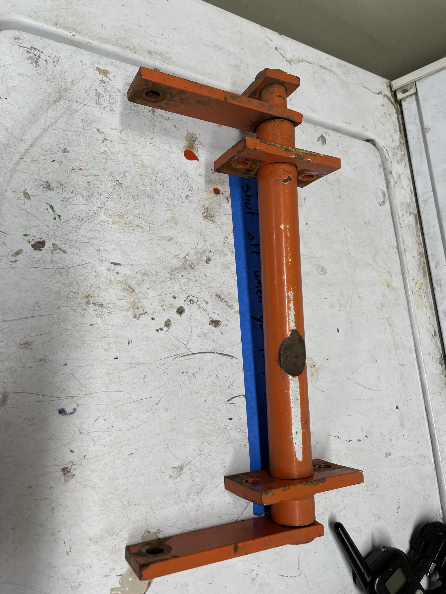

Hey guys, anybody that has ab8200hst with the mmm, can I get you to take some detailed pictures of the lift mechanism? I widened the piece I had ( not the correct part) and it works ok but not sure I mounted it correctly. It seems as if I mounted it to low and the pto shaft hits it before it can even lift the deck off the ground.

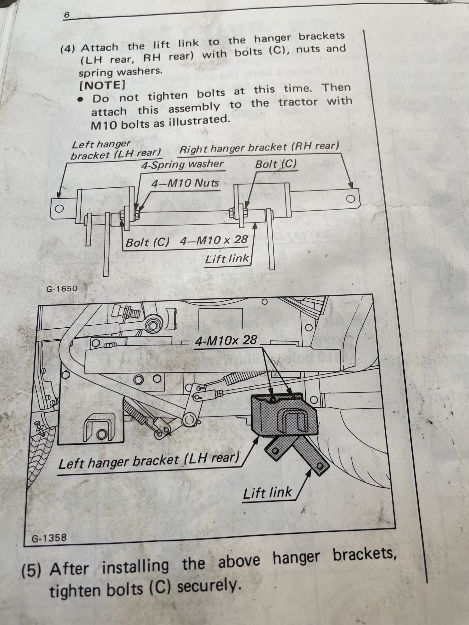

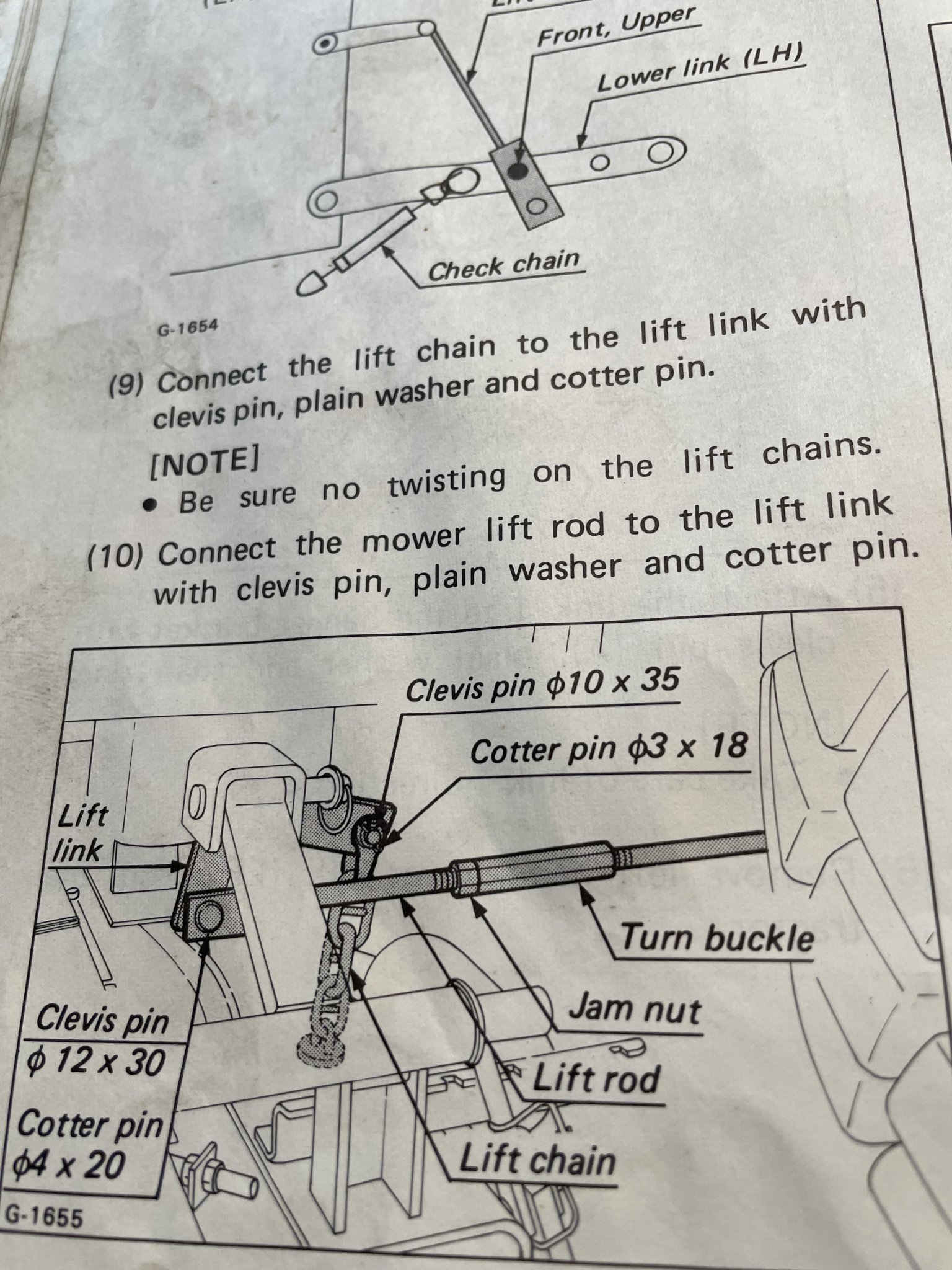

@kubotasam if the manual shows how the part above is mounted a picture of that page would be great. Also, if your interested in selling the manual?
I have part #6. I would sell both the manual and the bracket. I will need to see if it will fit in a USPS flat rate box. to find shipping cost. The manual does not have a great picture of the mounting. Hope pictures will help.

I have been asking for that bracket on here for months. How much would you take for both?
Chech your private messages (conversations) -- white envelope in upper right corner.
