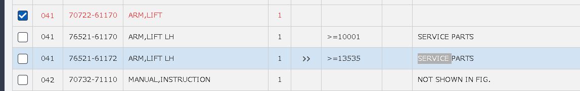

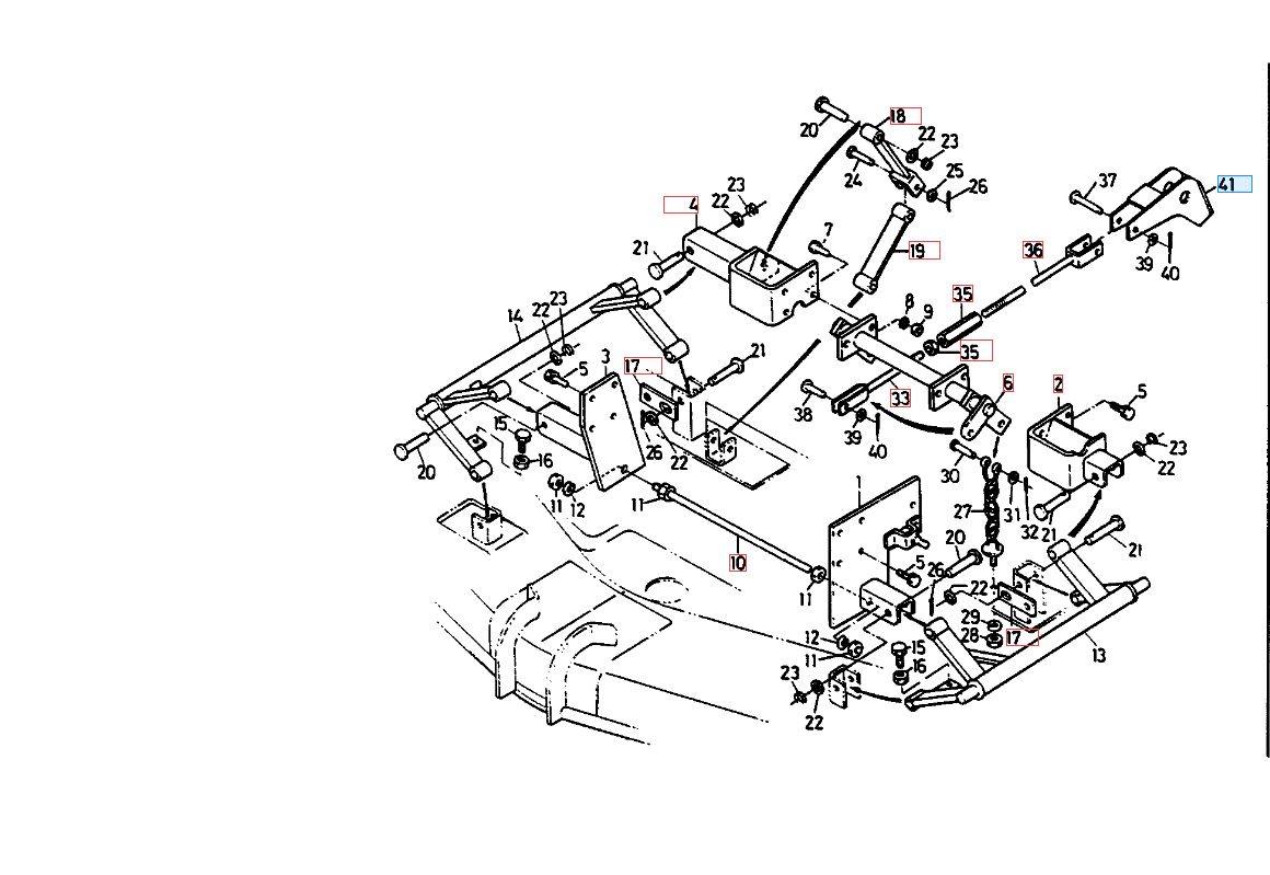

is the serial number needed the one for the tractor or the one on the mower deck?
and most I have seen (pictures of ) seem to have 2 of these also. again, number 41 hilighted in blue
and ive seen 2 arms that go to the front of the tractor, do i need those? or is that something different?

I am of the opinion that you need the front two arms to attach the mower to the front part of the frame. Both of my machines have the same aforementioned. I don't see much other option.

Those are not on the parts list. Where would I look for those?

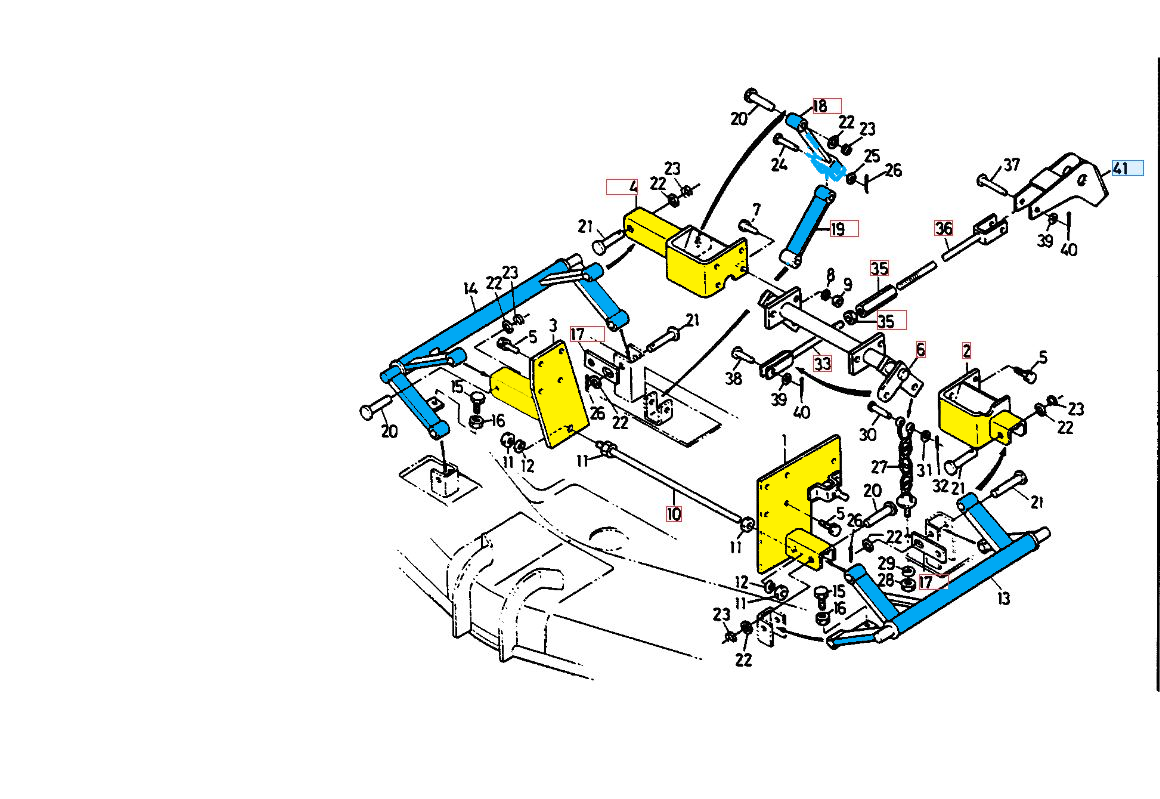

The parts in yellow bolt to the frame of the tractor. The parts in blue hang from the yellow and suspend the deck under the tractor. This mower deck does not use the bars that go to the front of the tractor.
