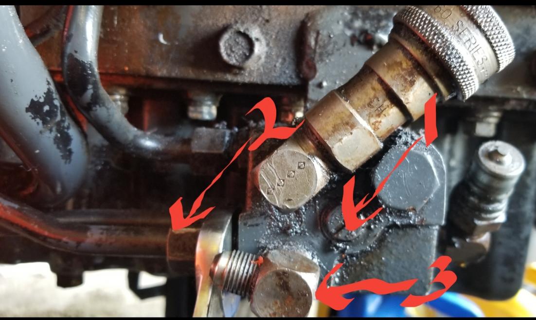

Wolfman, i turned the screw #1 in photo and fluid gushed out of #3 connector in photo. I turned the screw back and it quit gushing out. I cracked the nut on #2 line in photo and nothing came out??? So for some reason no flow in that line but turn it the other way and fluid gushes out of the connector...i am a little stumped to say the least...
It looks like it has a line that runs from pump to the block. Then 2 lines back to the 3 point. I did not crack the other line yet to see if their is flo.
36,651
11,372
Go back to the loader lines and get the line off the loader control that has the male quick connector on it (the one that came off of the bottom fitting), and reinstall that line. Then connect that line to the female above it. ;)
Then you won't need to turn the slotted valve or have fluid gush onto the floor.

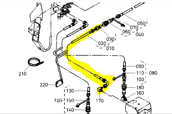

Thankyou Wolfman again for all the help...i took the line off the loader control with the male connectior and screwed the other end onto the fitting. (Photo attached) So i do not need to turn the slotted screw correct?
No you don't, that created the loop needed to make it work, You could also turn the slotted selector but it's just a waste of time as the loop does the same thing as selector.
