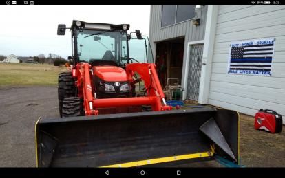

ok guys here's the scoop. I pushed snow today for the first time with my bx1880 and my new land pride 60" pusher....per the dealer I left the pusher in float and attempted to push. However, I noticed that I could not control left or right turning ..it just kept going straight. So if I raised the pusher just a touch I got my steering control back. I also noticed in using the backdrag option that that pusher likes to kinda uncurl under pressure so i had to keep that a tad off the surface too.
So here's the 50 million dollar question. anyone out there use a snow pusher in float and still have steering? or have any advice on the backdrag issue?. I am petrified of blowing out that center cylinder on my FEL...
oh by the way..this is a paved driveway.
thanks guys !!!!

The front axle is being lifted as the blade encounters increasing resistance, hence the loss of yaw control.

You might try using your curl adjustment to see if that helps keep your front end down when pushing snow. Sometimes small adjustments will get my steering back, other times I may have to back up a bit and hold it up off the surface, and take two bites at it. This snow was heavy here, with a hidden layer of ice in the middle. What do you have on your three point hitch for weight? I usually use my back blade, or box blade, because then I can push snow or pull snow. With nothing on the back you will not be able to push as effectively, and this might cause you some problems like your describing. Four wheel drive can be a big help with direction control when pushing snow.
I would use your pull back option sparingly, go slow, and on a paved driveway you shouldn’t have to be too worried about your curl cylinder. Back dragging fast in uneven ground with roots and rocks catching at your blade is a good way to do some damage, but carefully pulling snow back from the garage doors should be fine.

What Hagrid said is correct. It is NOT just the loss of steering w/ my unit but the front wheels rise up enough to negate the front wheel drive assist.
Hence rear wheels begin to slip. I have 300 lbs of weights attached to front bumper, but it it not enough to overcome the wheel lift.
EDIT:
WFM, IF you read the OP thread starter, he is discussing operation in the FLOAT position wherein the terrain determines the loader position, height. Loader control valve does not use or offer common sense as a setting.
There is no intentional lifting of front wheels in his scenario, as it occurs do to inertia forces against the pusher. In theory, float should be ideal, but the actual result is not. A bucket will react differently than a blade, @ least until the bucket is full. And then bucket may continue cutting w/ overkill spilling last the sides because the weight is in the bucket and not simply pushing back against the very blade. Again different animals.

Small adjustment may be required when pushing. May not be a good idea to keep it in float mode as the increased resistance will naturally lift the front wheels. I have a 72" Cotech snow pusher on my 3901, and see this once in a while. Rolling the pusher back a bit with the curl function will let the pusher ride on the shoes a little more, and should help you a bit.
I had noticed last season that when back-dragging, that the pusher would "kick out", and I would have to lift and force the curl function back down. It was due to some air in my hydraulic system. After bleeding the system, the problem ceased. SOMETIMES, JUST CYCLING THE CURL FUNCTION ALL THE WAY UP OR DOWN A FEW TIMES WILL PURGE THE AIR FROM THE SYSTEM.

Thanks for all the info guys.... maybe its just an "adjustment" period and I need to play my way through it....
I have a ballast box on the back of my BX, prob has like 250-300lbs in it .
Im not sure about the backdragging curling, thing... maybe there is air in the lines..thats possible...the other thing I dont like is the backdrag edge is metal...should be poly....IMO
Thanks for all the info guys...I will keep adjusting my technique...it is kinda hard to tell if the pusher is completely level at times, I may have to invent a level indicator of some sorts.
