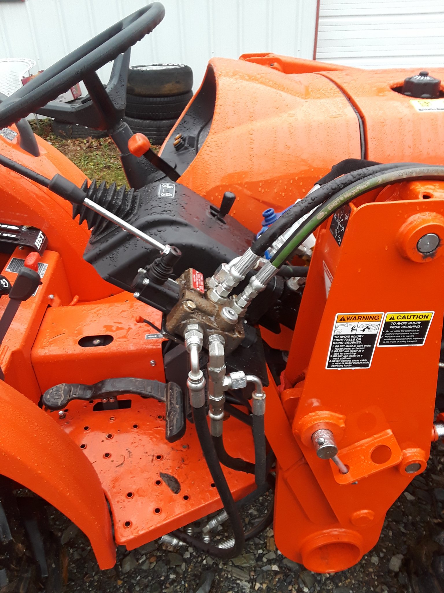

I don't see any advantage to this placement. Just put the new valve in the power beyond circuit coming off the loader valve. Full time availability and works with or without backhoe installed. Also cheap and easy to install. Here is one on my L3901.

Am I correct that the new valve you suggest being connected into the loader PB circuit should itself have PB? i.e. if the owner orders a valve he should order the pb option with it?
Dave
9,500
4,974
Dave
Yes. In the picture the two hoses on the outside are tank return and high pressure carry over to the 3pt.

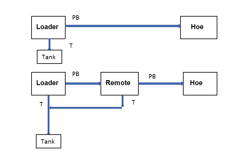

Your backhoe is fed from the power beyond on the loader valve. This is just a question of where you make the connections to the power beyond loop.
To install a new remote up front all you do is disconnect the existing backhoe hose from the loader valve and reconnect it to the power beyond on the remote valve. Then run a short hose from the power beyond on the loader valve to the IN port on the remote valve. That puts the new valve between the loader and the backhoe where it can stay full time and is exactly how a factory remote is installed.
You must also tee into the tank return hose on the loader valve with a tank return for the new valve. You have to do that whether the valve goes up front next to the loader valve or is plugged into the backhoe couplers.
This plumbing is very simple and easy to do. Here is a before and after diagram. All you are doing is mounting the remote valve next to the loader valve and adding two short hoses.
