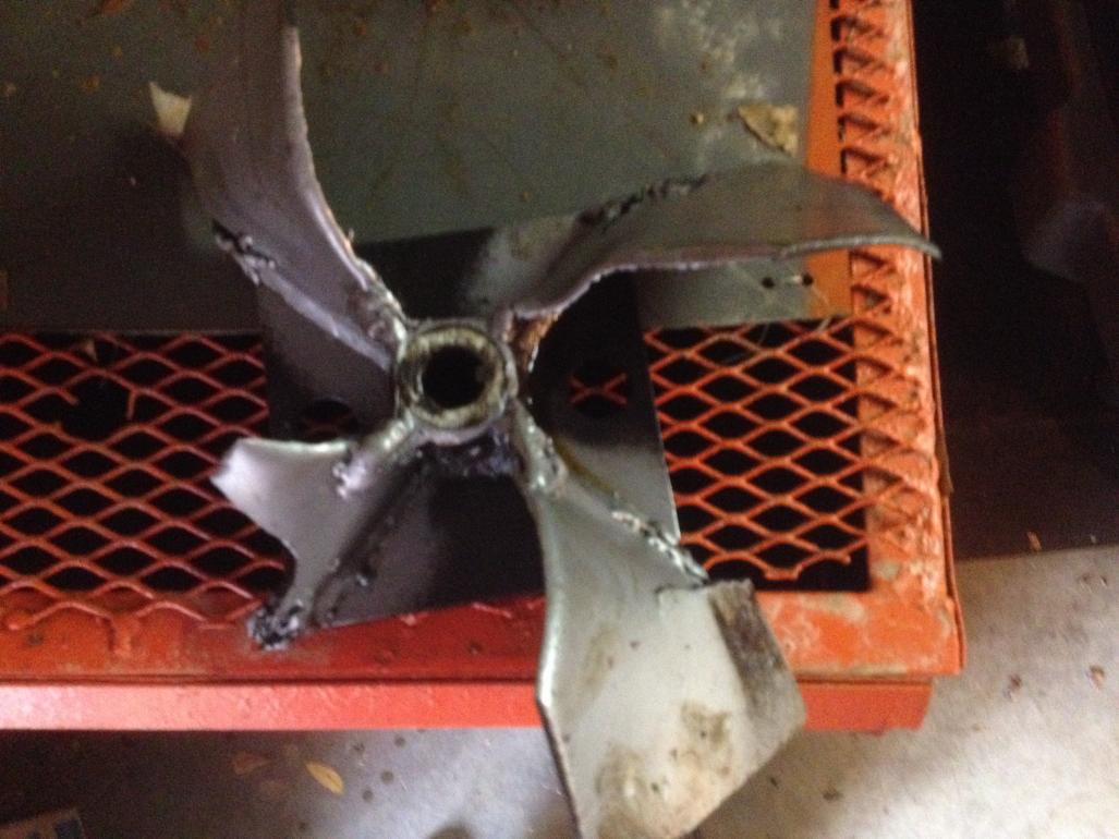

My impeller on my leaf machine trailer threw a blade, Has been used almost 30 years, and welded a bunch , Definitely time for a replacement, 4 blade, blades are 4 inches deep, 12 inch diameter, .750 shaft size . No model number or Id on it. If anyone has any ideas ,please let me know! picture is my bent, cracked ,broken impeller !

Get a local welder/ fabricator to make you one. ;)

There is one on flea bay right now that looks very similar. You might look it up and ask the seller for some dimensions.

I'd plan to get anything close in overall diameter, not necessarily the same hole diameter. Then, the job for a machine shop is much easier to make that fit your machine.

Think I am going to try repairing the piece I have, everyone I contact said obsolete , So it lasted 30 years , straighten , weld, harden , at 64 , I won't be using it another 30 . Thanks for replies!
