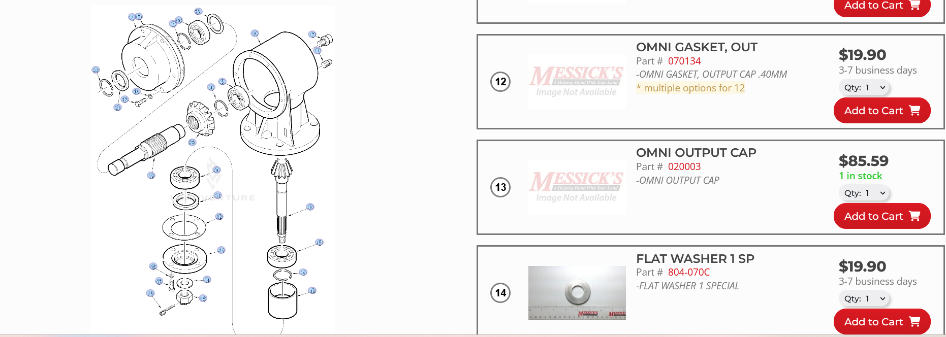

The only knowledge I have is what the parts diagrams show. IF I"M SEEING IT CORRECTLY, it appears the pinion shaft has to be removed from the gear box after the gear box is removed from the deck. The stuck part would prevent removing the gear box because the damaged part is larger than the hole in the output cap.

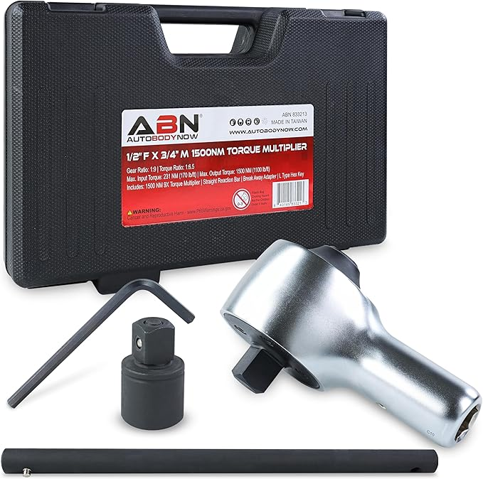

I just did the rear end on my truck and my 1/2 inch tooling was not cutting it, so I bought a "Torque multiplier" and it worked great.
https://www.amazon.com/dp/B0DGYSFR3R?ref=ppx_yo2ov_dt_b_fed_asin_title
It made a yuge difference.
I went from "Broken down Old Man" to "Superman" in just a few seconds......hahahah......."Give me a lever, and I can move the world".......
Just a thought if your having trouble attaining that torque.
6,708
2,256
But remember, if using a torque multiplier, to reduce the input setting in accordance with the ratio of the torque multiplier!
Captain Obvious would hate to see you damage the gearbox shaft!
This is a good suggestion. But what is it? It says gear ratio 1:9 on the box but torque ratio 1:6.5. Should that not be the same?
#40Fan
Jul 21, 2022
406
281
6.5 is the number you want to use. The gear ratio would be how many turns of input to number of turns on the output.
Hugo Habicht
G1900
Jun 24, 2024
776
1,107
Ireland
Yes, I know. But should they not be the same? n1 x T1 = n2 x T2 for lossless gears. So n1 / n2 = T2 / T1. Torque and gear ratio the same.
#40Fan
Jul 21, 2022
406
281
I've seen the same type of wording on Snap-on multipliers. I'm thinking it has to be the loss of torque through the gearing that derates it.
Hugo Habicht
G1900
Jun 24, 2024
776
1,107
Ireland
420Nm loss at 1500Nm output torque? Hmmm, I don't know. And it is static torque, not rotating. Further down in the text it says x9 torque multiplier. The max. input and output torque ratios correspond to 6.5 ratio though, so that's most likely what it is.
You can always take a torque wrench for adults :giggle:
Sorry, did not want to derail this thread.
