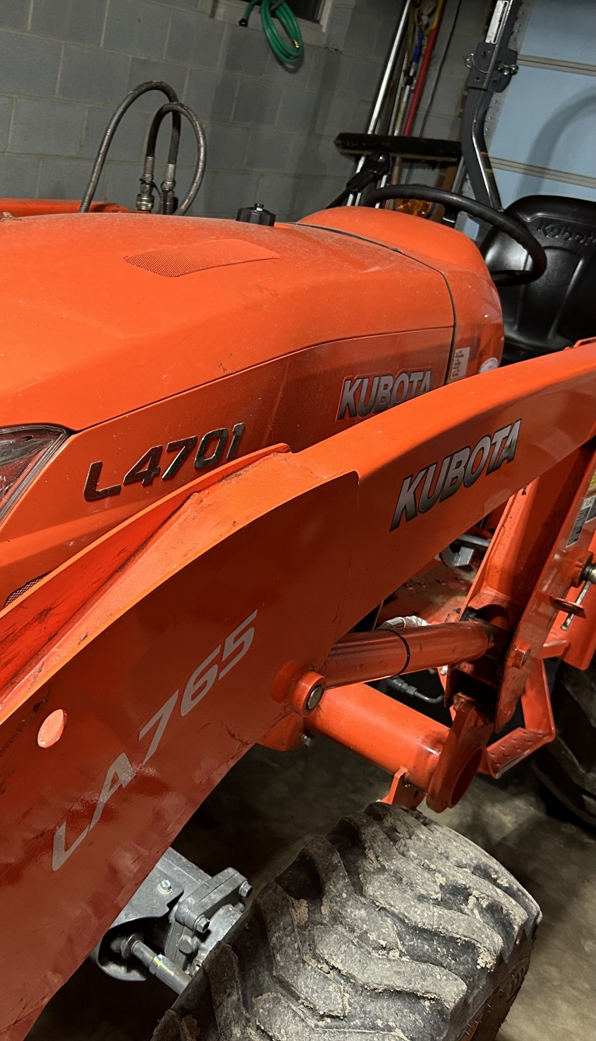

Unlike some others here, I can’t list off all the tractors that use the LA765 loader. I know the L4701 does because I have one. So, first step: Check what model tractor you have. In the below pic, the loader is a LA765. The tractor is a L4701. So check the hood for the model number. If there’s nothing there, check the badge on the right frame rail just behind the front tire. IMG_1591.jpeg

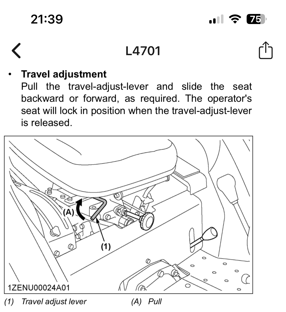

Below is an excerpt from the Owner Manual for the L4701 explaining how to slide the seat forward/backward.

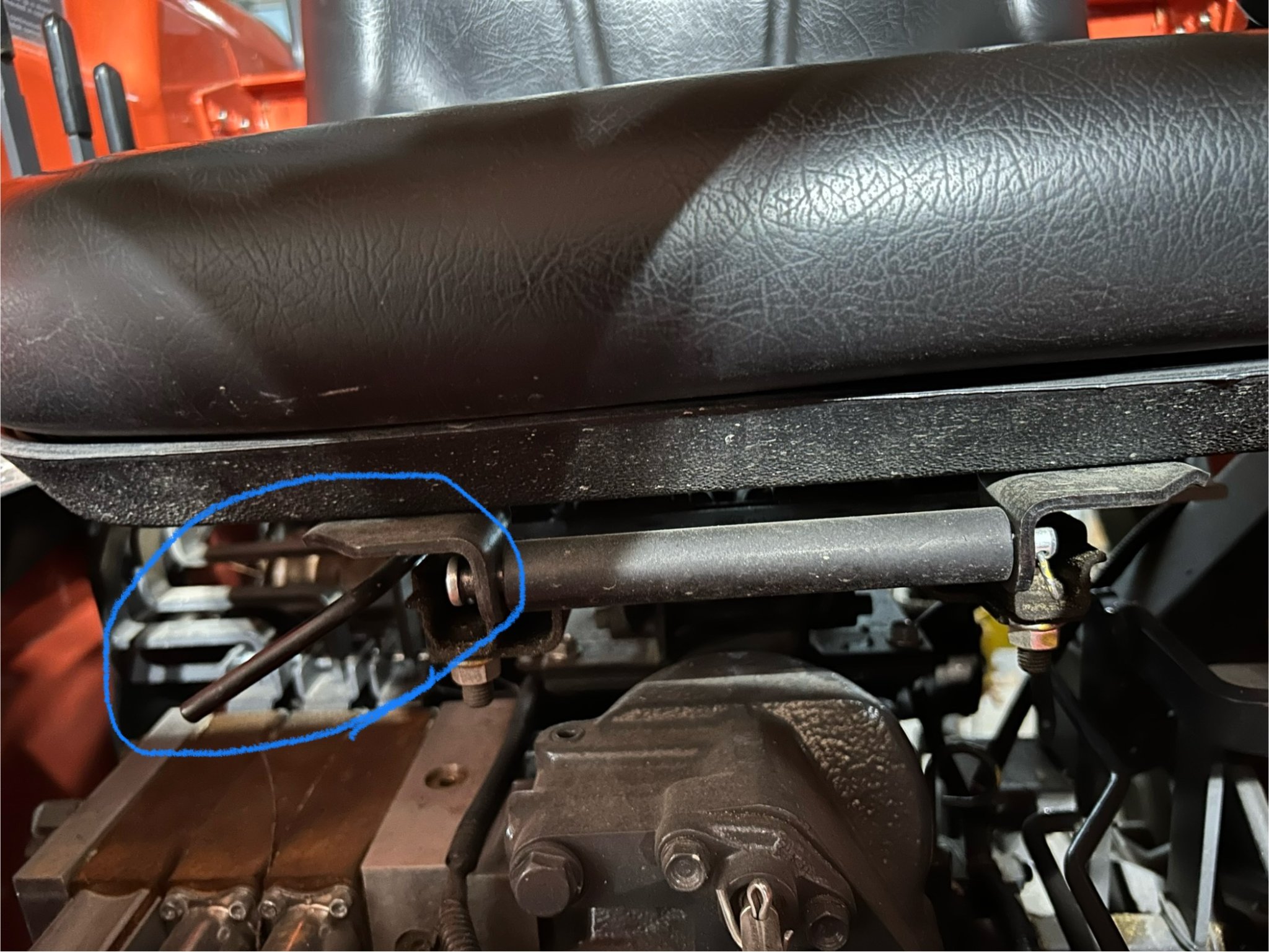

This is a picture of the actual release lever.
Sitting in the seat, reach down just behind and below your right knee to find the lever and rotate it up. Then scoot your butt to slide the seat forward or back.

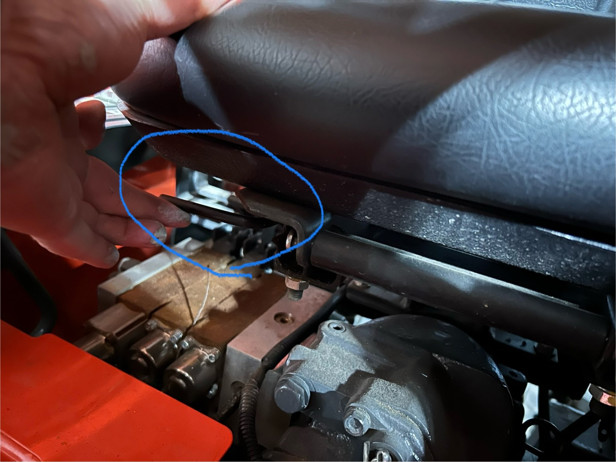

In case that doesn’t all make complete sense, this is how you move the lever to release the seat slide. I couldn’t move the seat and photo it while in the seat because I’m not a contortionist, but here it is anyway.

Unlike some others here, I can’t list off all the tractors that use the LA765 loader. I know the L4701 does because I have one. So, first step: Check what model tractor you have. In the below pic, the loader is a LA765. The tractor is a L4701. So check the hood for the model number. If there’s nothing there, check the badge on the right frame rail just behind the front tire. View attachment 119184
