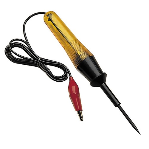

Absolutely agree..... have been a licensed ham since 1986 and also did a stint as a heavy duty mechanic (in British Columbia, wet roads, salt etc) and my pet peeve was newbies who'd test electrical systems by using a pinpoint probe and clipping to ground then piercing the wire to test, we knew damn well that in 6 months time post winter salt covered roads we'd come back and find the entire wire had corroded out due to their stupidity....
