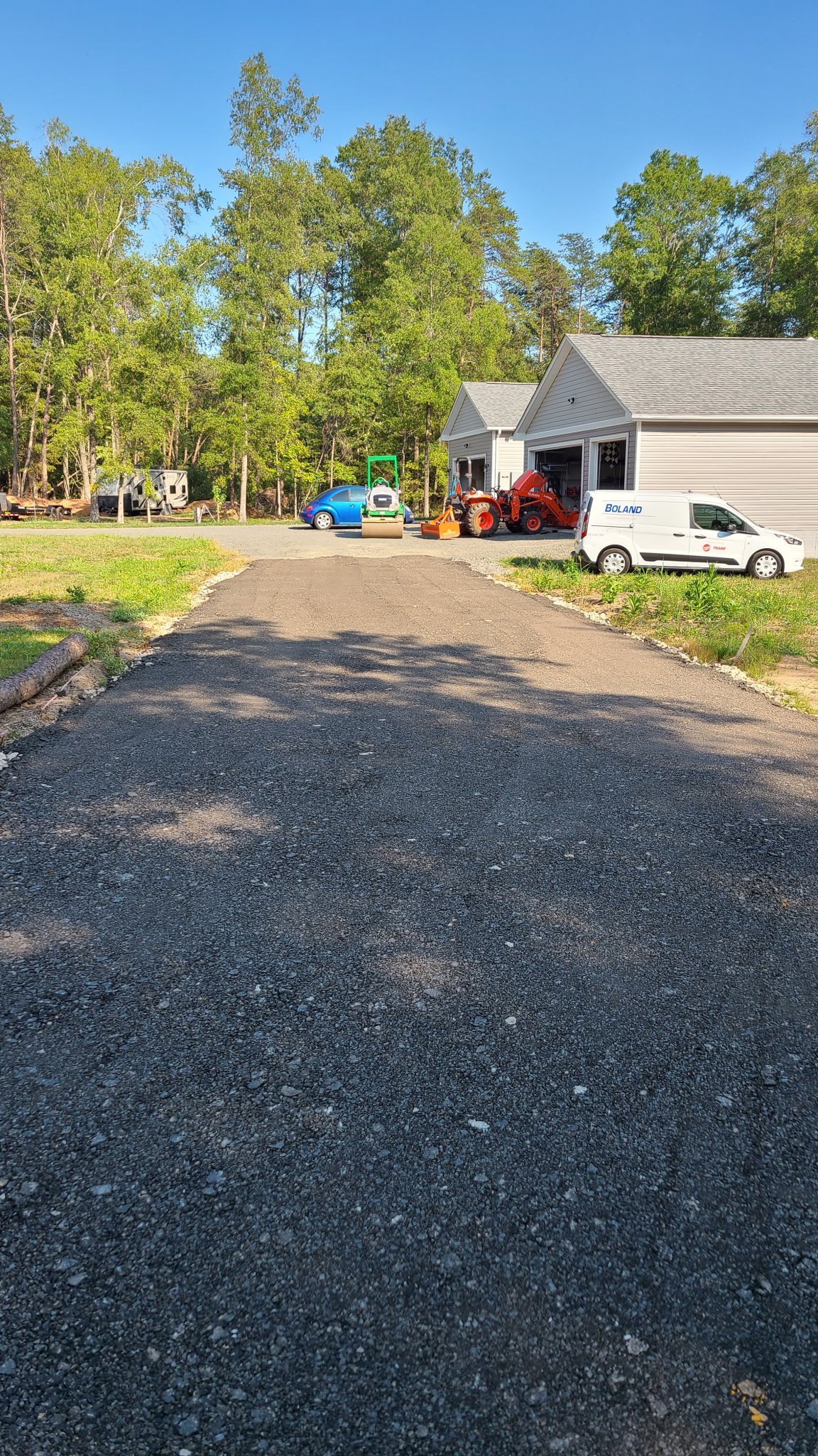

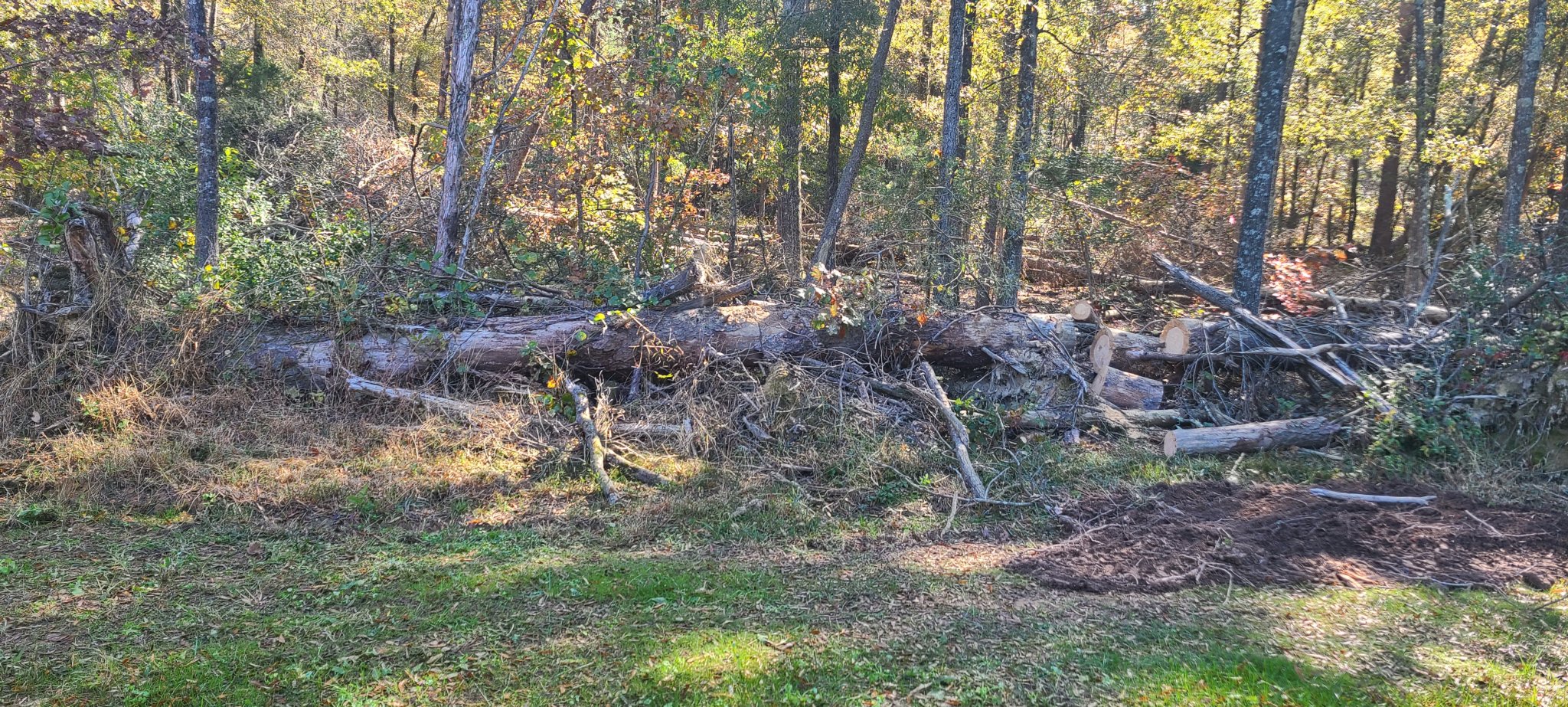

Maybe it's a toss up. To the untrained eye, I don't see a lot of difference in capacities.
I have the 2501 and did a crap ton of clearing and grading with the 1260 and a grapple.
First photo is looking away from the garages. Second is looking towards them.
Went from this
To this
