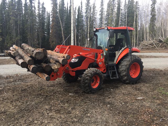

Have had a M7060 for about 6 months now and am really happy with it. I have 54 acers with a runway and some pasture area I am reclaiming from the trees. Something to think about is the weight of a set of grapples and how much of your useful load they will take up when using them. I quite often wish I could lift more when moving brush or trees even with forks which weight far less than a grapple. My 2 cents is to go with as big as you can afford.
