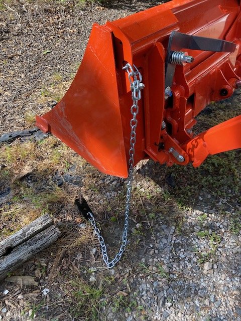

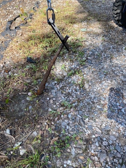

So I had an old bracket left over from my camper tie down install, and the holes are the perfect size for this 1/2 rebar. I took out the 3 exposed pieces, and left the rest until the wife decides how I'm going to fix the edge of the driveway. Took all of 8 seconds each.

Papaj that’s why we have tractors so things only take 8 seconds, I’m sure the wife is happy too as you did not get Impaled.
I know that I would struggle to get half the things done without my tractors and equipment. Best of luck finishing your job.
