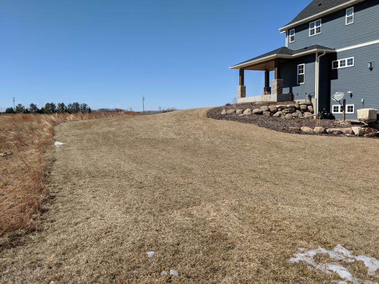

Is there any way to know if my yard/grade would do well with a 60"?
It's mostly flat, but has contours around the home for my walkout basement. If I did it correctly, I attached a photo of my steepest grade change.

I would always go with the 60" if you can. Bigger is mostly better, unless you have very uneven ground. Your ground doesn't look that uneven. My (second hand) BX2350 came with a 54". I had some uneven patches. The mower chews them till they're not so uneven any more, then it's sorted. :) But realistically I think it's true that you're better to modify your lawn than compromise on your tractor. After all, once you have a BX modifying the slope or filling hollows will be easy.
