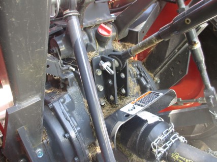

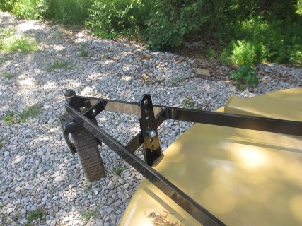

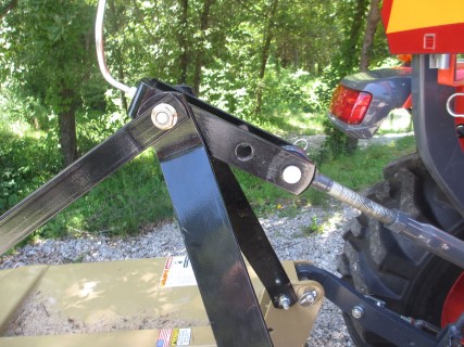

I have a Kubota L3901 tractor and a Landpride RCR1872 bush hog. I'm having trouble setting the cutting height of the mower and still have acceptable clearing height when I lift the mower all the way up(the trailwheel isn't very high off the ground). Here are pictures that show how the pto linkage is set up. Any advice will be appreciated.

3rd picture shows what's wrong. Go back to your mower manual, and see what you did wrong. I think your a brace is too far back, and the bolt(s) are through the wrong hole(s) A-brace should be nearly vertical, the sway link should be mostly behind it, IMHO...
Remove the top bolt, rear strap brace, and toplink, slide A brace forward, put bolt through lowest or middle hole, and put toplink in the other one...:D:D

I agree with Diydave, and Russell, the top link setup looks way off (stretched out too far), and you can increase the height by moving the top link down, and also moving the connections on the lower arms to the outermost holes.

John, you can get the back end of the cutter to come up off the ground more by using the middle position on the back of the tractor for connecting the toplink to the tractor, instead of the top position, as shown in your first picture.
But that does not solve the other issue of why your toplink is fully extended and there's no "slack" to allow the cutter to move over minor hills and dips as you mow.
Looking at several images of Landpride RCR cutters online, it appears to me that the "A brace" Dave mentioned (the bracket assembly where the toplink from the tractor connects to the mower), does lean back from vertical in many of the photos... that must be the way they are designed by Landpride, and it's a bit unique, I think. Most of the cutters I've seen have that "A brace" standing straight vertical, not leaning back slightly toward the rear wheel.
That's not a major deal, but it does mean there's several inches more toplink length needed in order to get that U-shaped bracket to drop slightly while mowing (the "slack"), so the deck will follow the contour of the field. I think a longer toplink would solve the problem. Not too expensive at places like Tractor Supply.

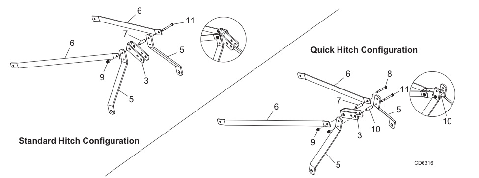

Most cutters have a flexible joint in the top linkage. For use on a quick hitch, you can often just reassemble it so it is behind the A-frame instead of in front.
Below is one example.

Dealer is right, BUT... it looks like your toplink is already loosened about as far as it will go. Make it much longer and it will unscrew completely and fall apart. That's why I suggested you need a longer one.
