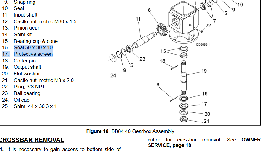

Need to take off the PTO from the gearbox so I can put it on my new gearbox.
Ive been seeing a dozen different ways and I want to confirm the proper way.
Some people are saying the pin that is smooth on one end and threaded on the other can be punched to release the PTO. some people are saying to loosen the slip clutch bolts to take off the PTO.
Thanks for any help
(Woods 72.30 brush hog)
6,694
2,245

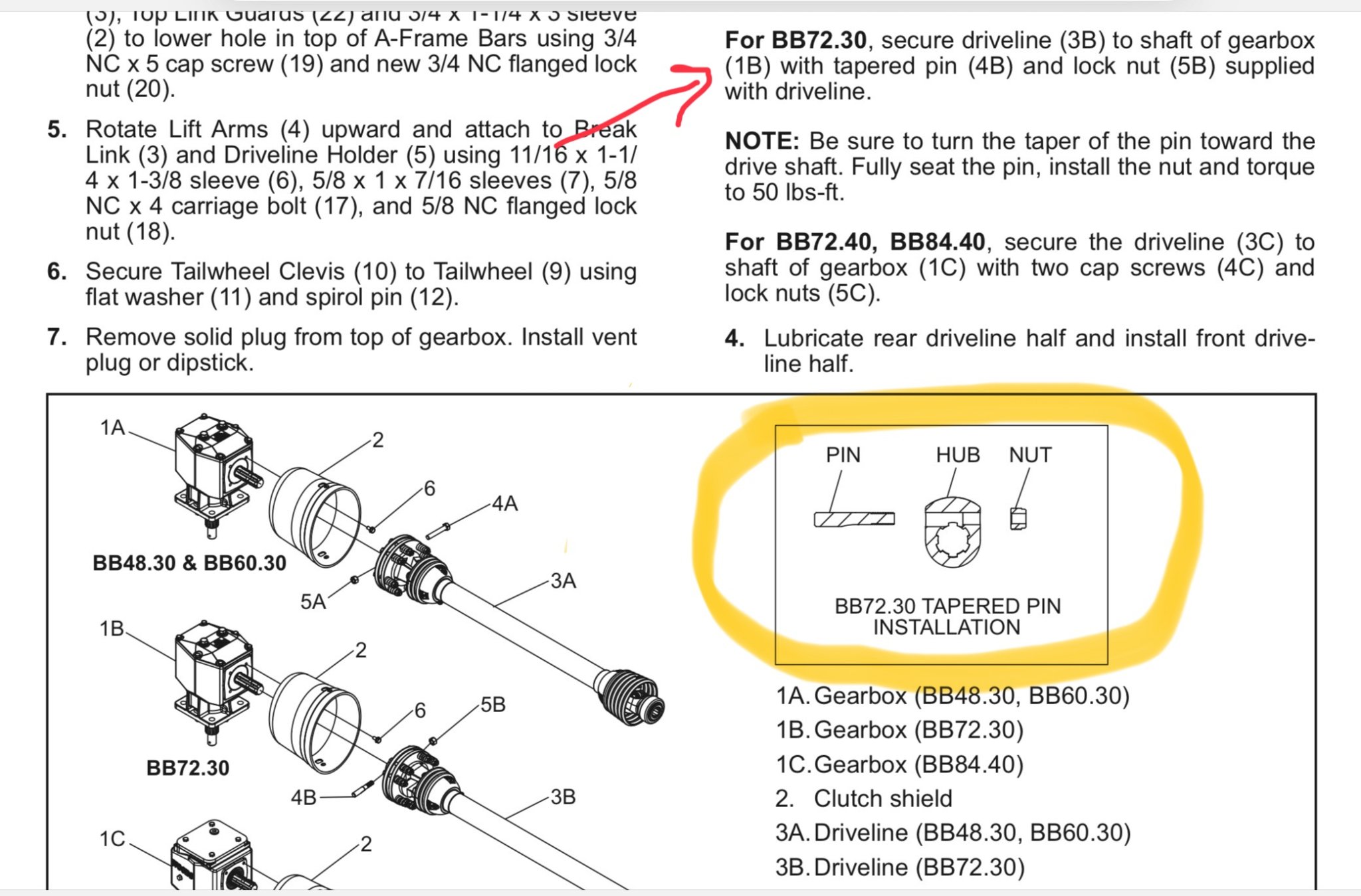

You can download the manual here
It says it is a taper pin with a nut. I think I would leave the nut on the end of the threads to protect them and hit it with a hammer or a punch to drive it out towards the head end.
It says it is a tapeer pin with a nut. I think I would leave the nut on the end of the threads to protect them and hit it with a hammer or a punch to drive it out towards the head end.
thanks man, appreciate it.
ill put the nut back on and punch it out from the smooth side
You may have misunderstood. Just loosen the nut a couple of turns and hit the nut end. Once it starts out, remove the nut and remove the pin out the smooth end side. Leaving the nut on loosely protects it while hammering.

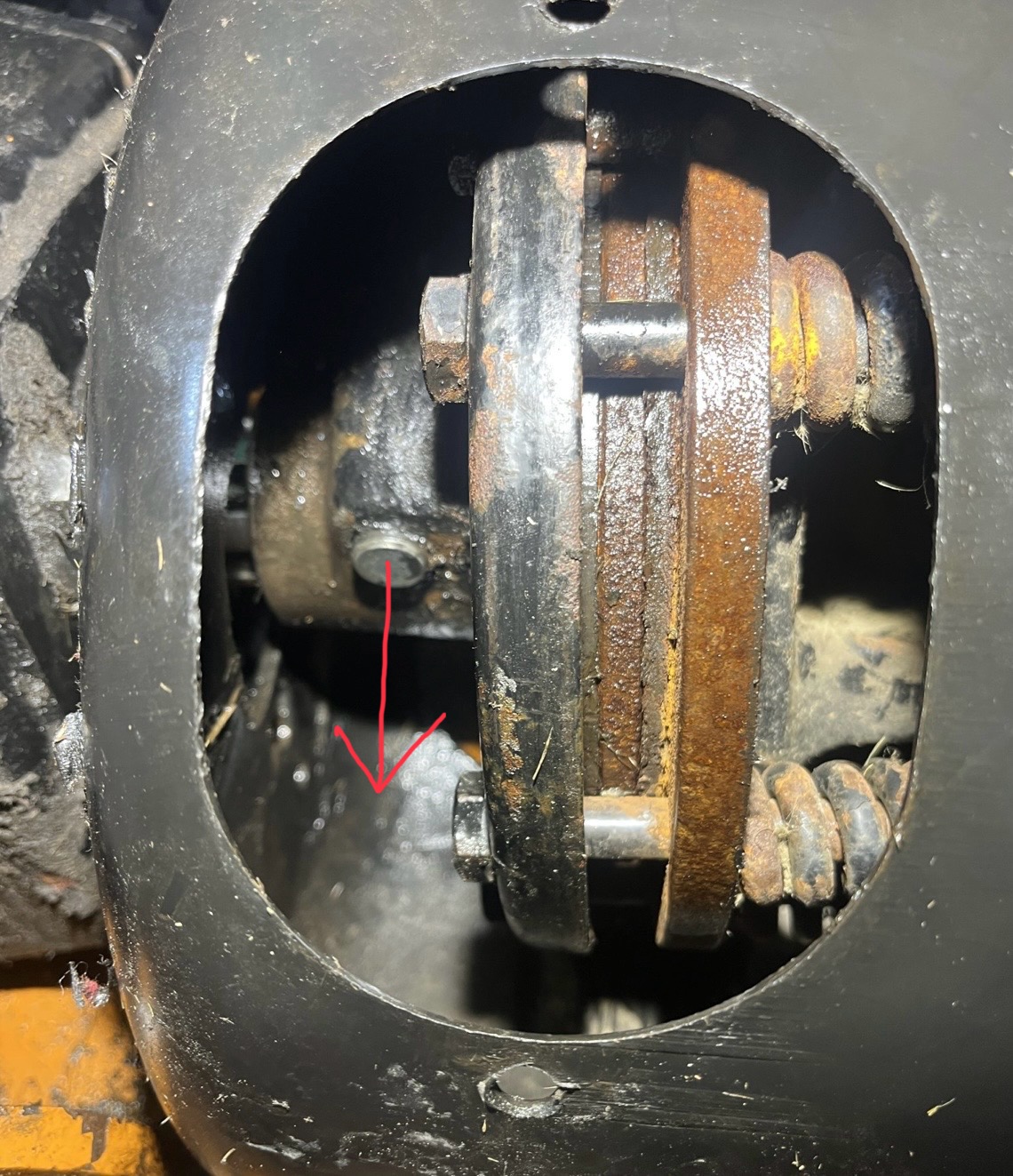

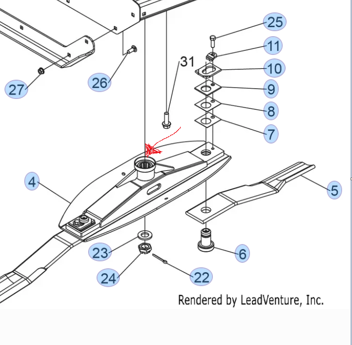

@HowdyAcres
You mis-understood the instructions.
Hit it on the threaded side and drive it out towards the non-threaded side.
Hit here but have the nut on to keep from mushrooming the end. When it moves take the nut off.
The pin needs to move this direction
Sorry to confuse you!
