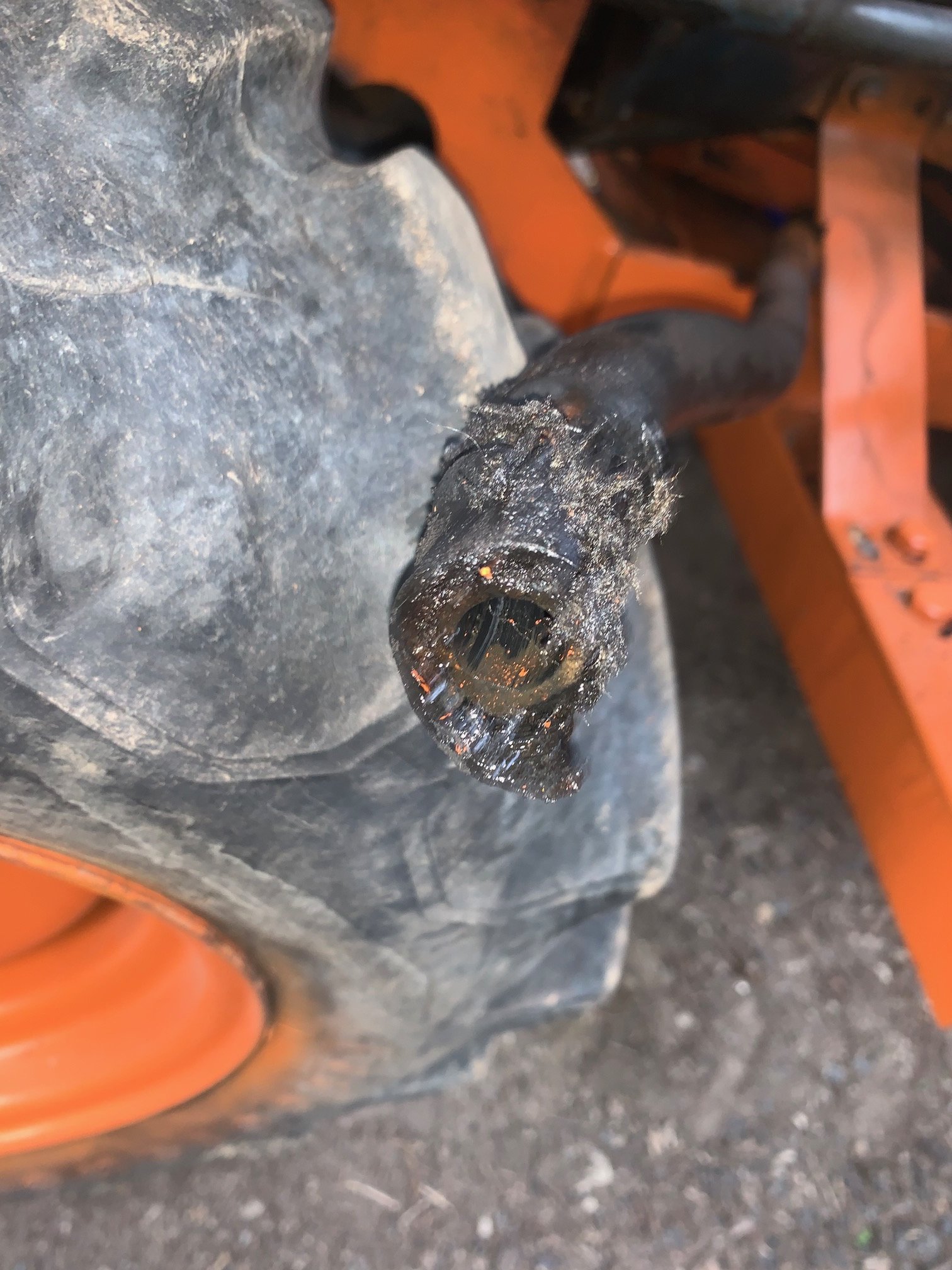

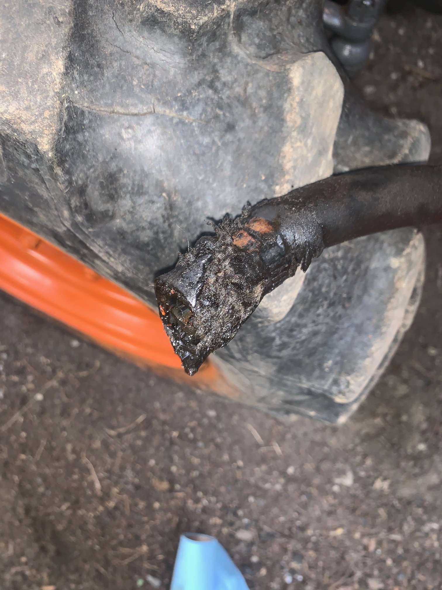

Today I cut off a section from the pump side of the return line from the reservoir as it was chewed/soft/leaking.
Chewed up pump side supply line:

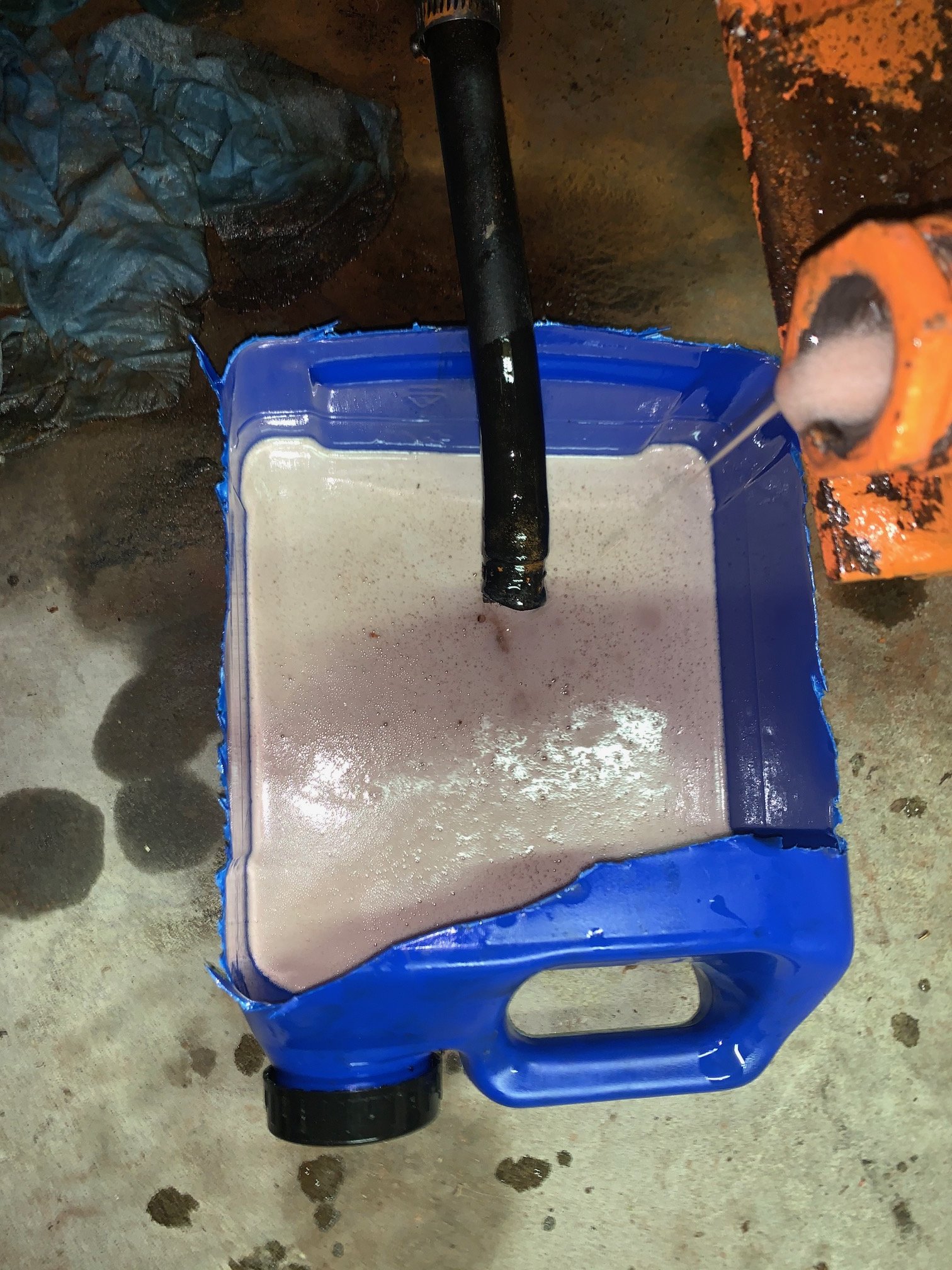

After about 5 mins of running after refilling this is what I see in the fill cap/breather port.
I cycled the loader and bucket quite a bit in hopes of bleeding out any pockets. When drained I had all cylinders extended , drained and retracted to compress and drive out any fluid.
Under lower/moderate RPM it operates smoothly and quiet, but under high RPM it squeels.

Did you replace the entire length of suction line? The remainder can be collapsed and cavitating your pump at higher volume demand.

I have not , I just cut they gnarly end off and reconnected. Tomorrow I will head to NAPA and see If they have a replacement hose for the entire run.
Short of the line itself still being problematic, I guess the only thing left is the pump itself?

Definitely replace it. Do not use heater / coolant hose. Anyone who makes hydraulic hoses should have the suction / low pressure hose you need. NAPA etc.
If you strike out, I'm sure Northeast Hydraulics in Dickson City has it. Monday of course.

I'm guessing sucking air and cavitating. May have sucked some air because of bad suction line and then took the pump out. I don't know how to check that except disassemble pump and inspect or replace. I have seen bad pumps that are cavitating heat up quick, like after two minutes of idling they are getting warm to the touch. If that is so, I would say you need a new pump.

I would say if it doesn't get warm to the touch you probably have a broken pump drive or shaft. They're always moving fluid and will get warm. The only ways for air to get in there and foam the fluid is on the suction side, body seals, cracked body, or shaft seals.

It def gets warm alright. Not so hot that it burns but warm enough you wouldnt want to keep a hold on it for too long. Also I get squealing at full RPM using the loader but if I back off the RPM a little its smooth and quiet.

Replaced the suction line to the pump and used NAPA brand generic hydraulic fluid. Not sure which or both it was but the FEL operates quietly and smoothly now. The viscosity seems thinner and I believe its a 10W fluid, but all operates much much better then it did previously. No foaming out the breather, cavitation or squealing, noises.

(y) (y)It's amazing how much trouble one rotten (literally) little hose can cause.

I believe that hose allowing air to be sucked in was more the issue. It was definitely porous and possibly collapsing.
