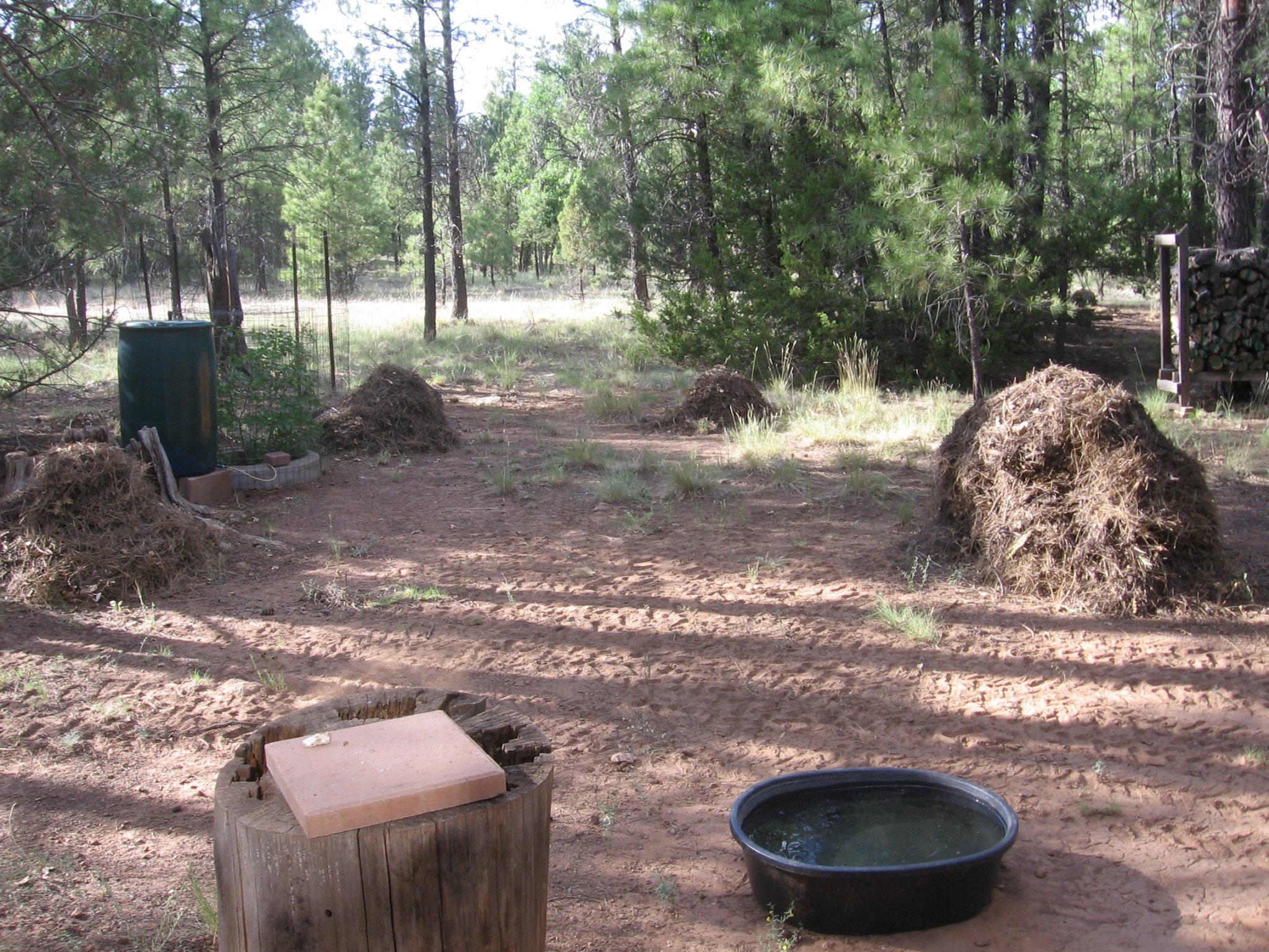

No, the needles really lock together.
I found we can scoop the piles with just the forks, but an assistant with a rake or manure fork can stuff/pack a lot more needles in/on the forks & bucket.

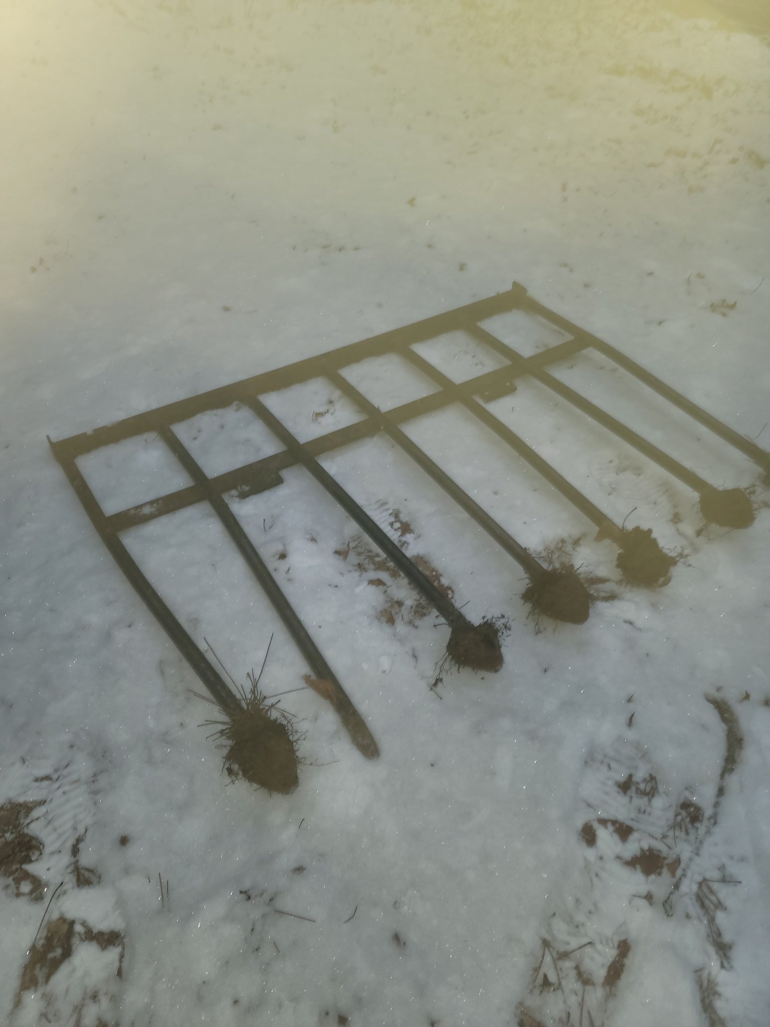

I built this years ago after I built the loader for the Case 446. Needed something to clean waste hay out of the winter goat pen.
3/4" bar stock with the ends cut at a bevel, welded to a piece of strap to keep them spaced properly. Back end is 1/2" by 1" bar stock with angle brackets bolted to holes in the sides of the bucket. A couple pieces of angle bent over the front edge of the bucket to keep it in place.
Works awesome for cleaning up waste hay, downed branches in a pile. Would think it would work for pine needles.
Sorry about the dirt clods stuck to the ends of the spears.
Mike
