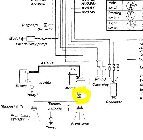

Today I pulled my glows as I continue to work through the electrical issues to get the glow system up to snuff. I found a larger wire with a huge female spade running between the valve cover and the water inlet radiator hose connection and for the life of me, I see no male spade to connect to - it definitely looks OEM vs a wired in add on - what could this be?

I looked at the wiring diagram and have marked the largest diameter wire with a green arrow.
It is the main power from the starter/battery terminal to the key switch .
If the wire is solid red then this is it.
If it is black with a red stripe then it supplies the glow plugs.

Bet you look at the end of the plug it's not a spade yet it's where two round connection go into, specifically two headlight wires.

Could be as headlights are non op! I will look close and at this point will most likely need to pull engine shroud to revealwhat I hope will be a couple of dangling leads from headlights
12,964
5,688
my guess... headlight power...
it looks like it's Brown in colour, has a cover over the 'splitter' where 2 males join the female,and kind dangling near the 'bonnet'. Also the wiring diagram shows it !
Great! I wonder where the headlight harness (male) ends are hiding? Do they drop down and pop out on the exhaust side of the engine or the air cleaner side? Hopefully, I will find them tucked up somewhere - flashlight time
