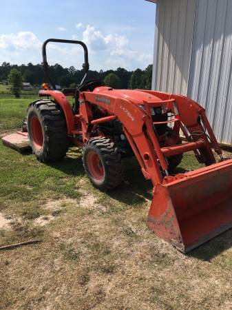

Good day orange tractor talk, i would like to introduce to you my new to me Kubota 2012 L4600DT.
I bought Katie the Kubota tractor a couple of weeks ago and started the cleaning, servicing, and adding features that I felt were needed.
She was owned by a young man that thought it better to have a new truck than her. She had 178 hours on her and had been looked after well just not many baths so that was first priority.
To date:
- Changed oil and air filter
- Washed and waxed- 3 days
- Added tool box to replace tiny one that came on it
- Added hooks to FEL
- Made floor mat from an old anti fatigue mat
- Install clevis hook on draw bar
- Installed two bolts to prevent ROP from rattling
I am currently building a box from lexan to store chain in.
I am a little OCD, so each tool that goes in the tool box has orange electrical tape wrapped around it so I will know what should be in the box. See a tool on the work bench with tape know it is out of place....
I'll post more pics as the process develops.
Thanks for looking.

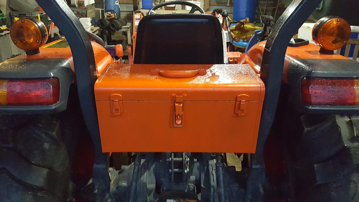

Congrats... nice machine. Could I see a picture of the toolbox box as I am looking to replace the tiny so called 'toolbox' on m new L3901?
EZ
Thank you, I will take a pic of it and post. I removed the "tiny" one and made a bracket that would support the new tool box and then mounted bracket and box in place of the old one. It is a Kennedy tool box I had that was not being used.
EZ

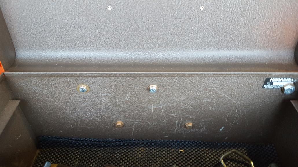

Here it is, after work I can take pics of the inside and bracket as to how it is mounted.

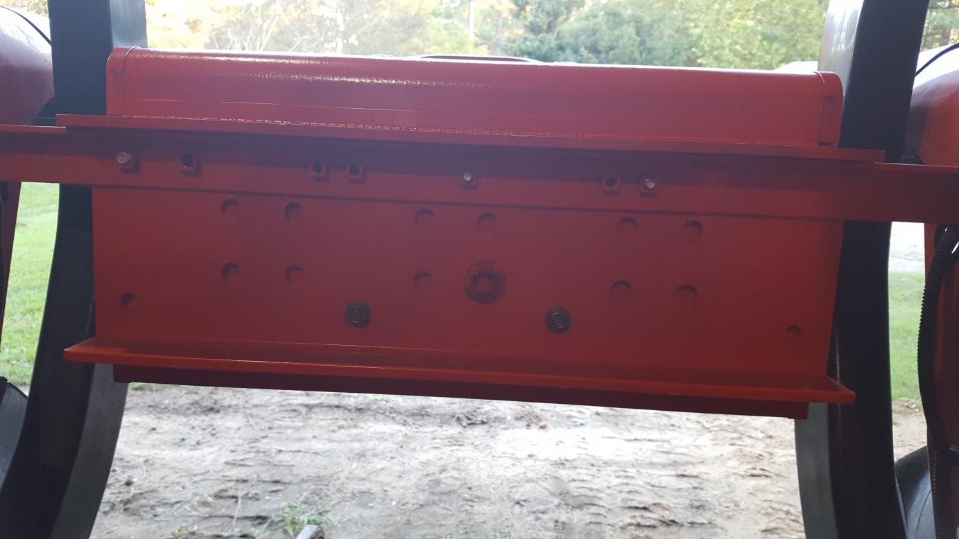

Here is how I mounted it, the bracket is a piece of fiberglass material that was scrap at work that holes were already drilled in it, I had to add required holes. The threads are 8mm and one 10mm that were in the angle already used for the tiny tool box.
I chose the material because it was light weight and spanned nearly the full depth of the box to provide support. I removed the tools from it for the picture but full of misc. items it still is rigid feeling. My 30 pound daughter has sat on it!
Hope this helps and be glad to asnwer more questions or provide more pics.
