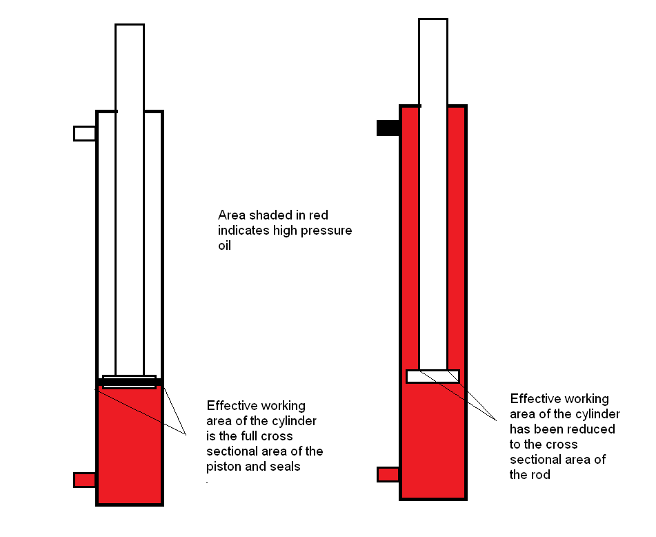

It'd be interesting if someone would remove their seals from their cylinders and see what happens.
It has been done in the hydraulics 101 class at the Technical College where I took some classes.
The cylinder extends just as it did with the seals on the piston.
Now retracting or down pressure is another story.
13,298
7,492
I think you left something important out.
With the seals removed it will only extend with one of the two ports plugged. And even then with reduced force.
It basically becomes a displacement type single acting cylinder with reduced piston area.

In the case of the master cylinder on my Willys (same as forklifts and a zillion other vehicles...), in the right drawing the upper left black port actually goes to the reservoir,or so I was told. 'somehow' the oil went 'round and round and no brakes.constant pressure on pedal.it went to the floor yet NO leaks. This was back in '75 or '76, so ,yeesh, 1/2 a century ago.....when i was 21,sigh
On your Willys the master cylinder is a pump that operates just like a bicycle tire pump. On that vintage they typically have a cup seal on the brake rod that pushes oil out to the brake cylinders creating the pressure needed to actuate and maintain the brakes. Just like the bicycle pump pushes air into a tire.
In your case the cup seal was probably defective and not capable of holding the pressure built up on inward stroke. So oil leaks backwards past the seal into the intake port (reservoir).bleedimg off tje pressure. By rapidly pumping the brake pedal you repeatedly build enough pressure to actuate the brakes but it bleeds off quickly.
