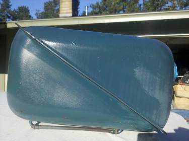

Hi All,
Been lurking for a month - first post.
I picked up a can of Night Tide from Walmart (Home Depot also have it) and while its a very nice color, I found it significantly 'bluer' than the oem chassis blue-grey on my B6200 project. Great for a complete repaint, but not realy suitable for spot painting.
Ace hardware stores carry tintable bases in their Rust Stop Oil based Enamels. I had them mix up a batch of a color called 'Bonapart', code D39-7 and tested it on the gas tank. Honestly, I cant tell it from the original color and at $12/qt ($30/gal) its reasonably priced, I generally find coverage of a can is 2-3x a rattle can per oz.
Being impatient and wanting to see just how close a match it was, I painted half the gas tank and it seems to be a good enough color match to spot paint. I completely messed it up by painting just before the sun went down and the dew played havoc with the paint before it dried, but attached is a picture. The top half is painted Bonapart and just below the seam is the original paint (the dull triangular patch below that is overspray)
