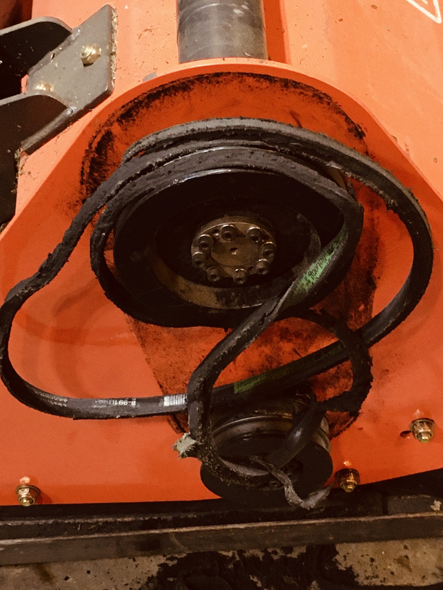

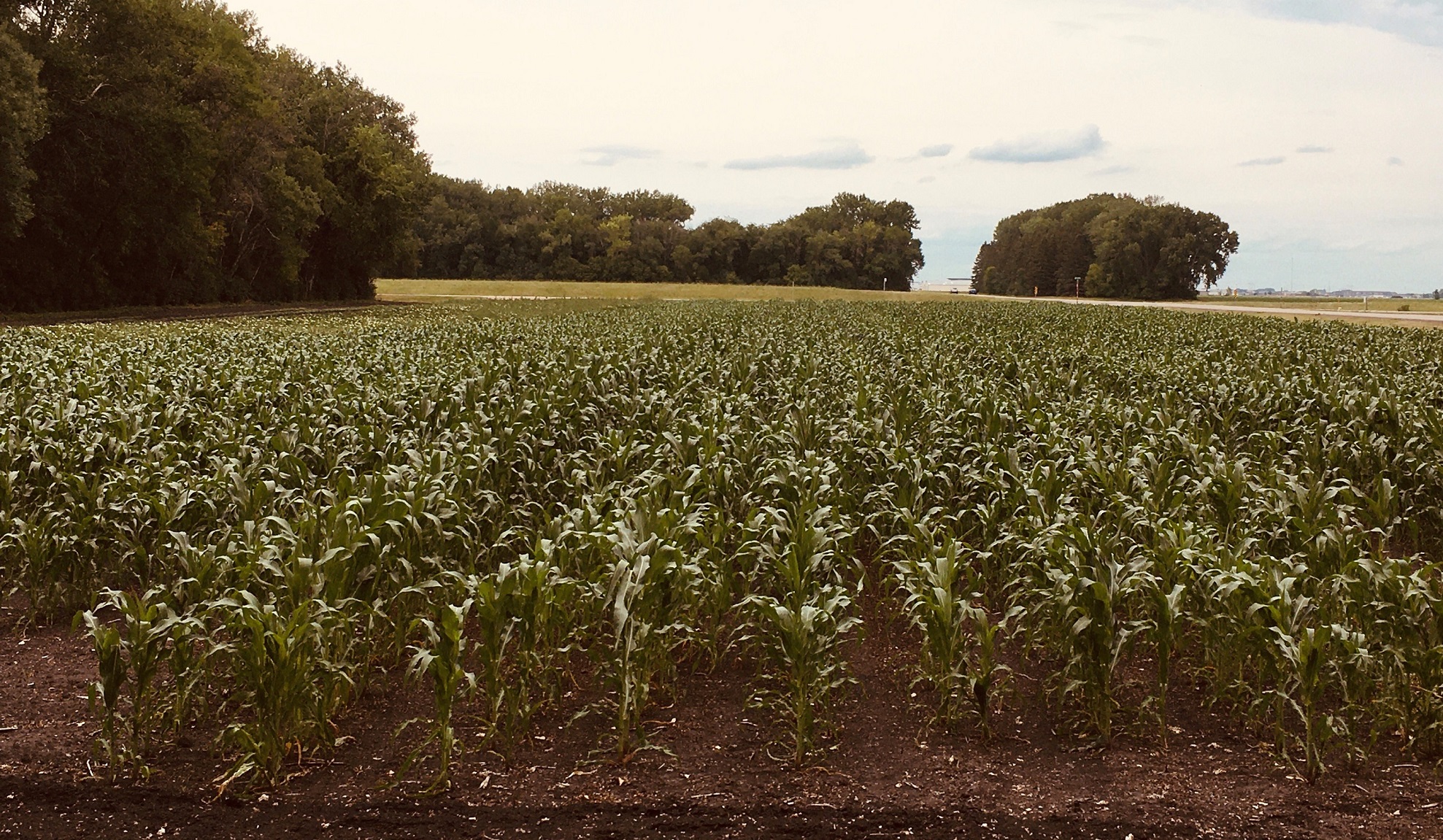

Fast forward to this year: I was anxious to see how the flail would work in the sweet corn patch because getting rid of the corn stalk residue is a tough job. Picking out a couple of rows, the Kubota plunged in and looking behind at the mulched residue revealed it being converted to a finely chopped up mess. WooHoo!
Fresh cut hay is quite the nice farm fresh smell but nothing compares to the sweet aroma of freshly minced “supersweet” sweet corn sileage! It makes you want to stop and have a “sit down all day” picnic out there. That is until the smell of burnt rubber gets added to the aroma! OH, OH!
SweetCorn Patch.JPG Flail Mowing Sweet Corn.jpg Flail Corn Results.jpg Flail Belt Issues.jpg Flail Belts.jpg

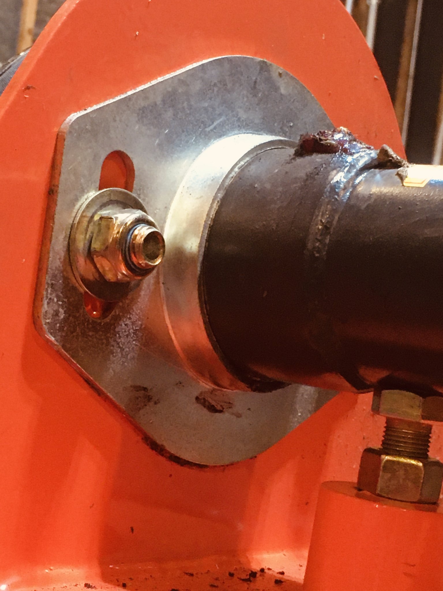

Per the manual, I had neglected to check and retighten the belts after the first 20 hours of operation. “Loose belts are prone to slipping. Slipping belts wear out quickly. They also may overheat and can disintegrate during heavy use.” (My test run proved all to be true!) 🤣 I’m guessing the belts had previously stretched enough and the thick corn stalks caused them to start slipping. In no time the belts were toast. It was completely operator error on my part.

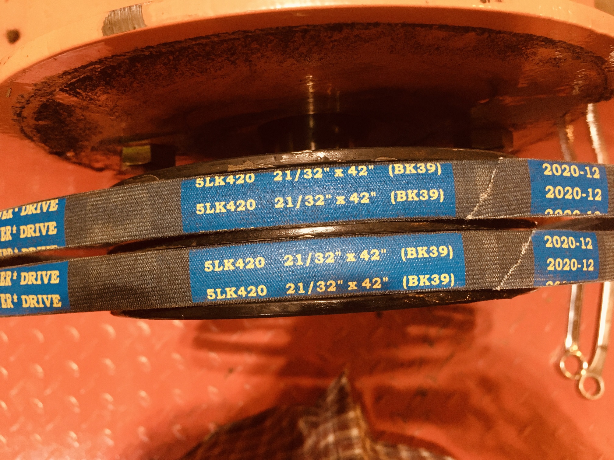

The belts supplied were metric. Using one internet table, they crossed to an inch size that I ordered in reinforced Kevlar. The belts arrived and were much too short.
I had failed to see that the metric belt length was measured at the inside circumference whereas the internet cross reference table stated (in very small print) the new belt length was measured at the belt’s OC (On Center). Now doing the proper math, that translated to an additional 3 inches needed compared to the belts ordered. A new longer set of Kevlar reinforced belts were ordered and would hopefully be a proper fit.

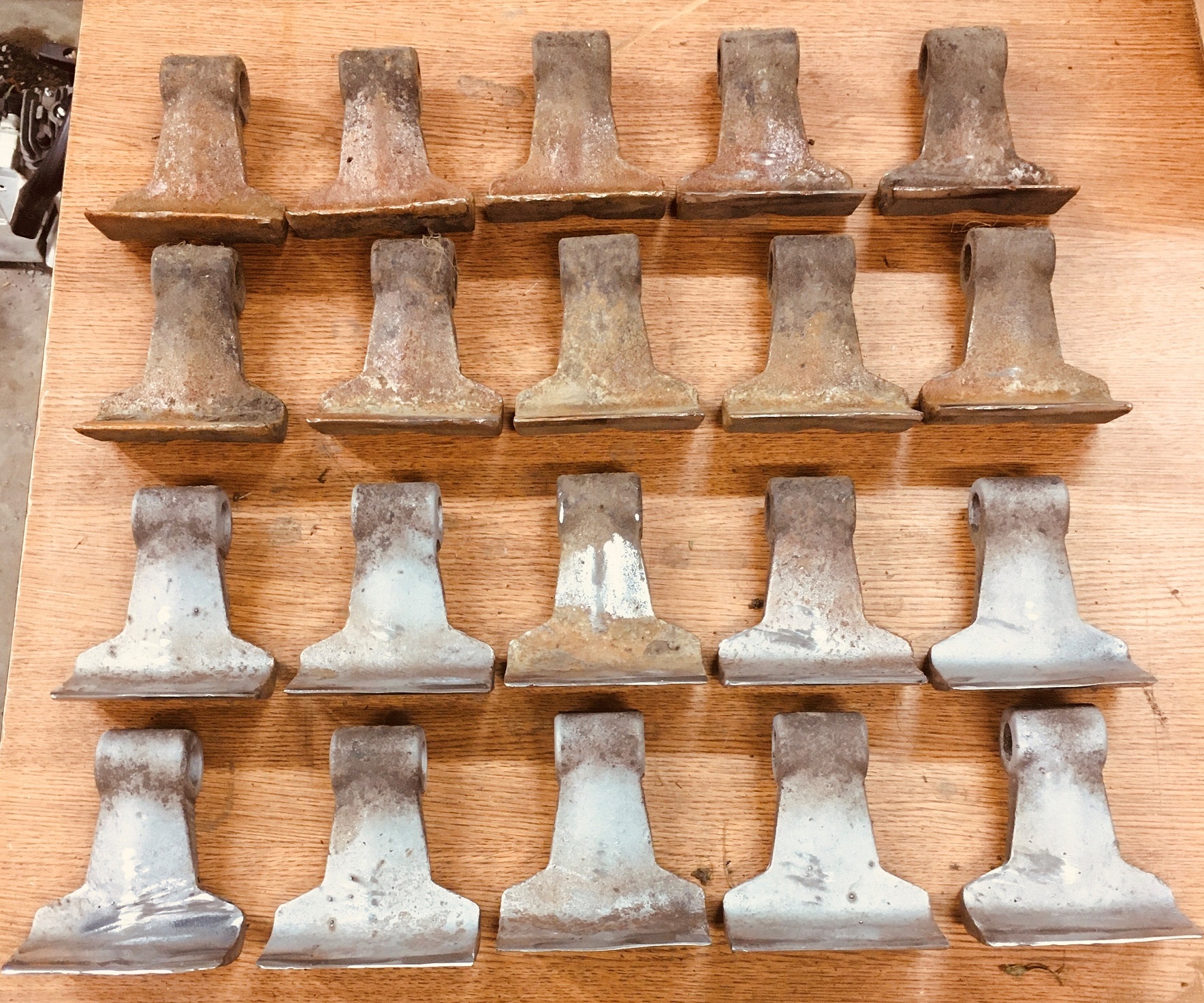

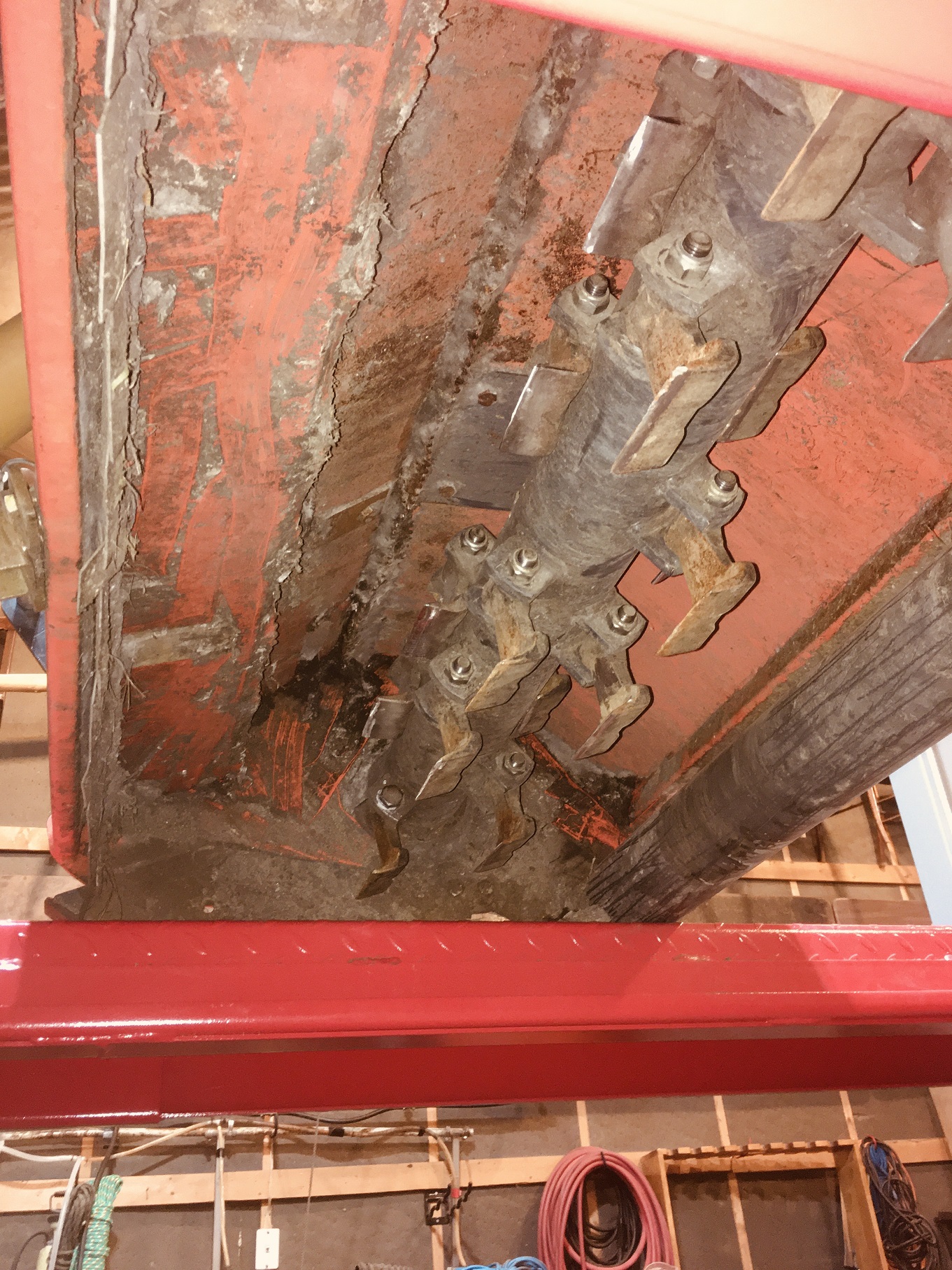

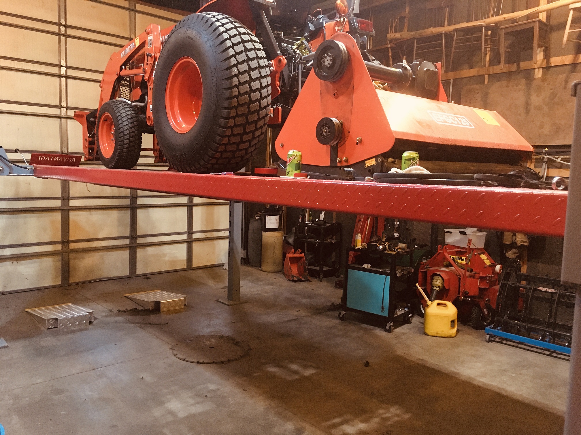

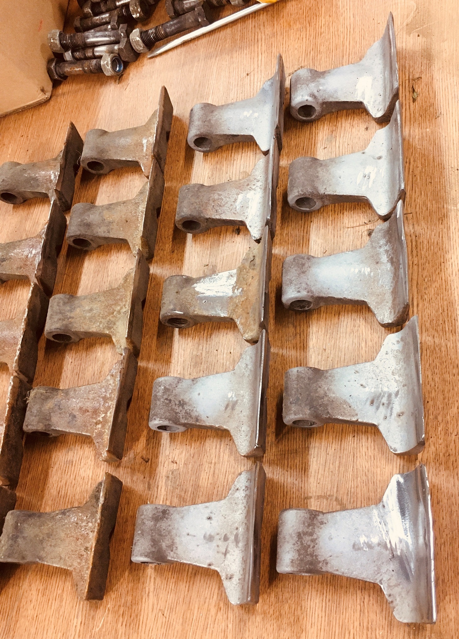

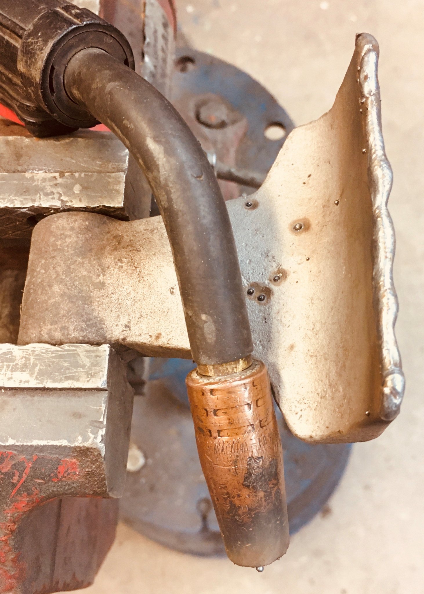

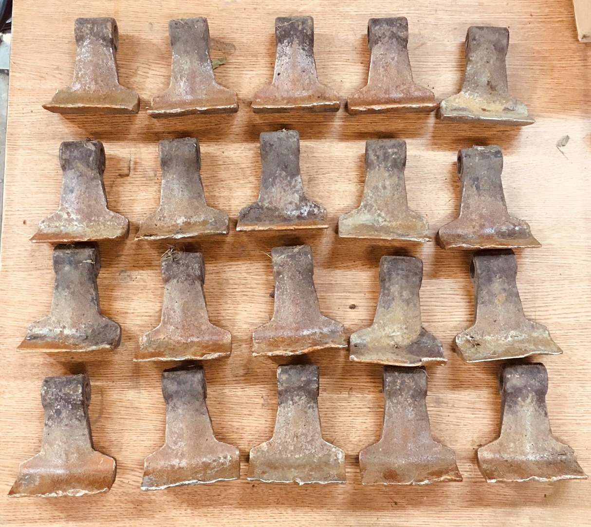

Waiting for the new belt’s arrival, I put the tractor/flail on the lift to inspect the hammers and noticed that half of them had some nicks and bent edges. (from prior trail blazing) Nothing real serious but they could use a little TLC. Since they’re made of cast steel, the dents were gently hammered out and the edges built up using the mig welder. Those edges then ground and shaped to match the originals. We’ll see how they hold up.
Flail on the Lift.jpg Rock Damaged Hammers.JPG Repairing Hammer Blades.JPG Repaired Hammers.jpg Side View.jpg

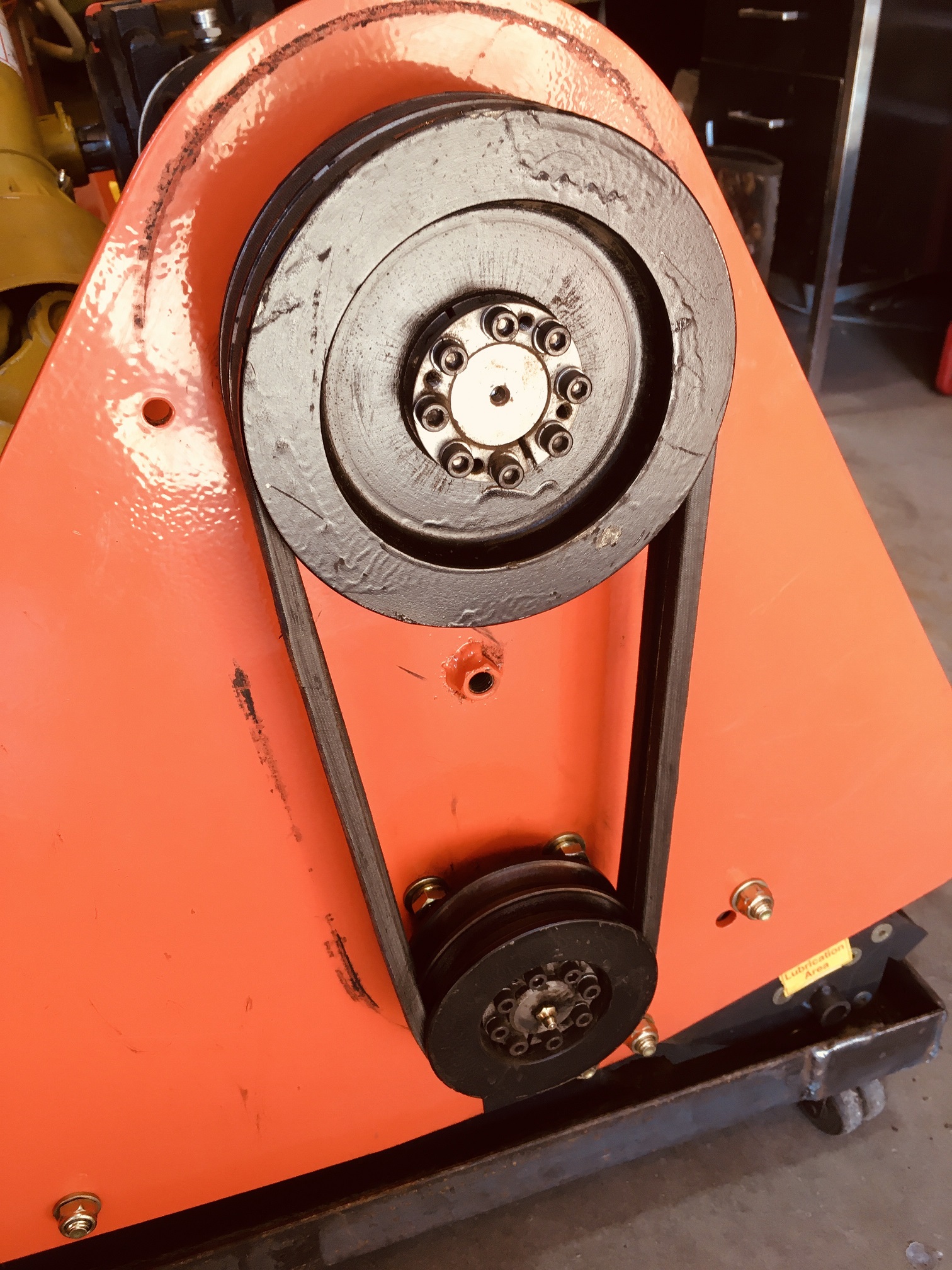

The new belts arrived and fit perfectly. The repaired hammers reinstalled. Some new 3.5 inch hammers were also purchased off of Ebay to have on hand when/if the repaired ones fail or if the flail locates some more hidden rocks.
Working Under Lift.jpg Re installing Hammers.jpg Belts In Place.JPG IMG_E6229.JPG
Both belts (original and new replacements) are “B” series cross section.
The original belts: B-991Li (991 mm inside circumference length)
New Kevlar belts: D&D PowerDrive MXV5-420 made with Kevlar V Belt (42” OC) With the tension adjustment bolts on both ends of the driveshaft loose and the shaft lowered....the new belts easily rolled into position on the drive pulleys. The above pic shows plenty of future adjustment for additional belt tensioning when needed.

Tractor lift.
Wow!
Hi Pawnee! Here's a link to how I ended up with the lift: (2) Better Late Than Never……. Kubota Lift | OrangeTractorTalks - Everything Kubota
I couldn't be happier with it. It ranks right up there with buying the Kubota tractor! And they aren't that expensive....but they do require room. The price has jumped about $1K since purchased last april but still, it's about like buying an implement for the tractor. And it can be used on your car, truck, tractor, mowers, UTVs, etc. And this one can be easily moved around.

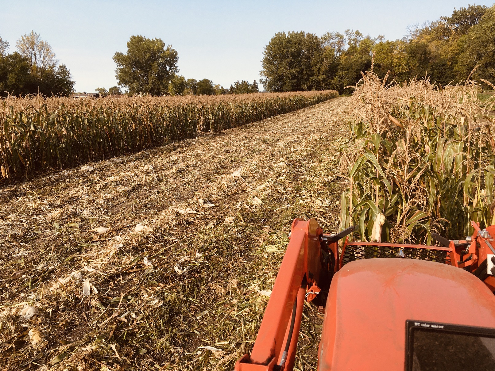

Here's an update on the new belts installed in the flail and how they held up during the final flail mowing of the corn patch:
I finished mowing the corn patch a few days ago. No burning rubber odor mixed in with the fresh silage smell this time. It still appeared to be a substantial load on the gear box (or maybe just the sustained load on it) as the gear box and drive line were quite warm after finishing up. Too warm to keep the hand on it for very long. But it had just chopped a little over 2 acres of corn stalks!
Inspecting the belts showed them to be no worse for the wear. Instead of the 1/4 inch deflection when first installed, they had now stretched to allow about 1 1/2 inches of deflection.
That didn't seem to be real loose but they were tightened back up to about 1/4 inch deflection again. It'll be interesting to see if they continue to stretch with use or will now be stable after the latest adjustment.
The flail mower sure did a nice job on shredding the corn stalks into a finely chopped up residue. Next I'll hit the field with the roto tiller and get that residue mixed in with the soil to deteriorate even faster.
