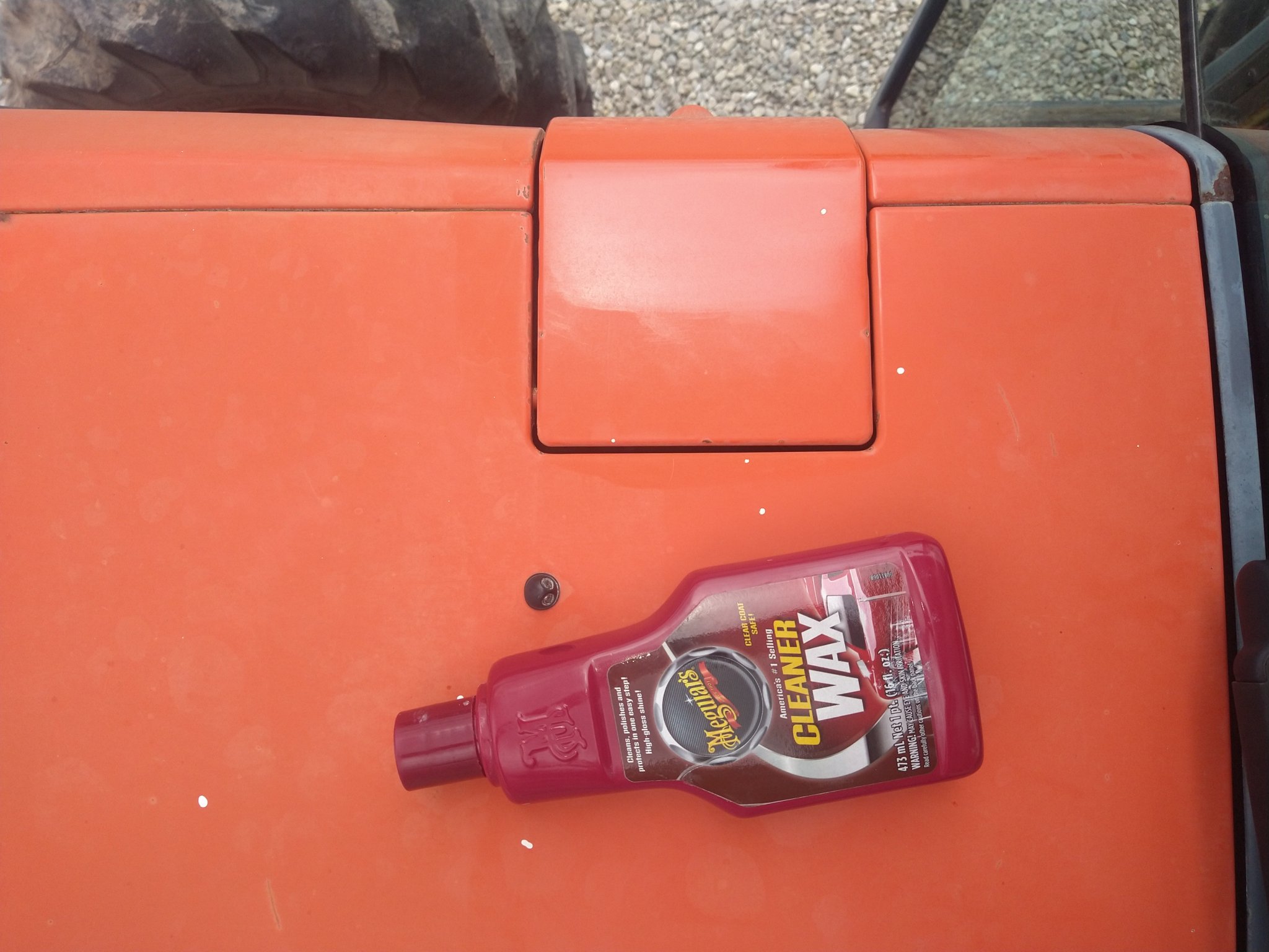

I think paint should be shiny, and I used to simonize/clean cars when I was a teenager … so, I wanted to see if I could save this 20 year old faded ugly paint! Yup, there is hope for this old tractor, I did half of the fuel flap!
Since I was almost out of wax I ordered more, plus some rubbing compound … I had forgotten that I had previously bought another bottle of cleaner wax, but put it in the old box of the good wax because it had a nice storage spot for the applicators pad …

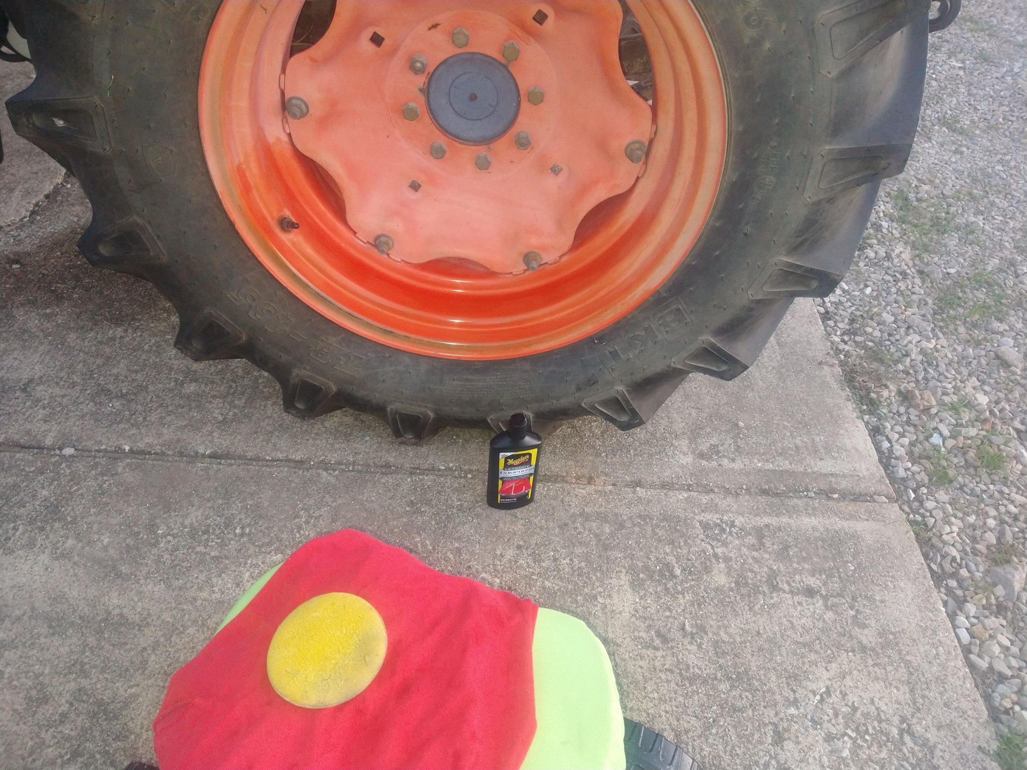

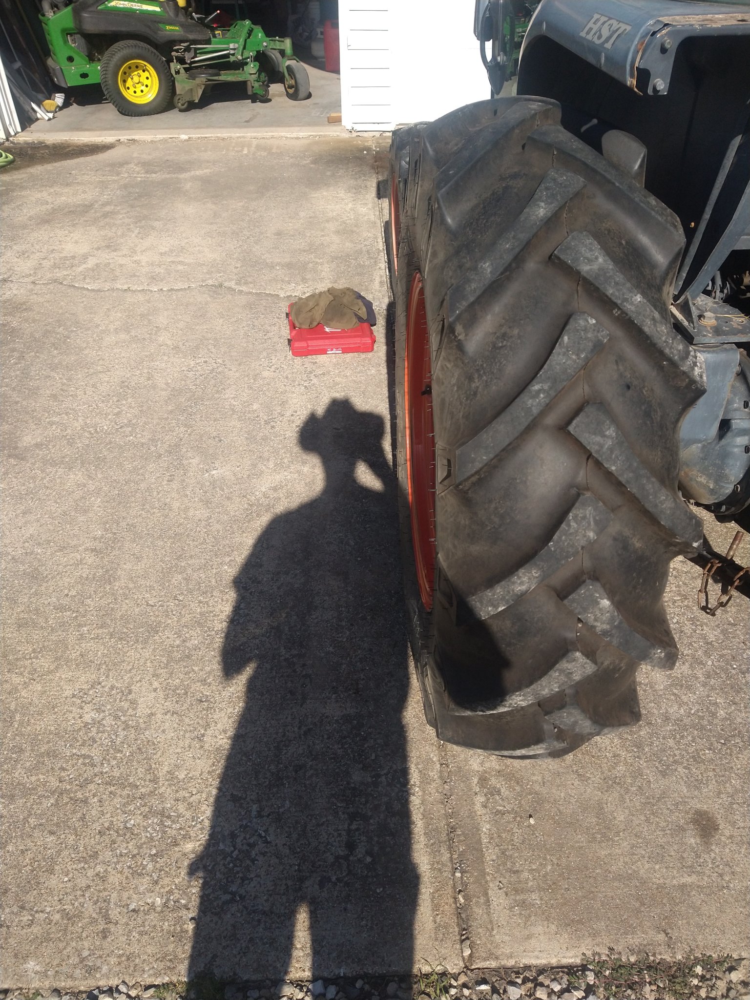

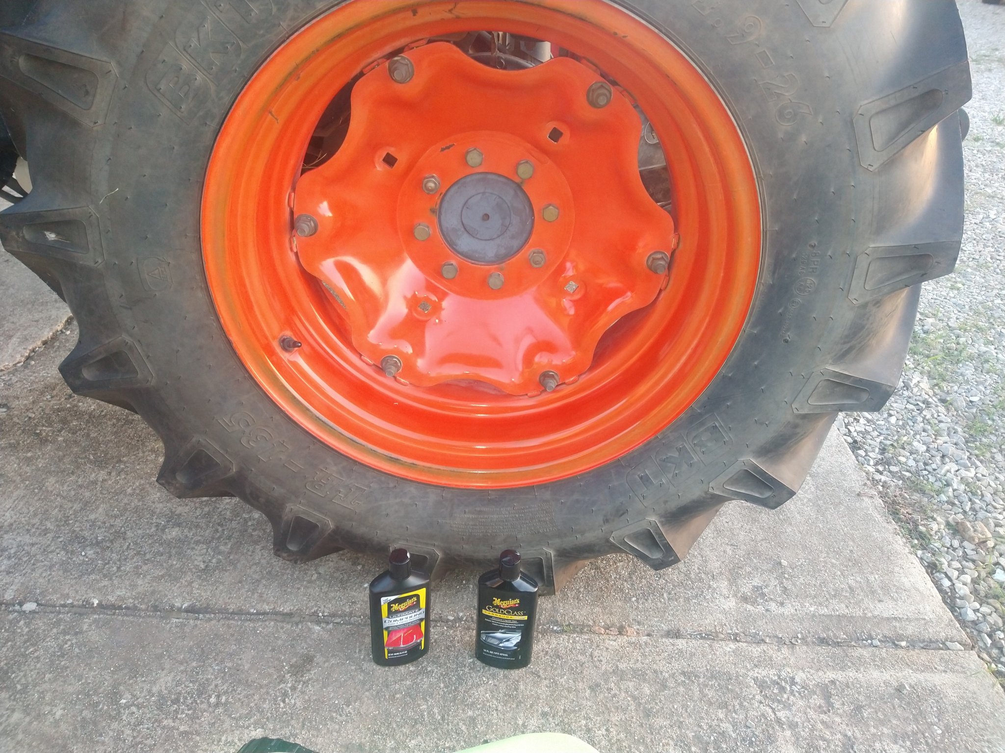

I got home again this morning for the day … I wanted to widen the rear wheel track width … I figured part of the process was switching sides, since I had already washed and scrubbed it last Sunday, I wanted to clean up the wheels before the outside became the inside…
Quite a drastic difference!

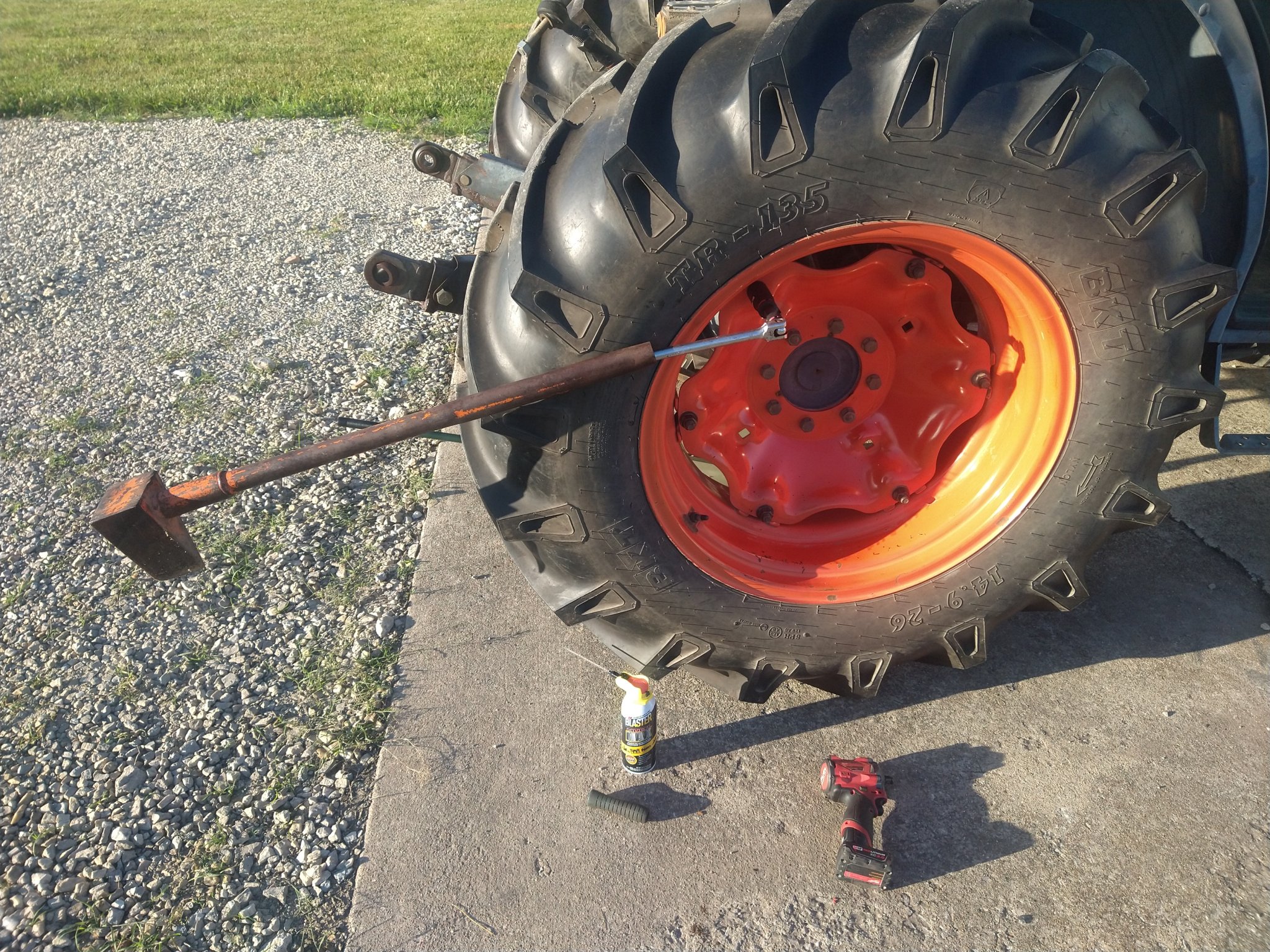

I did have a little trouble getting a few of the nuts off, my 250 ft lb impact wrench wouldn't budge a few of them … Monster Maul to the Rescue!
But it appears that the rings are centered in the wheel, so I didn't switch sides, or clean the insides!… so now they are as wide as they go … I gained 4.25”

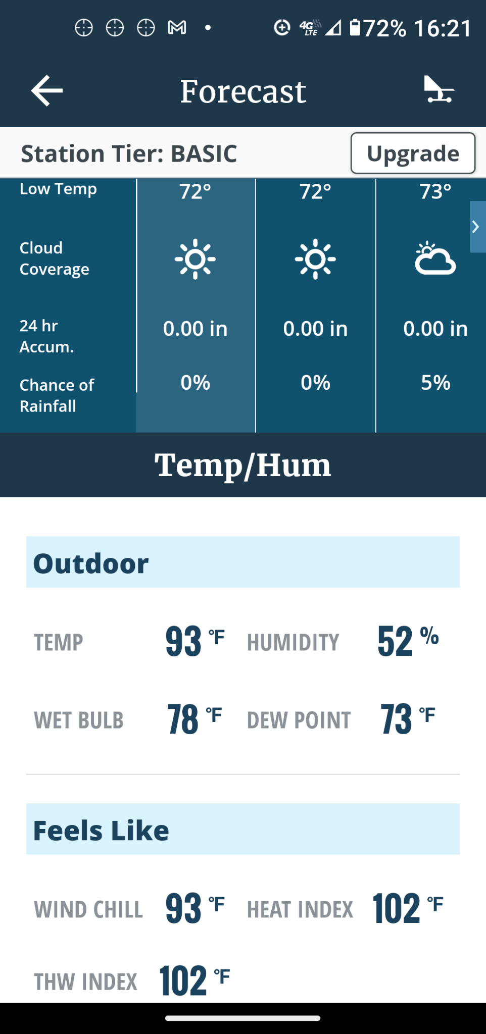

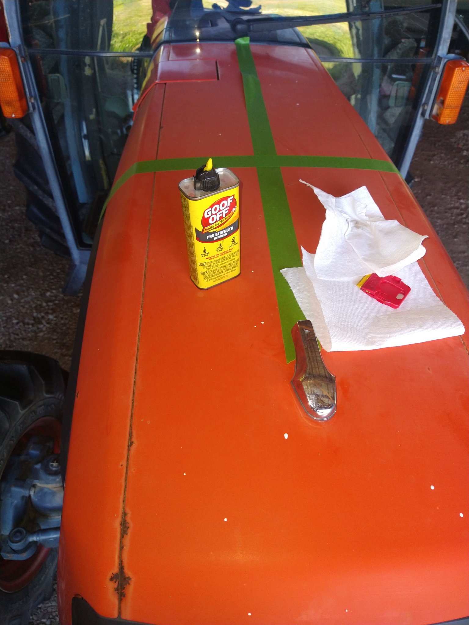

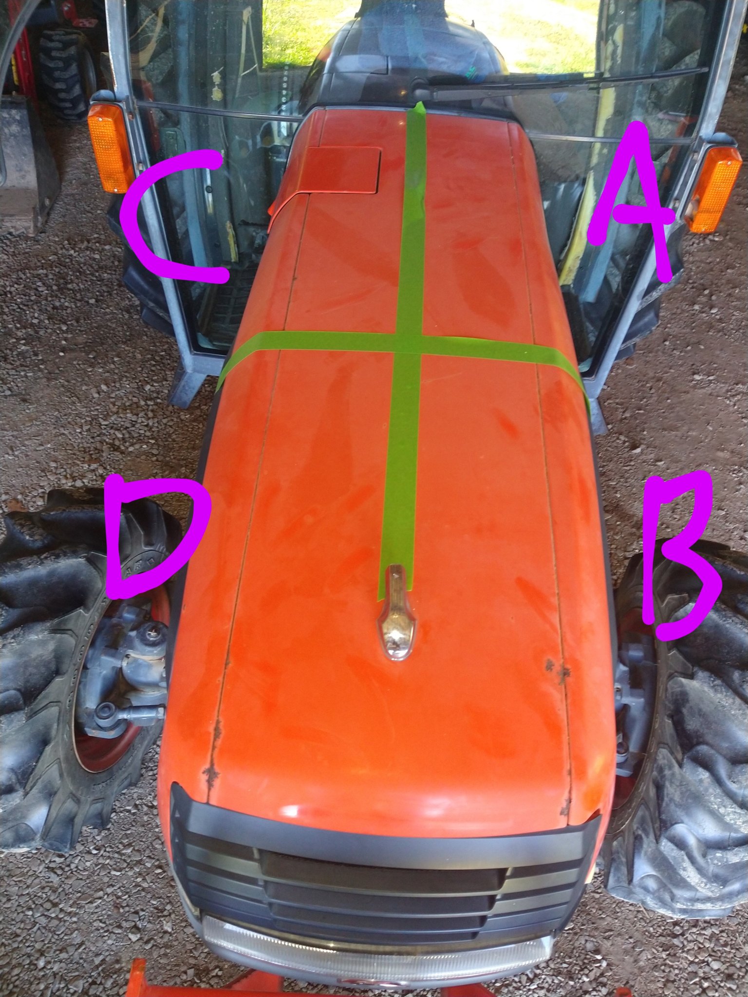

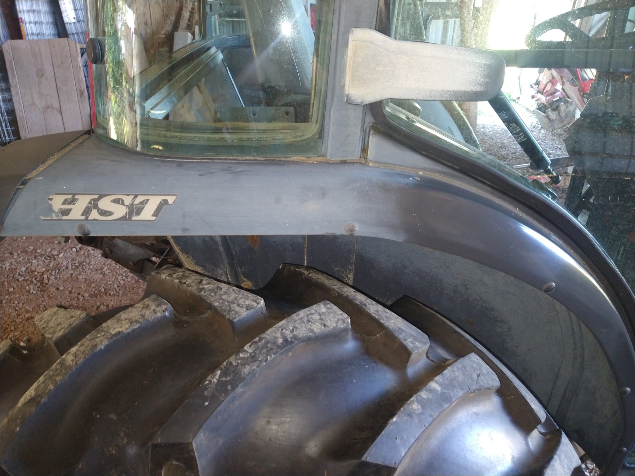

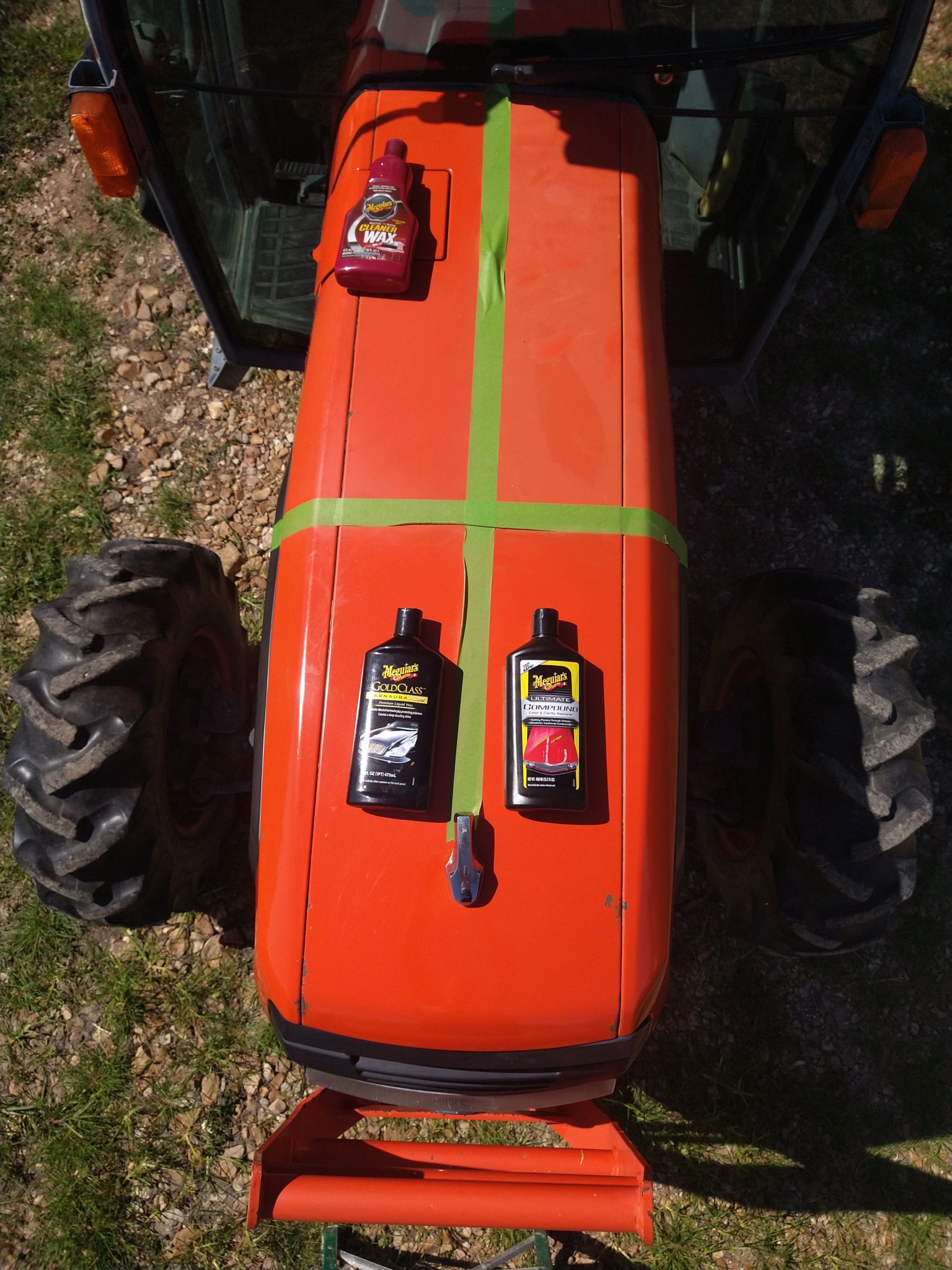

I then put it in the barn out of the sun, as we are in a heat wave now … I decided to see how these products compare … I noticed some white paint drops, which I was able to get off, then started my experiment …
A = Just washed and paint drops removed
B = Rubbing Compound
C = Cleaner Wax only
D = Rubbing Compound + Good Wax
I then did the Rubbing Compound on all of it, and used the good wax on all of it too …it's far from perfect, but probably the first time it has ever been waxed!
The gray really shined up!

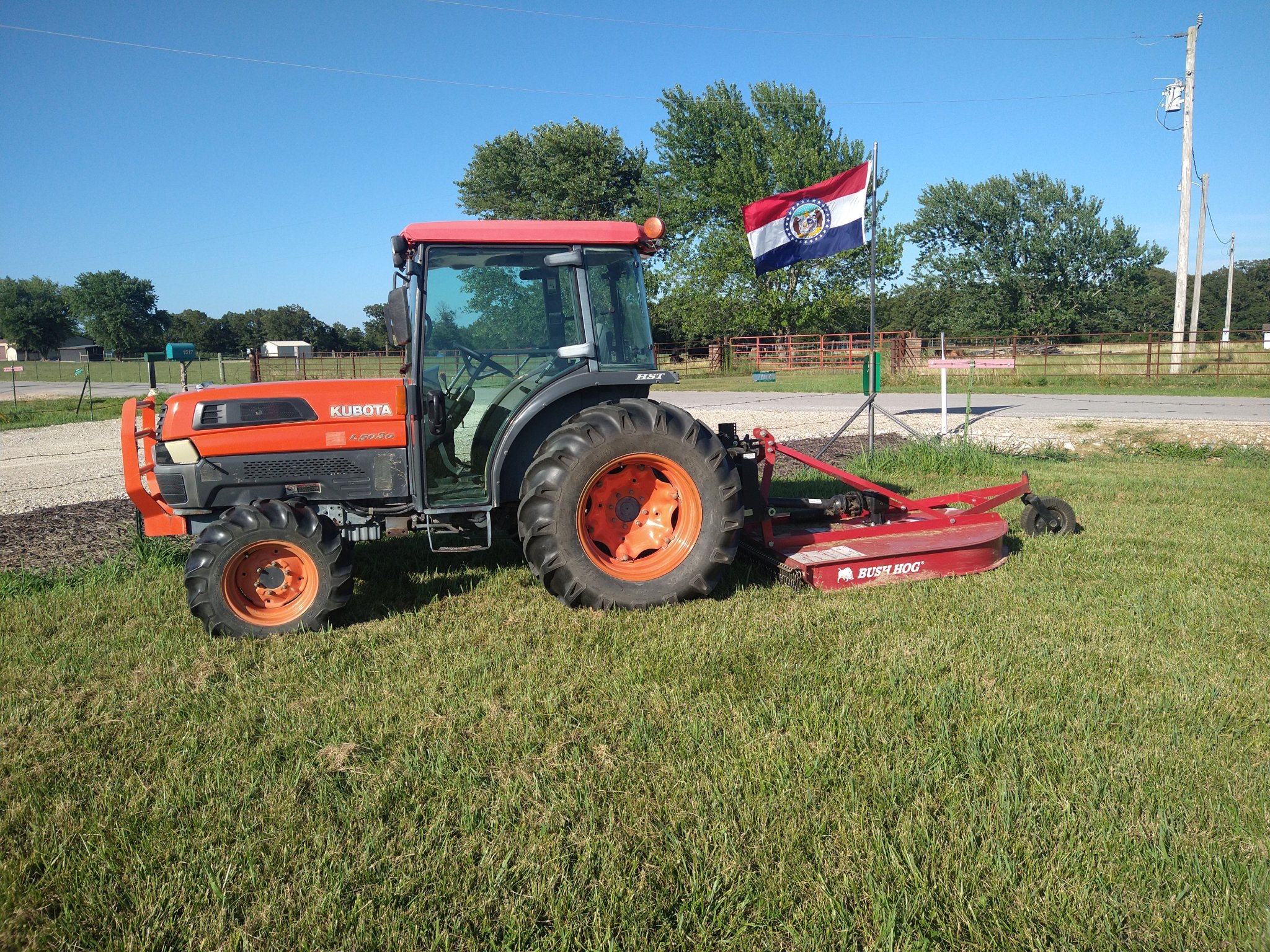

Then I borrowed the quick hitch from my SCUT. I have a new one sitting at the dealer, but they were closed when I drove by this morning before 05:00! I had to shorten the bushing for CAT 2 to CAT 1 about a ¼” to get it in-between the quick hitch.
The top link the dealer gave me was for a JD 4400, as mine didn't have one, the JD was re-sold with a hydraulic top link … it was just barely long enough!

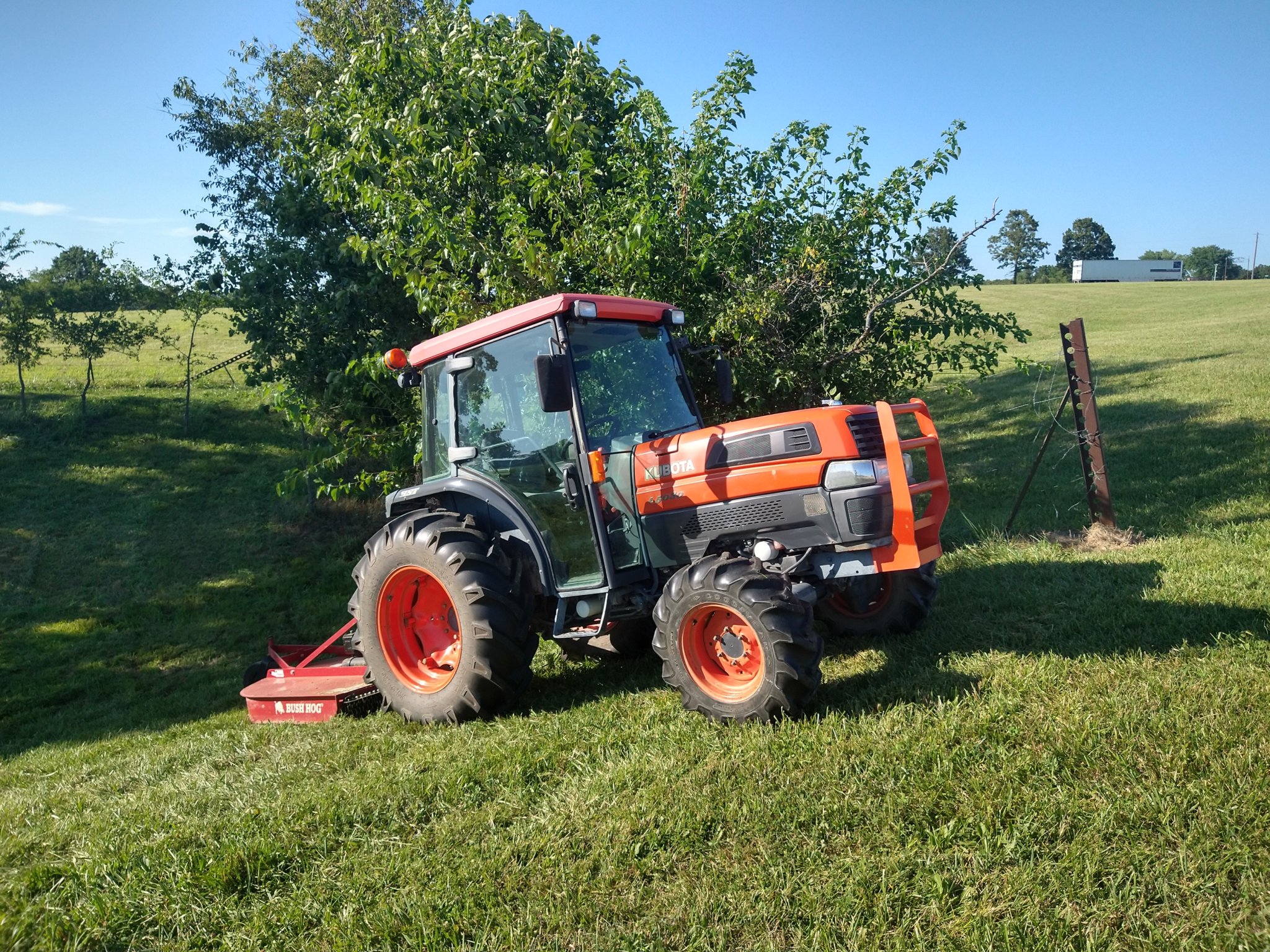

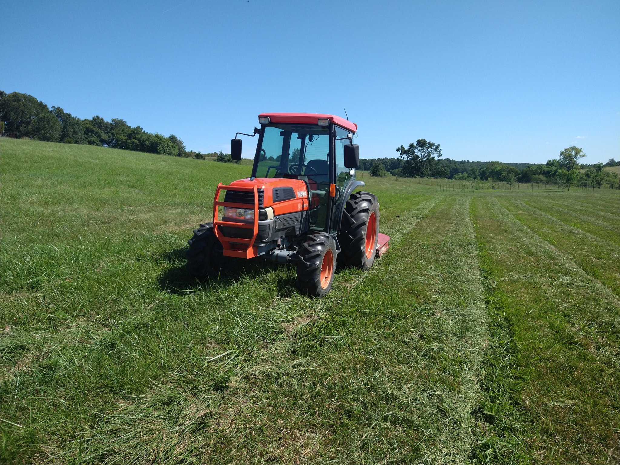

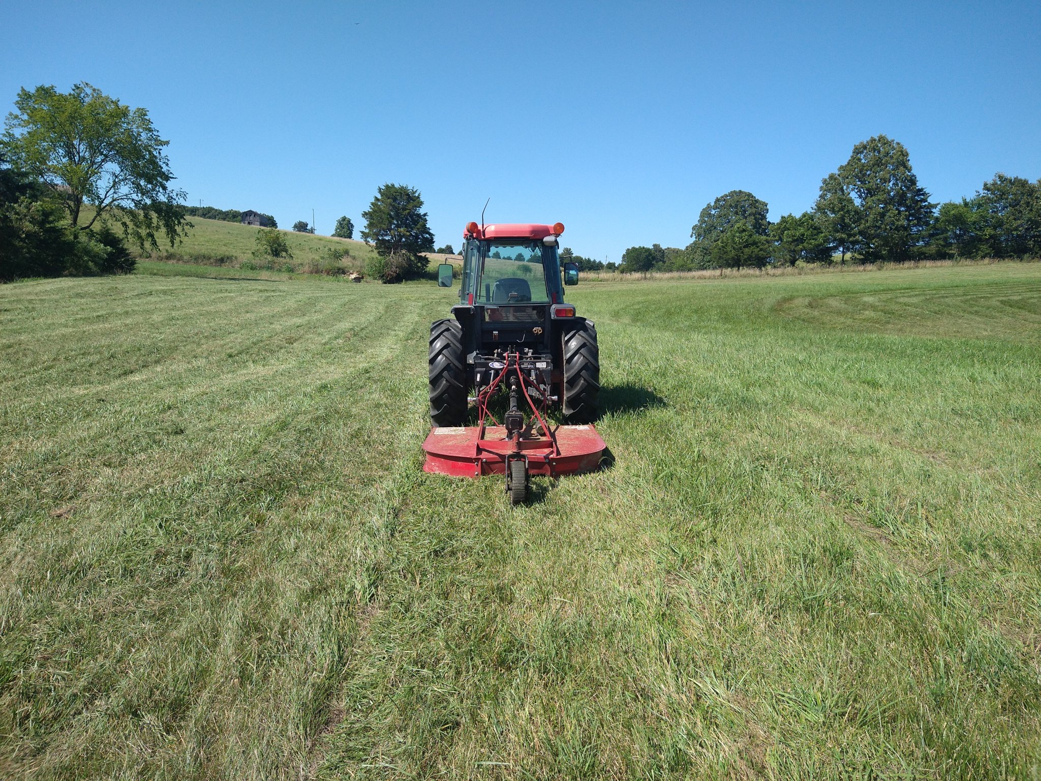

I got the 5’ brush hog hooked up, the PTO drive shaft is also just barely long enough!

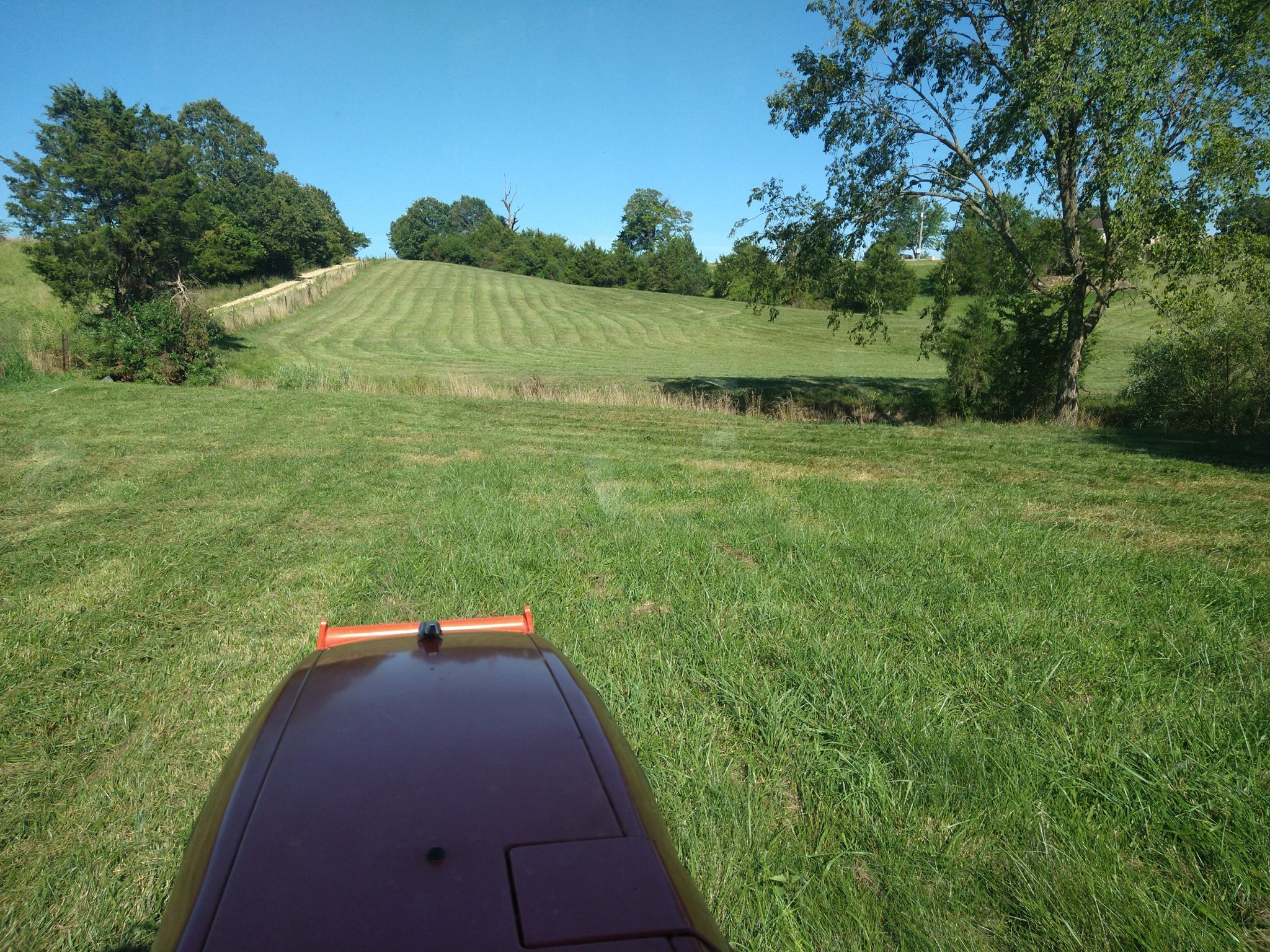

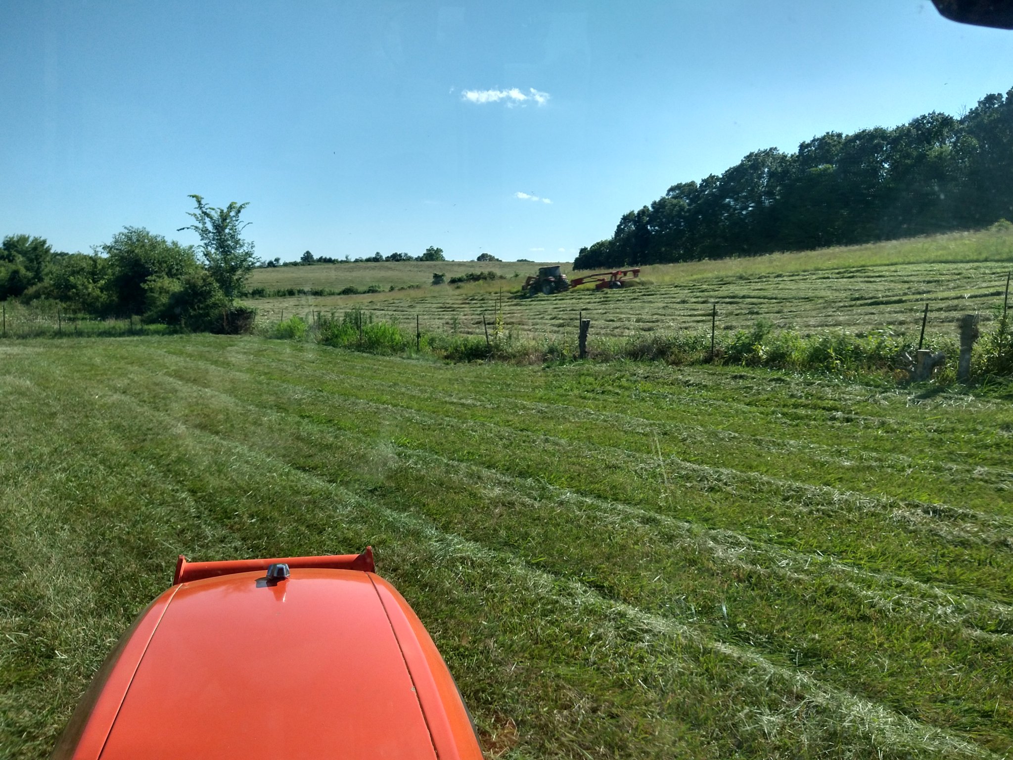

I went out to try it out! I was able to mostly mow at 5.5 - 6 mph, my neighbor was out haying, he saw me and sent me a text . . . It said “ That A/C is cheating!’ look what he is driving!!!

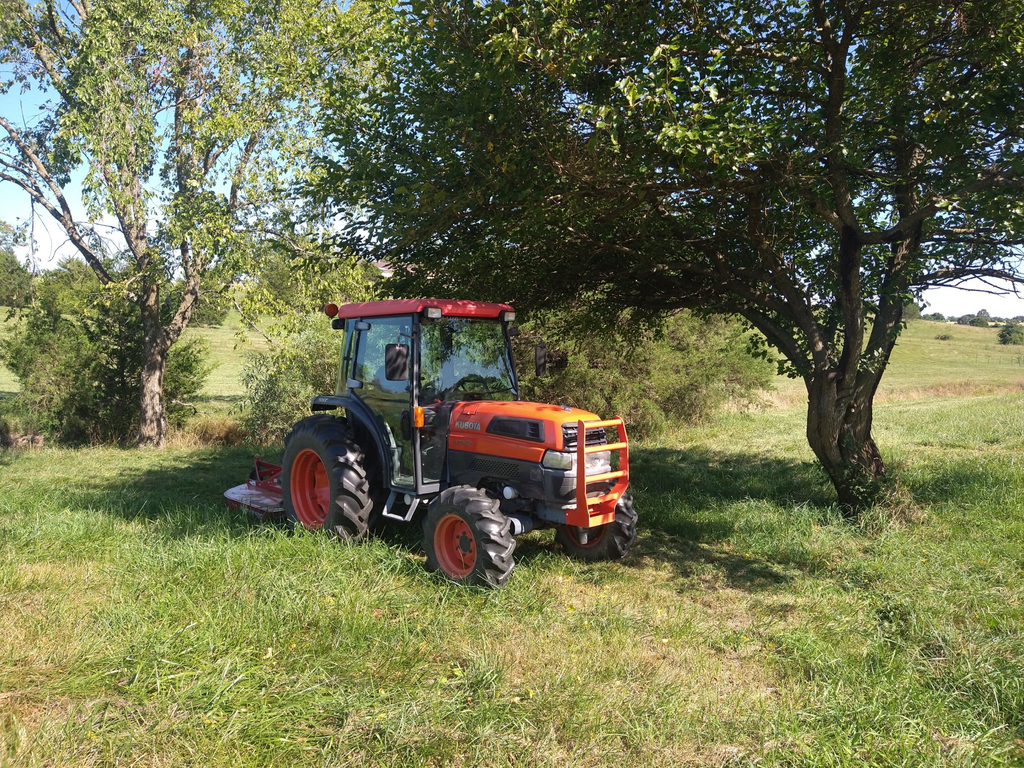

Overall much faster,and much more comfortable than my SCUT! I got 7 acres cut in just over 3 hours … a few pictures of it out working ...
I'm gonna have some tree trimming to do in the future too!

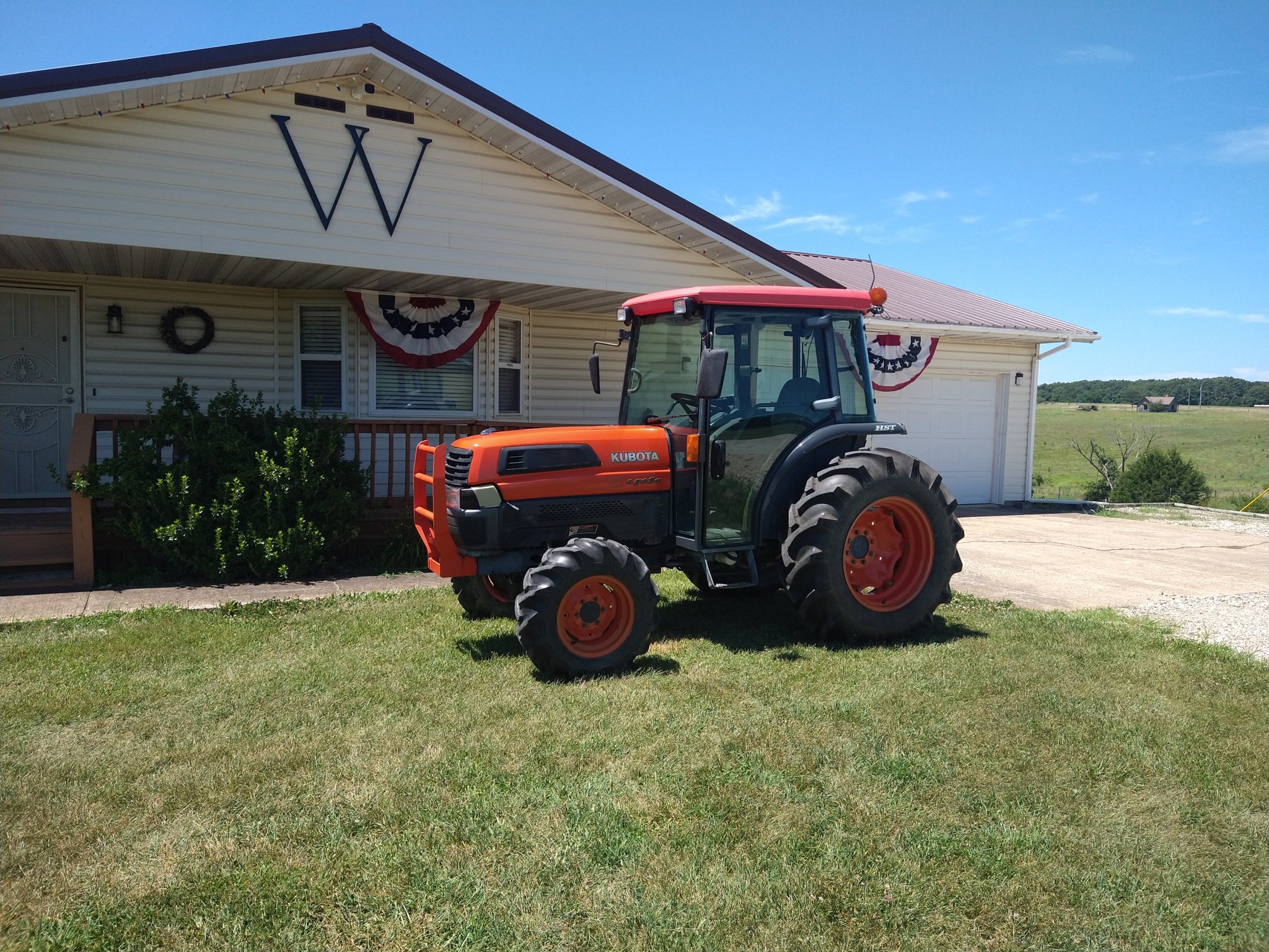

I took it out for a picture by my Missouri flag. I normally fly a USA flag, but our Statehood date is coming up on August 10th, so I'm flying that now … Missouri became the first state West of The Mississippi River on August 10, 1821.

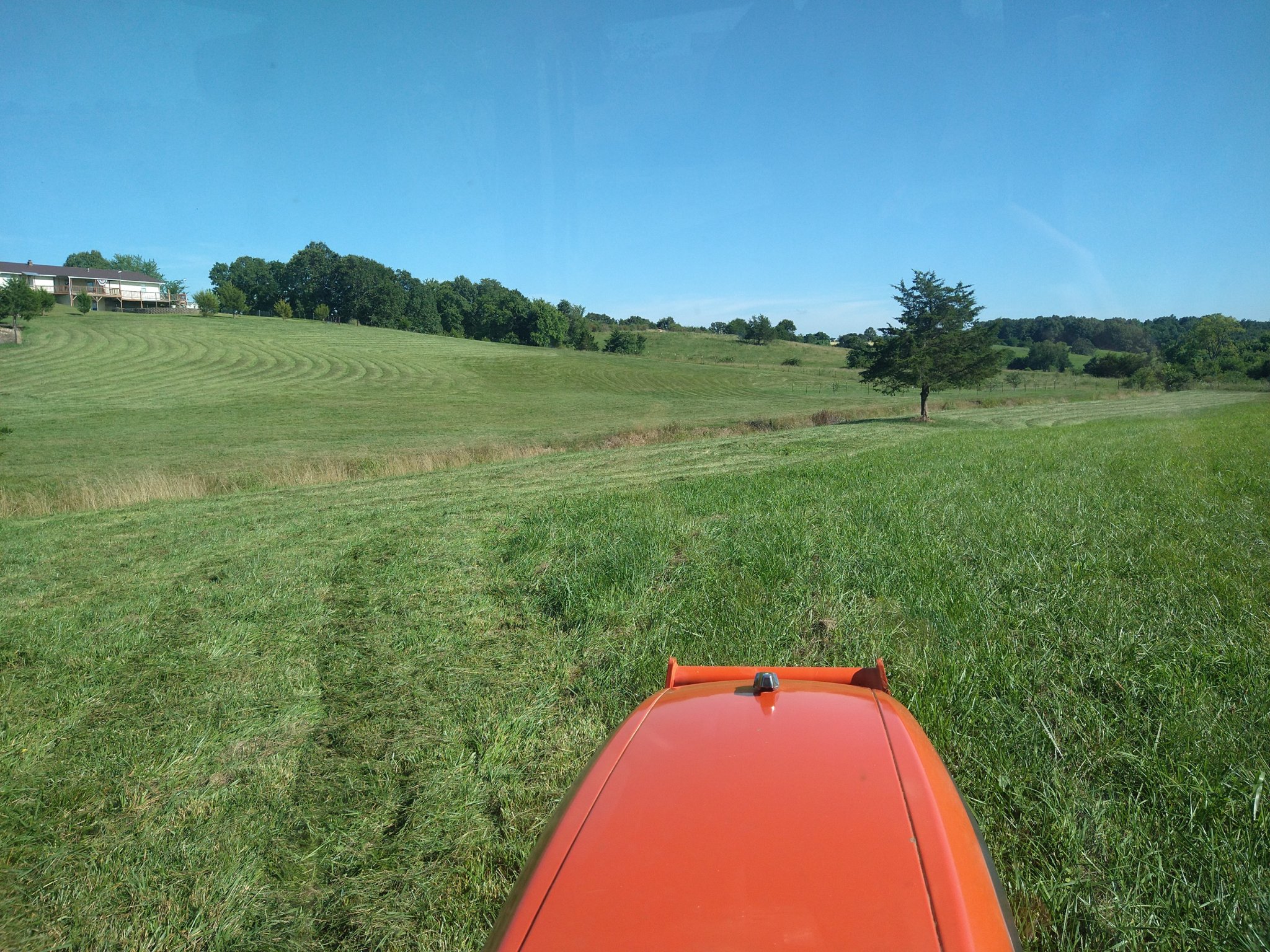

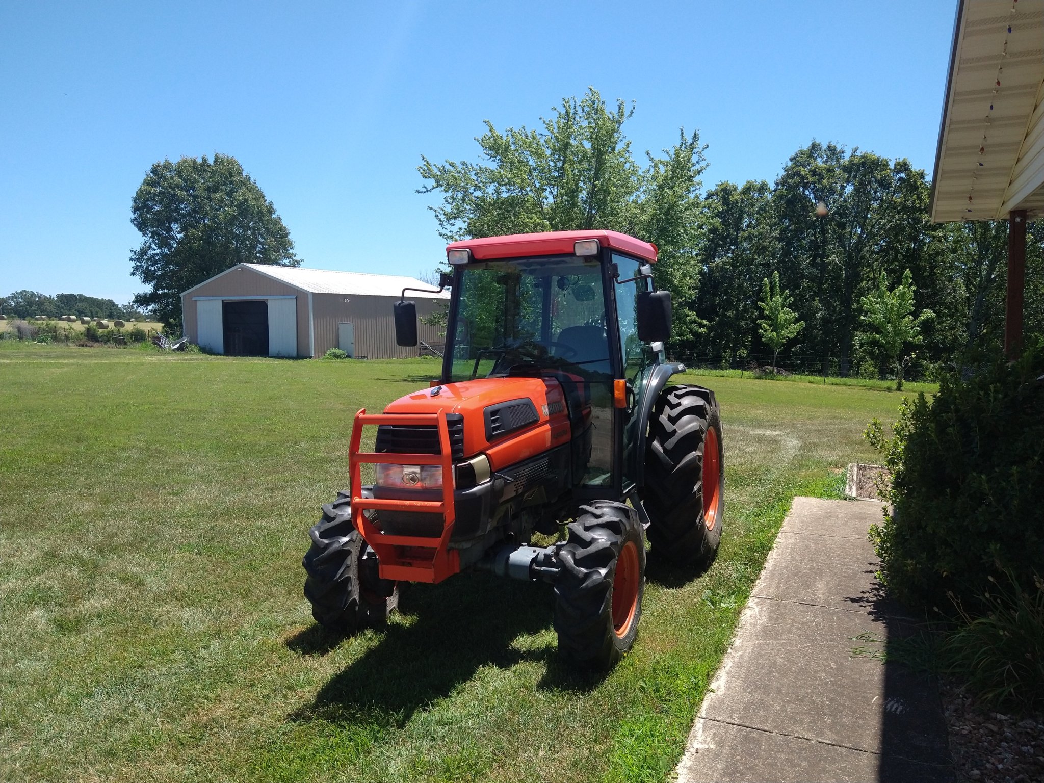

The front field by the road is much smoother than our back, I mow that with my 10 mph Z-turn, I can drive the Kubota 7+ mph out there eas
ily.

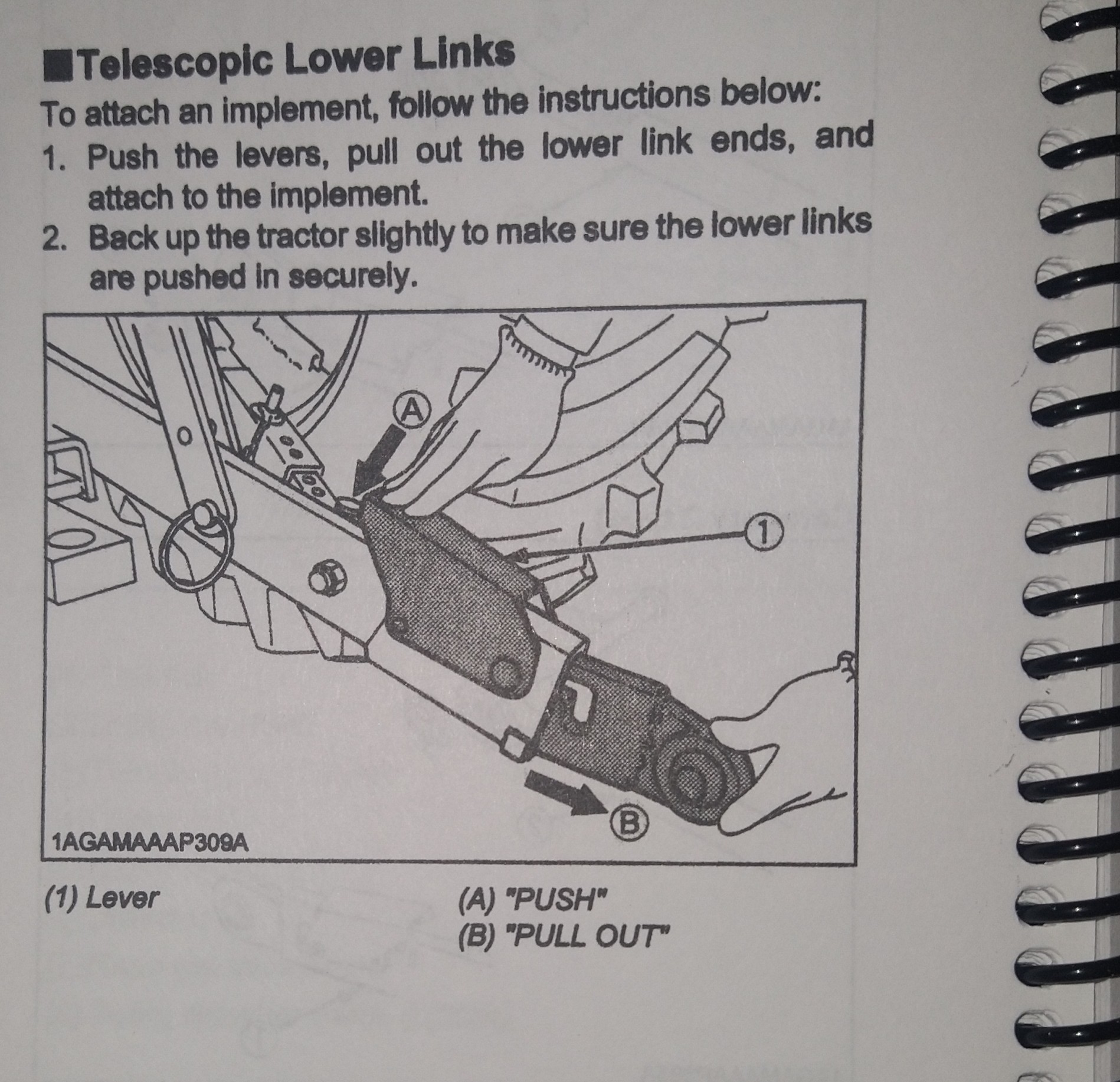

The 3 point adjustable telescoping lower links are still bound up, I can push down the lever, but not pull them out, I gave them another shot of PB Blaster, not critical as I will be using a quick hitch ...

2,945
3,612
Outstanding job on bringing that paint back to life.
Those grey parts are a "night and day difference".
Looks great!

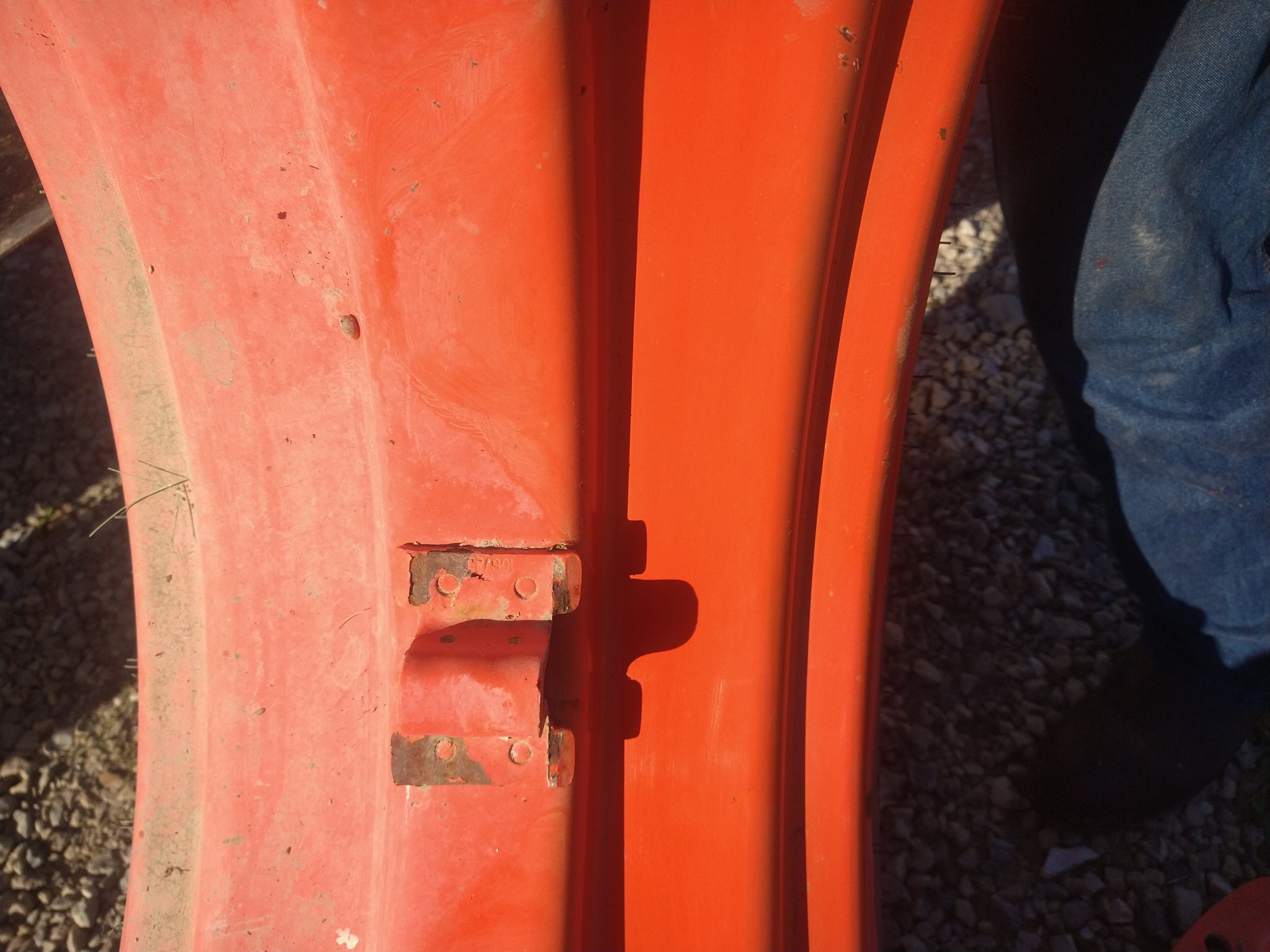

Use a throw away brush, and force some OSPHO on/into those rusty spots.
Then, after several days, cover that with Kubota #2 paint.

@fried1765
What does this abbreviation mean?
I have a small bottle of the "bright" paint ...
6,435
2,061
Ospho is a brand name not an acronym. Here is a link to their site. There are other similar products.

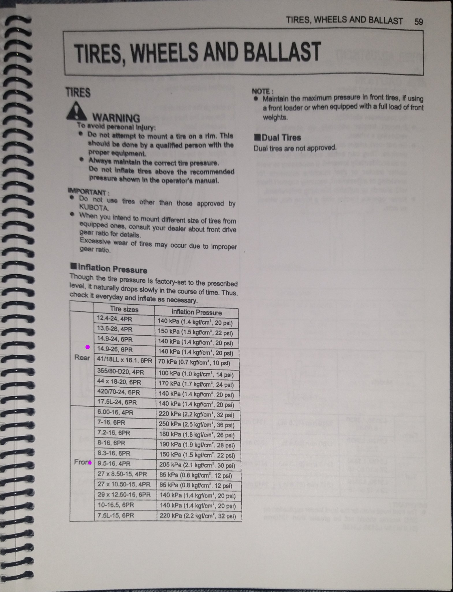

What does your Owner’s Manual recommend for tire pressures, Shawn?

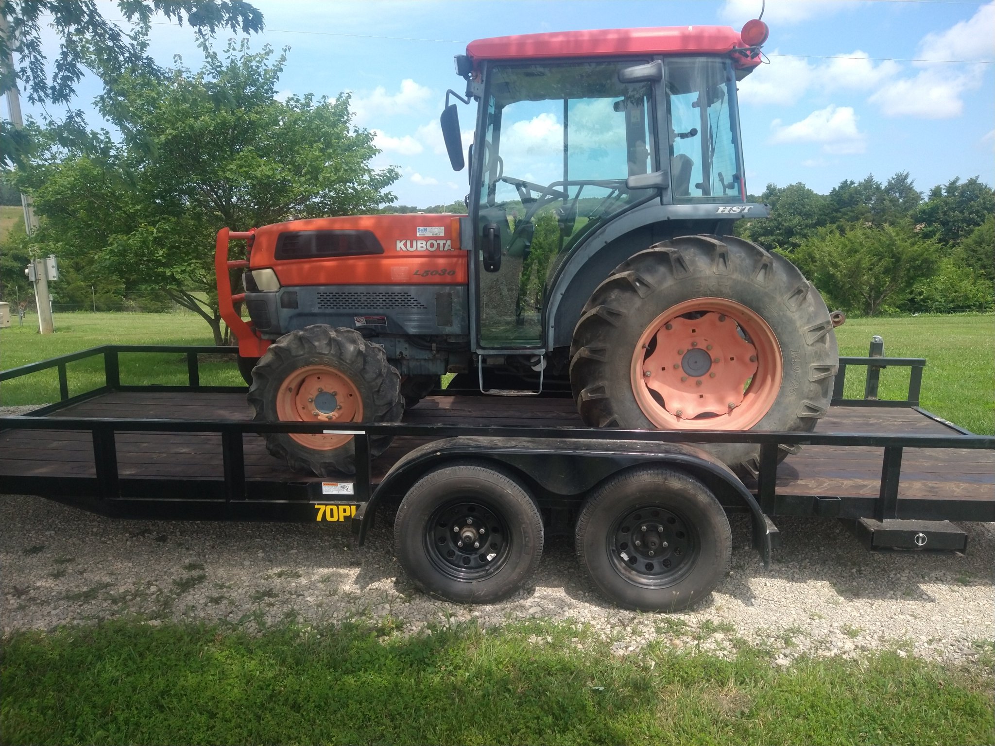

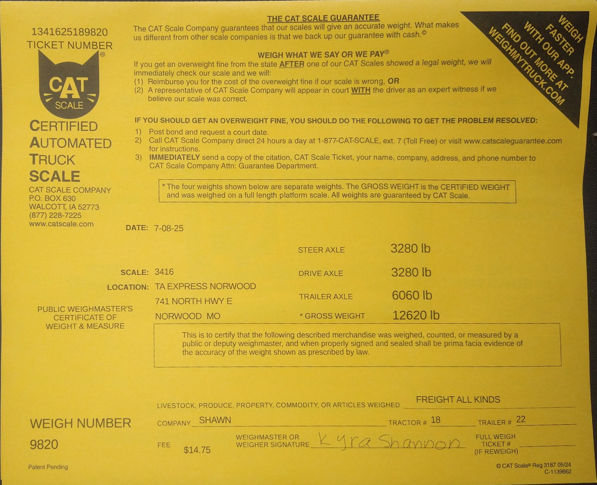

Don't really want or need a FEL, I already got one on my little tractor, which does all I really need doing ... If I increase the weight too much, I won't be able to trailer it ... Trailer is rated for 7K and I'd rather not run it at maximum weight, it pulled good though. This is from the day I bought it.
My rears are actually 8 ply, fronts are 6 ply ... The fronts are quite worn, I'm considering buying new 2 ply ones, not sure just how much the front tires contribute to "ride quality" ... !
