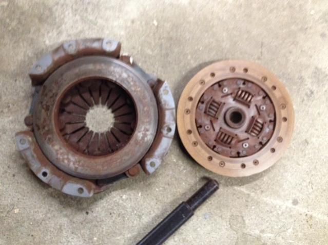

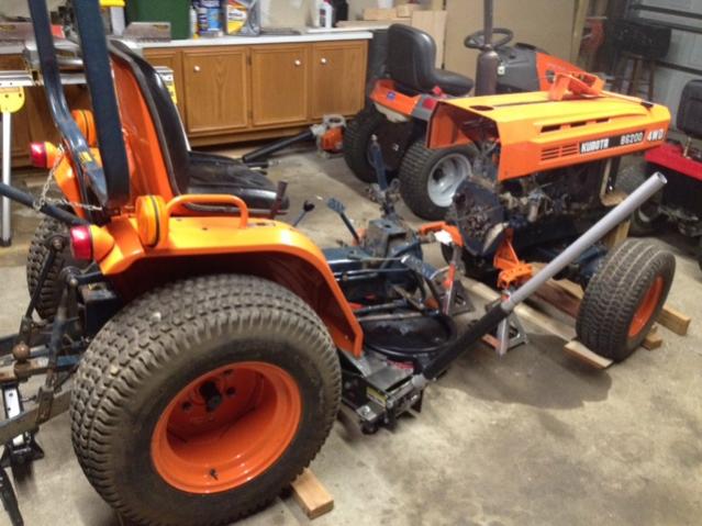

I recently picked up a non running/moving 89 b6200 4wd for $500. After towing home; all fluids were drained, filters cleaned and tractor cleaned. The tractor cleaned up nicely and now fires and runs great but does not move. I split the tractor and found the clutch to be toast. The splines are gone and the face is practically polished. I found a deal on ebay for clutch kits and ordered the following items.

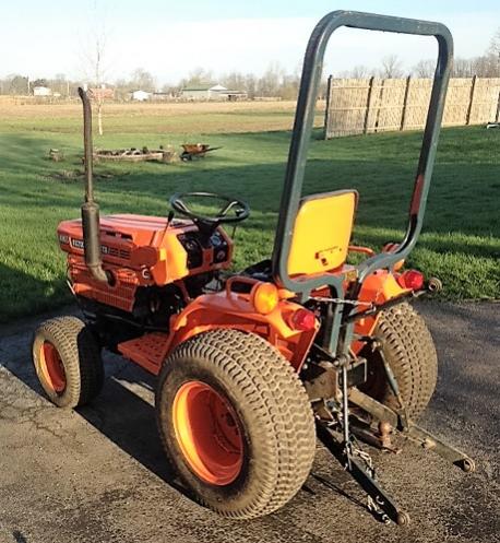

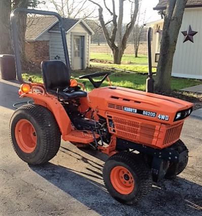

Heres some pics for clicks. Ill post more as I get further along if anyone is interested.

Unfortunately I don't have any advise on your repair but I wanted to say you have a really nice looking machine there!
Even if you didn't get it running you could make you money back in the sheet metal alone.....wish my 6200 looked that nice!:eek:
Good Luck and sounds like you will have a nice machine when you are done for little $$

You stole it,my friend.
Great deal, even if you took it to dealer for repairs to get it going you would still be money ahead.
