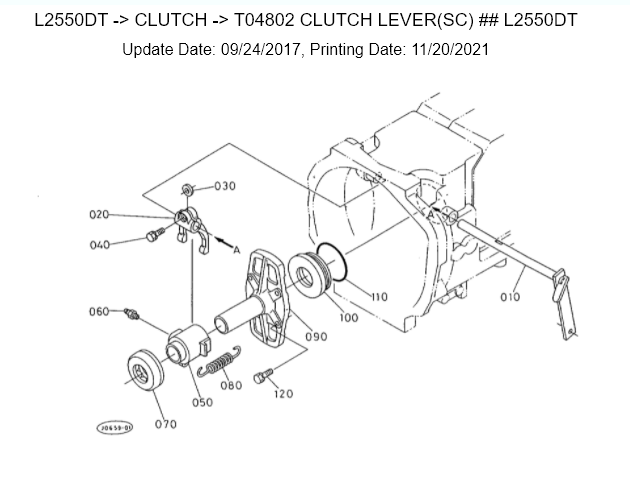

I don't know the specifics of your tractor but I would start by checking the action of the clutch lever arm. Here is a picture of the parts diagram. Shaft 10 operates the release bearing inside the clutch housing. The release bearing is what disengages the clutch disk Disconnect shaft 10 at the linkage and try to operate it by hand to verify it is connected internally. If you can move it any significant distance something is broken inside the housing.
Dan View attachment 70058
Thank you for your input and the diagram. Gonna go out in a few and start checking everything in the daylight.

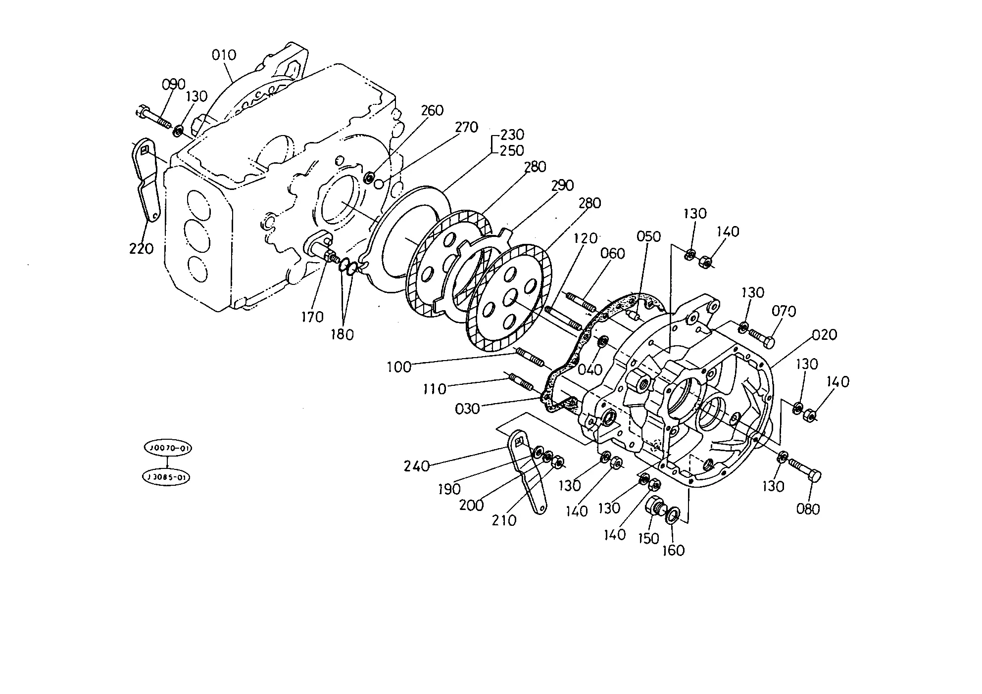

It sounds like your clutch disk has come apart, sometimes the wreckage getting tangled up enough to drive, but other times not. The answer is splitting the machine and replacing it. Dick B L2550 clutch disk.jpg

It sounds to me that your gear-drive tractor has a clutch-linkage which has failed… Either your throw-out bearing yoke (item A in Hokies illustration above) has broken or fallen out of position… or the bell-crank-levers have broken (item 10).
FIRST check that all linkages EXTERNAL to the transmission housing are conntected, operational, and not bent/flexing out-of-position…. If all that seems correct, you’ll have to split that tractor to get inside to see what has failed. It’s possible that item 40 has simply failed/broken/fallen out-of-position…which would result in the problem you describe. You may get lucky …if you can consider only having to split the tractor to replace one bolt a lucky matter.
