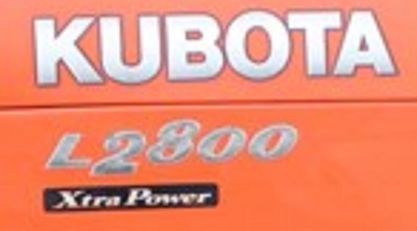

I see you already have listed in your profile 2010 L2800 HST - your tractor would have a factory sticker that reads... "Xtra Power"

Hello there Old and Tired, the meeting and test drive went well, he did purchase the tractor from a dealer in texas and does buy the smaller tractors on a regular basis from them, he became a dealer in 2010, I also knew about the "Extra Power" stickers on the hood starting in 2008, the sight glass looked in excellent condition, the tractor has been just serviced (new white filters) however to what extent I don't know yet but he does have it documented, what I saw was obvious sun damage, 1 white electrical plug below the steering wheel on the left side literally rotted away and lots of hydraulic line cracking which we looked at together, I explained to him what I knew about the pto cams and the hood stickers and the fact that it was sold in 2005, he did seem honestly shocked and he stated I know more about that tractor than he does, I told him it's a military thing about doing research and I had help : ) and that I like the tractor and it will fit my needs perfectly, of course he wants to check out the year, he also has a decent sized disc used (was his) on his lot and is asking $800 for, I'm sure we can put a deal together he's currently asking 14.5K but thats based on him thinking it's a 2010, he has already located a quick disconnect bucket conversion that he said he'd do for $800, I'm thinking probably 13.5K total for conversion and disc but I'm not sure. I don't mind him eating steak but I don't want to pay for a years worth : ). your help has been invaluable. On your 6ft box blade does it have scarifiers? He is also a Lands- Pride dealer

One other thing, did it have the Xtra Power sticker?

Yes I did test the 3pt with big disc that he had there, it seemed smooth, tires looked a little worn about 400 hundred hours worth but still lots of tread left, hubs had been repainted, the front grill plastic was slightly out of place but not cracked , has a grill guard, the little alignment tabs not perfectly lined up, battery hold down a little wonky. he is a kubota dealer and has mostly big rigs on the lot with only a few smaller rigs around all new, that is literally in the middle of corn fields I'd like to give the guy the benefit of the doubt but I do think he should have done his due dilligence before buying that tractor, I told him I'd call him by wed basically to find out what he found out and how much he'd sell for, plus I'm taking off for a week duck hunting then, also no extra power stickers which I told him were on 2008-10 hoods
