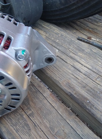

Purchased an ebay 35amp mini 1 wire alternator, drill bottom hole out with 1/2" bit and top with a smaller bit (dont remember exact size) just enough to cut threads out so top bolt will slide on. remove old alternator. Add a nut about 1/4" thick to bottom bolt before sliding on. Slip on alternator on bottom then tap top bracket down a tad till hole lines up then stick belt on and then reinstall shield/nuts onto bolts. run power to starter power and lead off headlight wiring to top cross spade connector and done. $56 and works great. I rewired my tractor for a newer style kubota switch with glow plug hold on one side and am very happy overall with redoing it all. Starts a millions times better!!!
