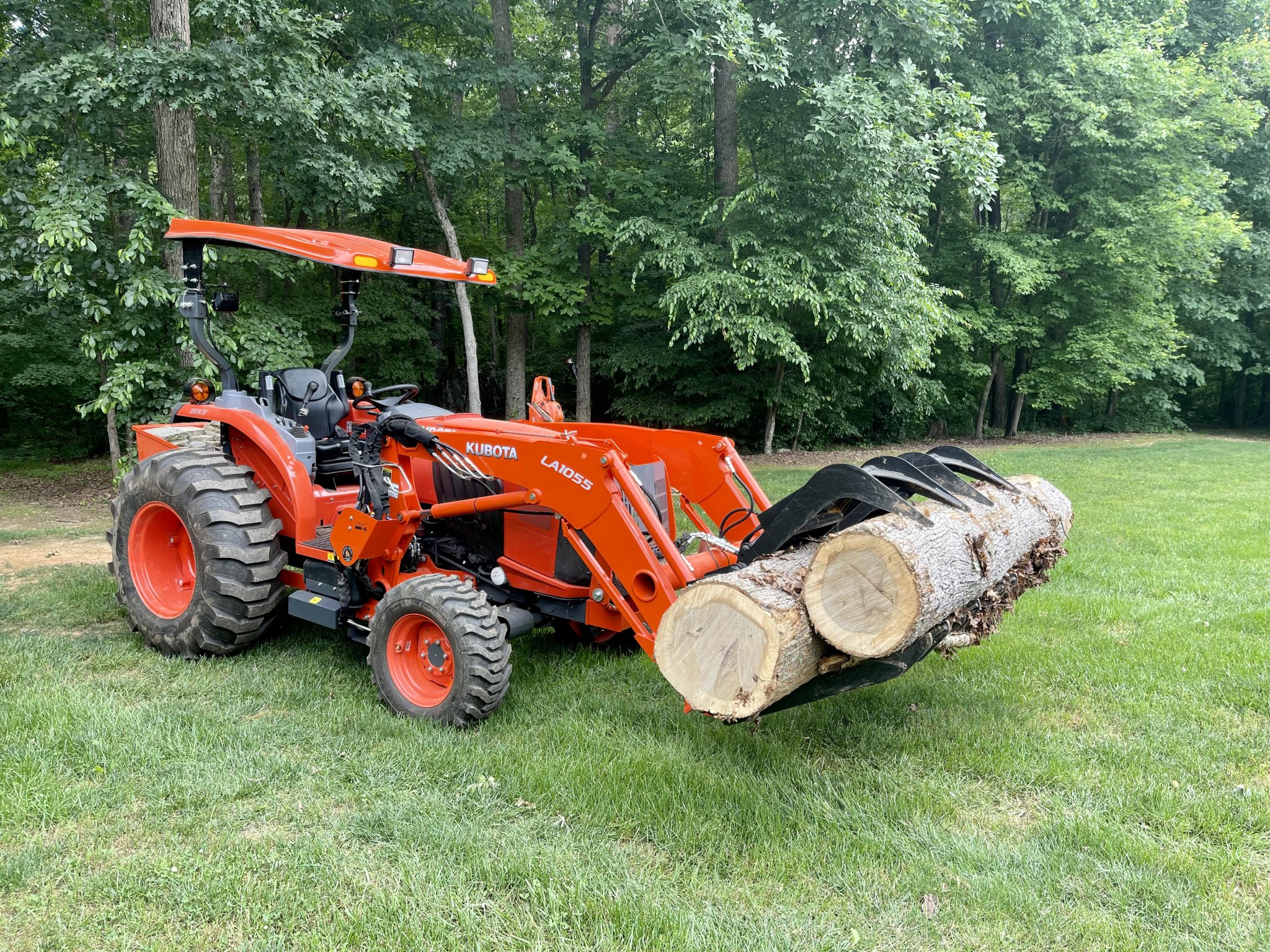

I have an open station L4760 that I use in the woods. I purchased the 4760 to get the loader capacity and hydraulic flow of the L6060 but in a smaller size machine. I am in the process of widening our trails that were built for ATV's. The loader is very strong and my 64" grapple really works great for tree work. I need to use a 1k lb weight box as well as loaded tires to take full advantage of the loader/grapple. I also have my rear tires in the widest configuration and it makes for a stable platform. I have 150 hrs on my tractor that is a year old. So far I am very happy with the power and stability of the tractor. My old 30 h.p. tractor was better in tight places but so far I have not damaged anything and get around well in the woods..

I have an open station L4760 that I use in the woods. I purchased the 4760 to get the loader capacity and hydraulic flow of the L6060 but in a smaller size machine. I am in the process of widening our trails that were built for ATV's. The loader is very strong and my 64" grapple really works great for tree work. I need to use a 1k lb weight box as well as loaded tires to take full advantage of the loader/grapple. I also have my rear tires in the widest configuration and it makes for a stable platform. I have 150 hrs on my tractor that is a year old. So far I am very happy with the power and stability of the tractor. My old 30 h.p. tractor was better in tight places but so far I have not damaged anything and get around well in the woods.. View attachment 74567 .
Good info. It sounds like you are doing exactly what I want to do with mine. The 4760 is as big as it gets in that size frame which is appealing to me.
