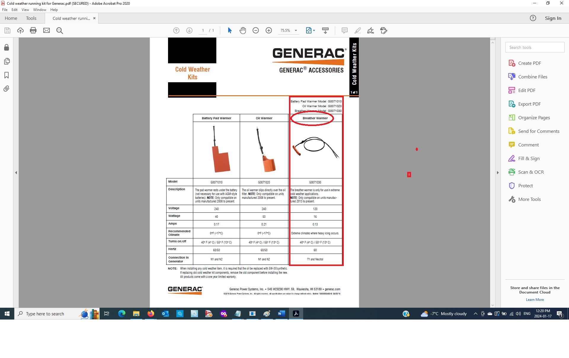

Many engines experience this vent system freezing. Small generators, if you do some searching provide silicone pad hears to wrap around the tube between the valve cover and air filter housing.

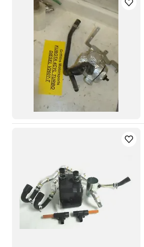

Does anyone have a picture on the machine of what to look for / how to confirm the update has been completed? I wonder how to check? If someone has a pic please share…thank you in an advance. (Or serial number range of affected units)
Silver insulation over the pcv lines/seperator. Should cover all gl60 models and prob anyone who asks... My dealer sent me a kit for my 2016 gl3560 that was already done from the factory.
Second generic pic is of a inline pcv heater kit. The dealers never ask if you want the option because as stated before, you need the alternator upgrade. About a $1500 upcharge. Should be more of an issue on turbo model engines, and those that live in double digit neg temps.

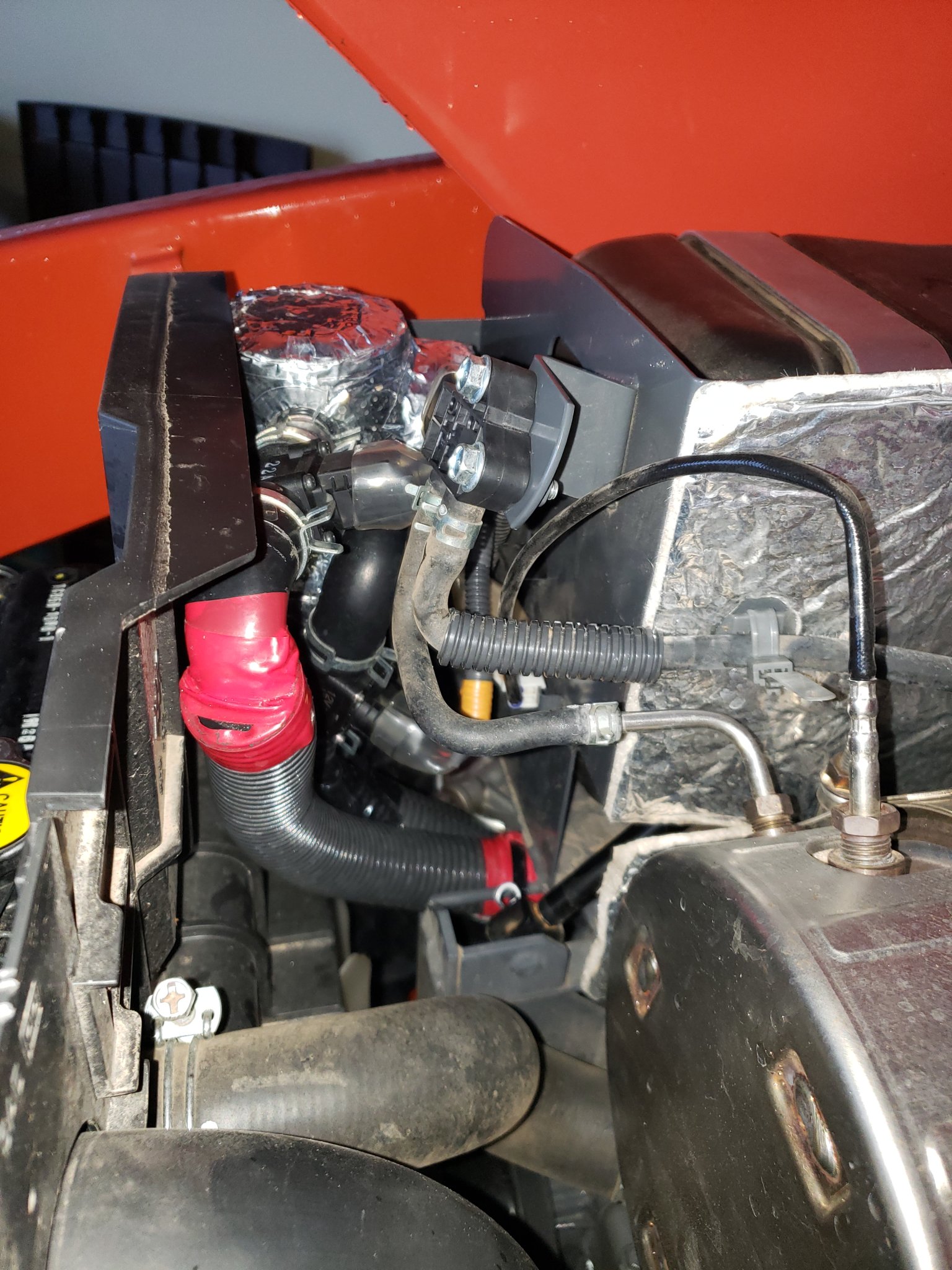

Hey guys,
The dealer brought the tractor back last Thursday. I ended up paying $1200 of what would've been $4k. The turbo is an expensive little piece, $2k. I did have them add a coolant heater while it was apart. They also installed the CCV heater kit for $550. According to the service manager Kubota wouldn't cover anything unless the CCV heater was installed. I asked about the charging system issues and the dealer said don't let it idle and it won't be a problem. I don't idle it anyways to help with keeping the DPF hot and clean. I let it "idle" at 1300-1500 rpm. I will check the voltage at the battery to make sure the alternator is keeping up.
I've included a couple pics. The one of the engine shows the CCV filter with the foil insulation on it. The hose with the heaters is buried so I wasn't able to get a good shot of that.
Thanks everyone for your input!
