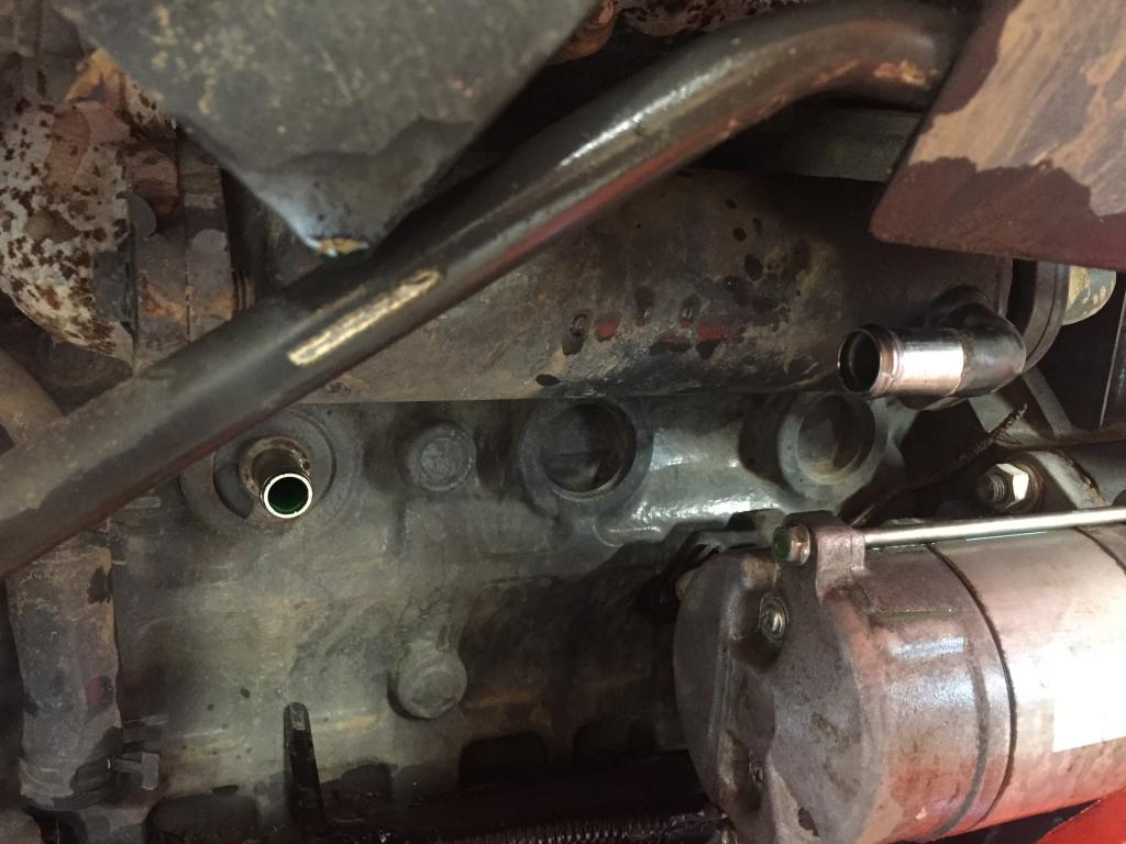

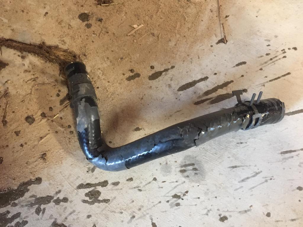

Snagged this pipe on a stob today. Leaking radiator fluid from a cut in the hose. I couldn***8217;t find it on the parts diagram. I***8217;m guessing it***8217;s part of the water pump system? Can anyone tell me what it***8217;s called or a part number? Might save me a trip to the dealer if I can order one from Messick. Thanks, Cathy

Your welcome. Actually it item 50.1 which supersedes item 50.

I’m concerned the “nipple” where the hose connects to the block (at what appears to be a modified freeze-plug) might be damaged or dislodged and may leak at that point.

The rubber hose got punctured towards the ERG end (slow leak, not repairable) so both of the metal pipe ends are fine, it got cut by a pointed cutoff sapling while clearing some brush. Fortunately all of our tree thinning and cleanup is now finished on both farms so we can focus on things that don***8217;t damage the tractor, like grading, discing and bush hogging
