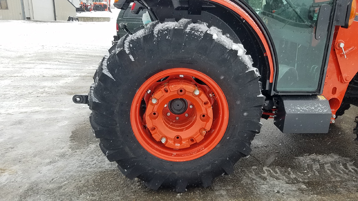

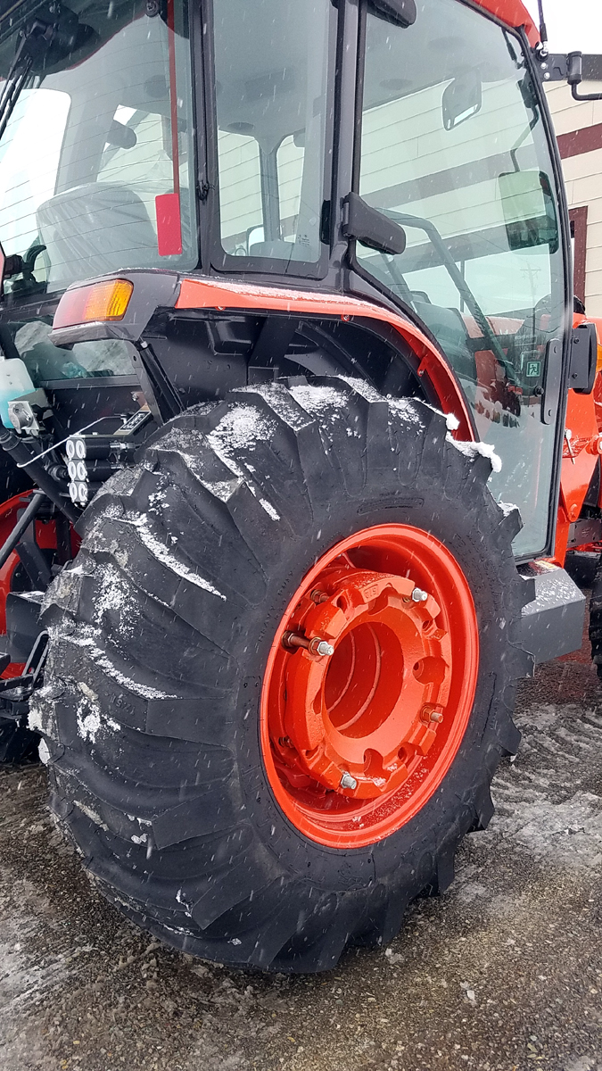

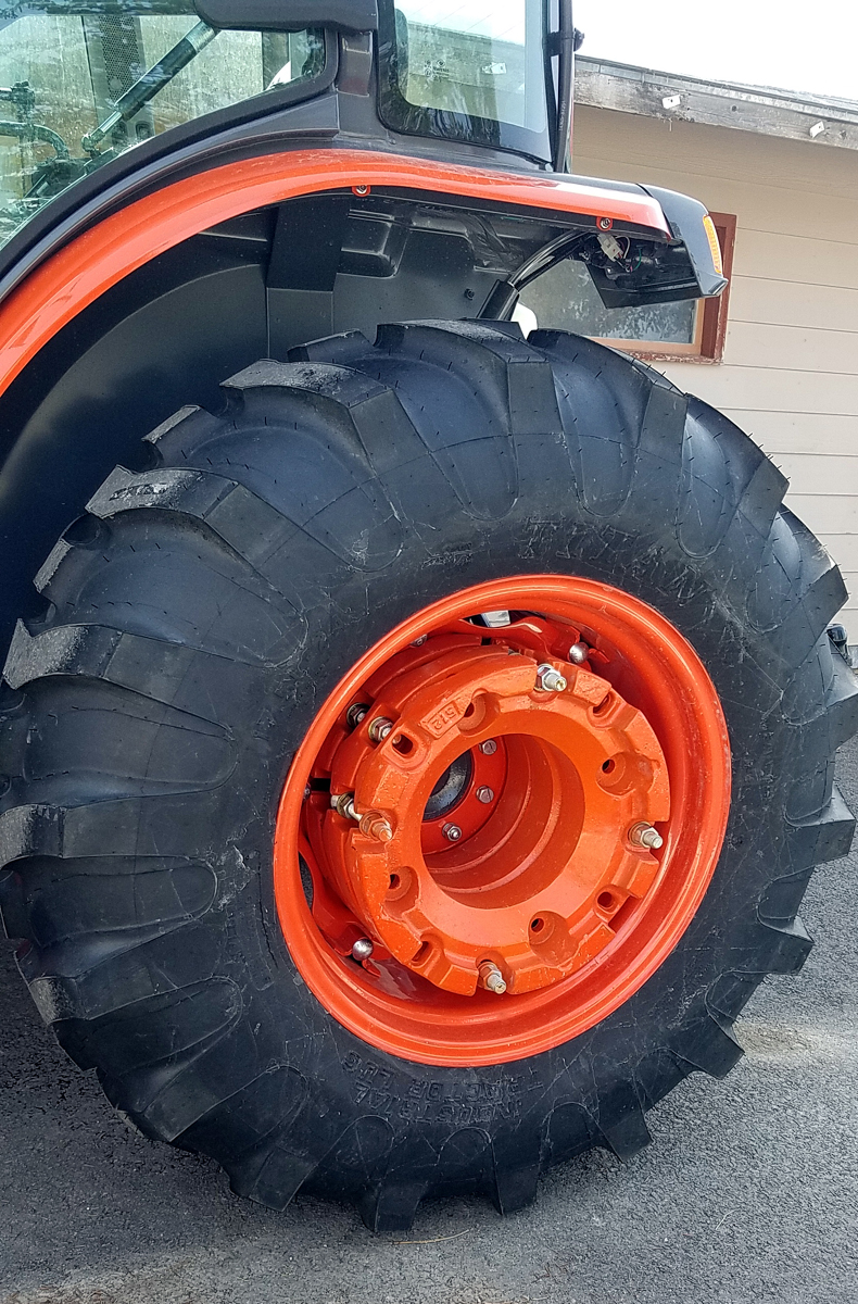

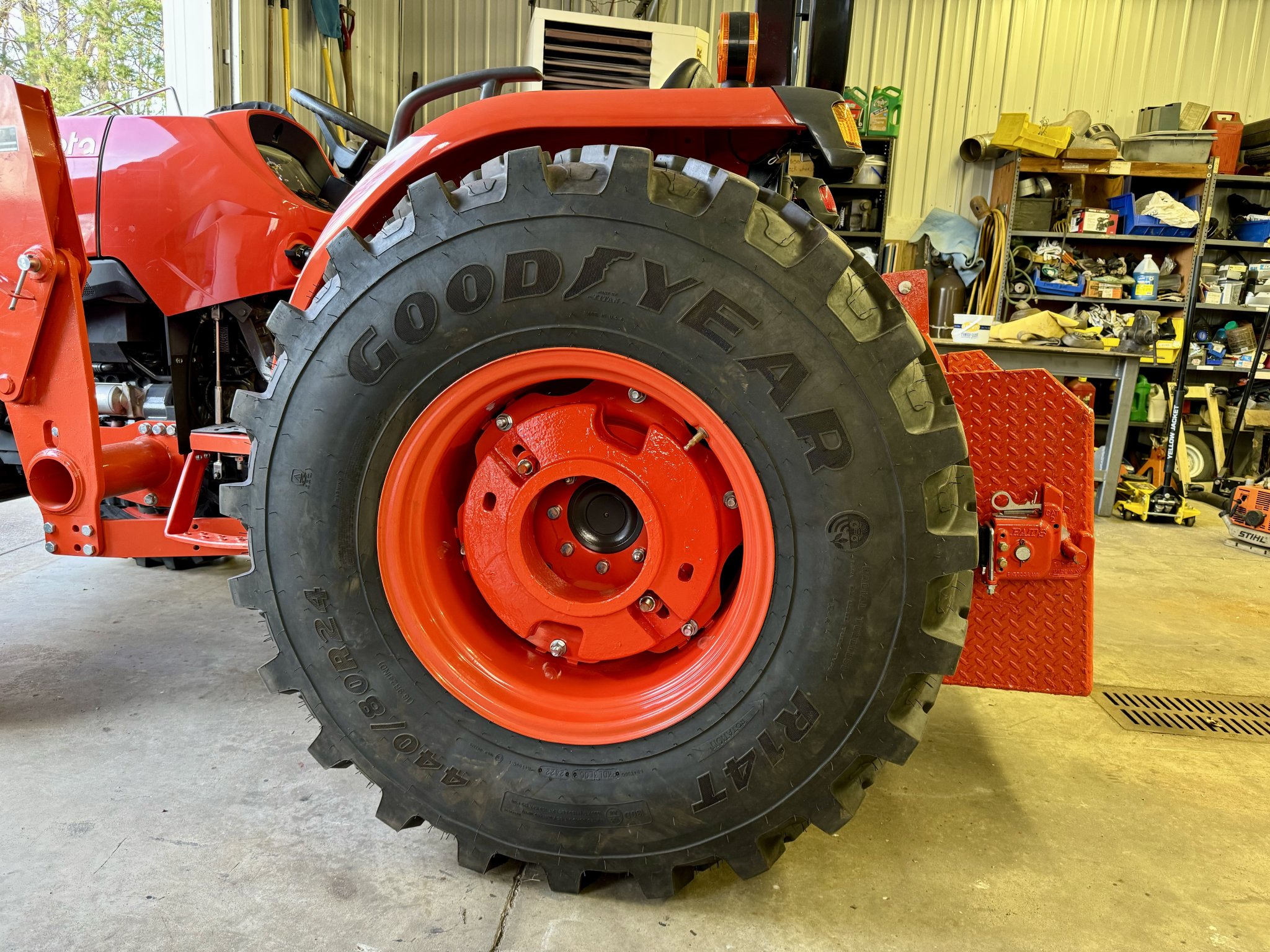

Thanks for the pics. I’m just trying to avoid giving the dealer $1700 for 3 sets of weights and a bolt kit. Thinking about beet juice in the tires. I don’t like how far ballast boxes stick out the back. Don’t know which way to go.
If that ad is still up, it's only $40 bucks. As long as the diameter is small enough to fit inside the rim, you could drill new holes to match your pattern.
The cheapest I've seen them around here is $250.

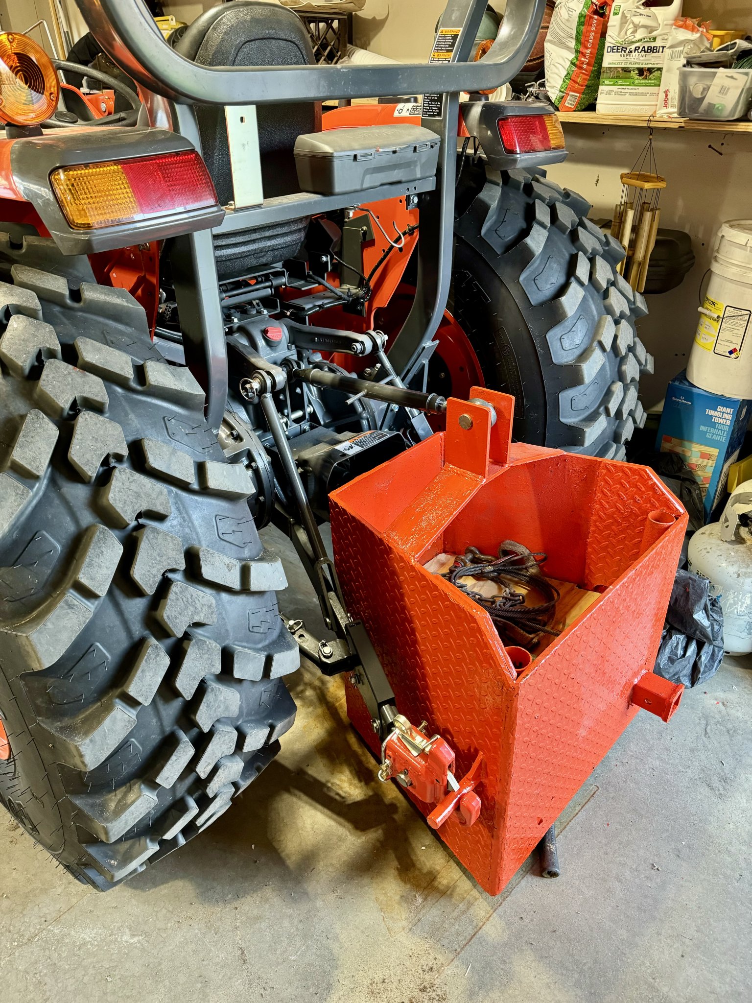

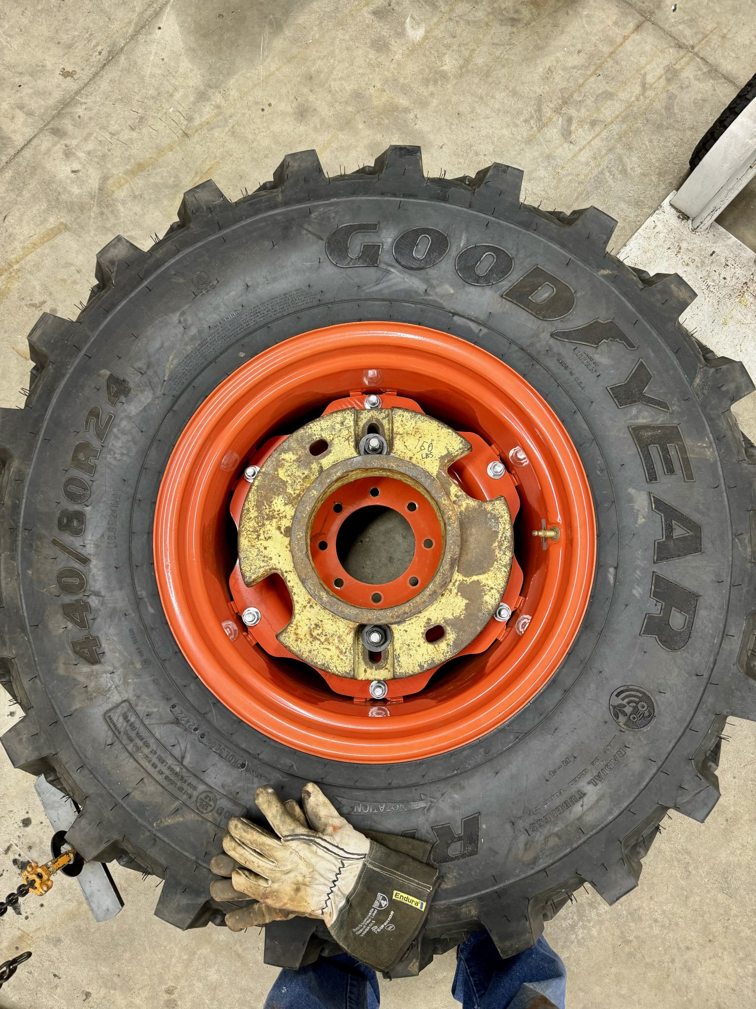

Got it done. Weight box weights 600 lbs. empty. Old JD wheel weights slightly modified, 150 lbs each. Total cost $180.
Nice job. Looks like the box really tucks in close the machine. 👍

Can't beat the price! Looking at my MX spreadsheet and bill of sale, I paid $1,305 for three sets of wheel weights, hardware and installation.
For the MX the factory weights are 100lb each which adds up to 600lb of total weight. The M has 990lb of wheel weights.
Those like to be for the old A-B-G John Deere tractors. Have some of them that have been on a JD A tractor since my FIL bought it new in 1950. You have your self a cheap weight set up.
