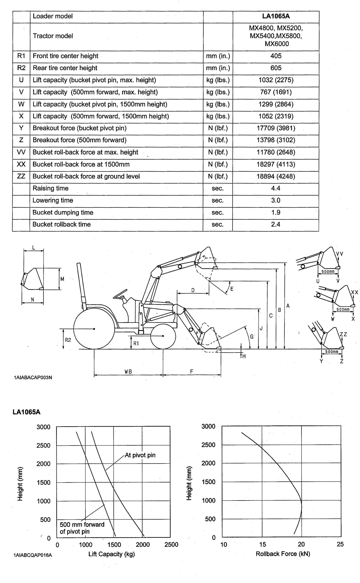

Lift capacity 2230 at the pivot pin, without implement. With pallet forks on, and with the load centre of mass more like 18 inches in front of pivot pins, I'd be very surprised if it could lift more than about 1,200# to a decent height.
Looking here https://kubota.ca/en/products/implements/loaders-bx-b-l/la1055, I see 1,780# at 500mm forward / 18 inches forward. Less pallet forks, call them 150# perhaps. So 1,600# to max height. However, to 1.5m, you'd lift 2,400#, less forks, maybe 2,250. Hmm. How high were you trying to lift it?

The 1065 FEL specs are shown below. 2,319lb capacity at a height of 4'-11" and 19.7" forward of the pivot pin, and then you have to subtract 375lb so that's 1,944lb lift capacity. Then consider that the center of the load is probably more than 19.7" from the pivot pin so the lift capacity is lower still.
