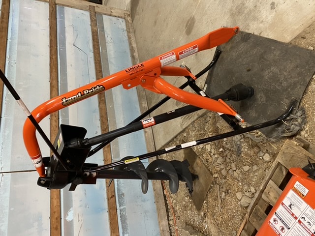

Front is what I want. The rear is an option if I don't find something that will work on the FEL.What model was that 3pt version you pictured?
