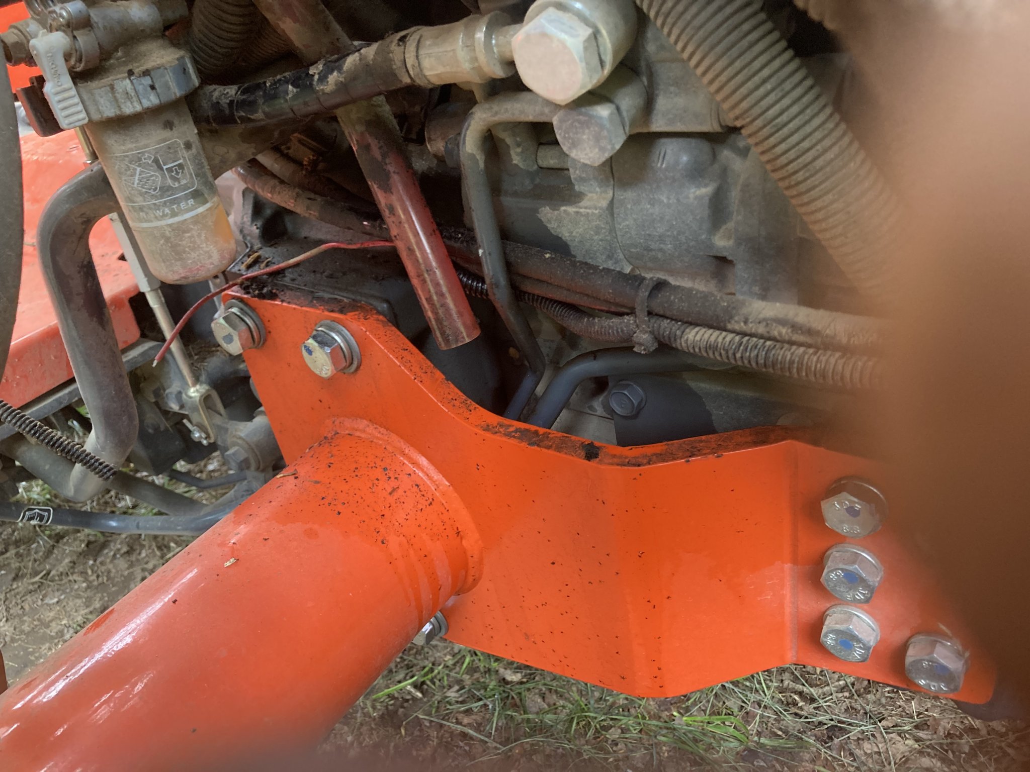

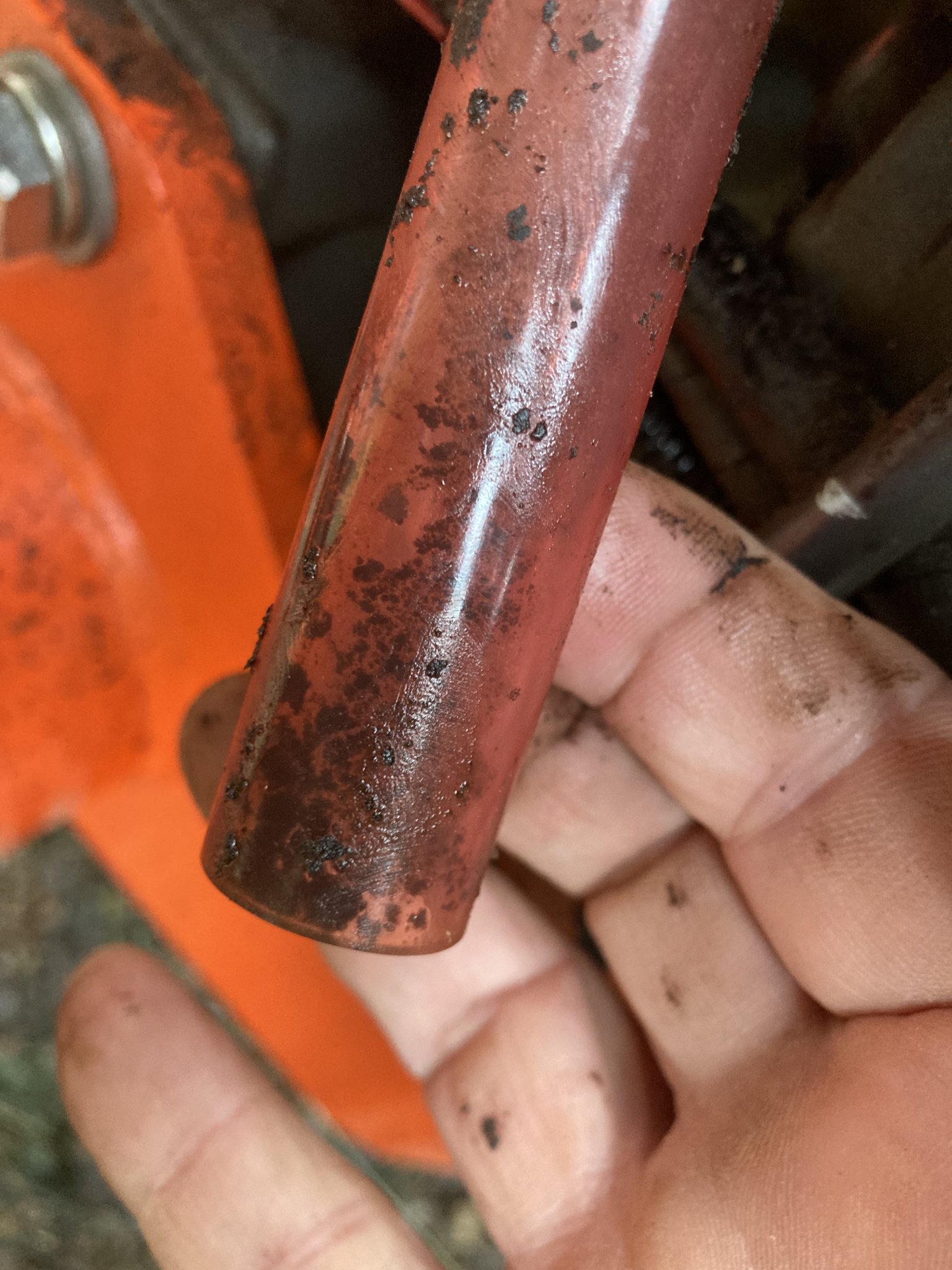

Here are the photos of the hose.
The hose in the picture is of the hose coming down from the cup around your fuel tank fill. There would never be any oil in it, only fuel if you overfill the tank.
You need to keep looking for your hydraulic leak.

@whitetiger
OP states hydraulic fluid was coming out of this. Is there anyway you can think of that hydraulic fluid would get into the fuel fill area?
@jim0316
Can you post a picture of the tank fill area to see if it is dry or coated in hydraulic oil? Also see if your fuel tank is over full or not.
If the hose was connected to the engine then I would suspect that the hydraulic pump seal failed and pumped the crankcase full of hydraulic fluid. Please check the engine oil level just since it is simple to do.

@whitetiger
There is a little funnel that sits around the fuel fill, this hose runs from it down the RH side of the engine to drain any spilled fuel. The only way to get hydraulic oil in it would be to pour it in.
The tractor probably has a steering hose leaking that is spraying oil onto the drain hose.
