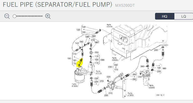

You have a fuel delivery issue.
Did you drain and clean the separator?
34,095
9,287
You need to pull the line off that feed the fuel filter, and check for flow with the key on, as it could be a failed lift pump.
Do not remove the banjo bolt fitting off the fuel filter.
