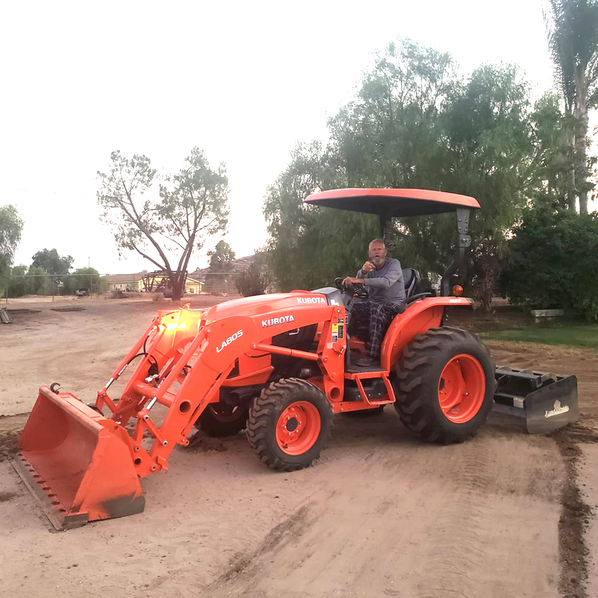

New Kubota owner here, 1st post,......I just got this back to the ranch last week an still learnig, .....my wife and I started building our "ranch" 45 years ago, I've had an old Ford 4,000 industial all these years, I'm just burned out tinkering with it, ANYWAY'S, we got the Kubota L3506 back home, an the 1st attachment I got was a landscape rake.....me & the wife ( she's 70 yrs old an I'm 74 ) managed to swap out the gannon box an put the rake on, yesterday, we took the rake off & put the ganon box back on an called it a day, went out to start it the next morning , fired right up, BUT, I couldn't get the loader to do anything ...NUTHIN, the control handle was locked up,.....I found the "lock / unlock" handle under the seat but couldn't move it at all ....after searching the whole damned innerweb, I went BACK to what we had done when switching out the ganon box, figuring the last thing I did was diconnect / re connect the 2 hydraulic hose's , when I pulled one of the hose connecter's out it started dribbling fluid, when I shoved it back in it didn't seem to go in as easy as the other one, after a couple of tries I got it back in, fired it up again an lo & behold.....bucket is operating as it should.....................ANYWAYS, sorry for the "novel" here, I'm sure MOST of you guy's probably woulda figured this out from the get !........hope this might help somebody out, AND, I'll most likely be asking stupid / simple questions now & then, but that's ok, at MY age, I can't be "embarassed :)
