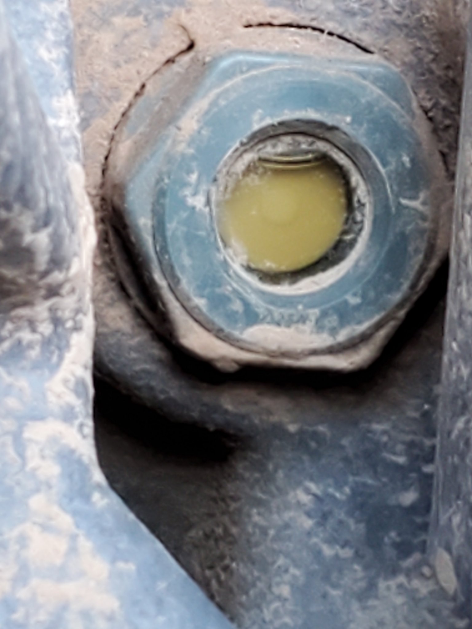

I haven't changed trans. oil/filter yet (400 hrs?). Smells like gear oil, but looks clear in site glass with oil le
vel slightly above normal.
