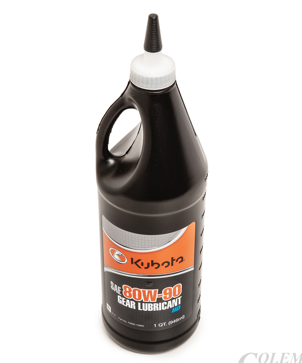

I change the front gear case out at 50 hours just to get rid of the SUDT2 the factory put in for some good gear oil 80/90 weight.

Thanks both. I'm doing the hydraulic fluid/filters today. Is the SUDT2/80-90W a "controversy" or does it seem to matter? Manual says either I think. In any event, I don't have enough SUDT2 to do the front case today and will have to buy whatever ends up seeming "best". I won't be putting many more hours on it this season anyhow, so waiting a little longer for the front case shouldn't matter.

I use the Kubota gear oil in front axle and use same oil in my tiller. Others have commented that the SUDT2 is thinner and my be more prone to leak at the seals earlier.

The service tech at my dealer said that either SUDT or gear oil was acceptable for the front axle, but don’t mix them. If you choose to use gear oil, you should drain the axle first.
