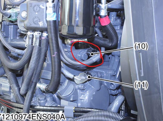

I thought I should check all the connections first, found this connector, ' Suction Control Valve Sensor Connector ' had come off, probably pushed off by a limb sticking into the compartment.
hooked it back up, fired up with no codes and no lights.
Lucky this time

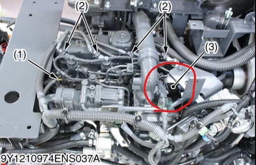

Might also check the Common Rail Sensor Connector
worth a try.
Note, I had to clear the codes after replacing the connector.
Easy to clear the codes, let me know if you need to know the procedure .
Good luck.

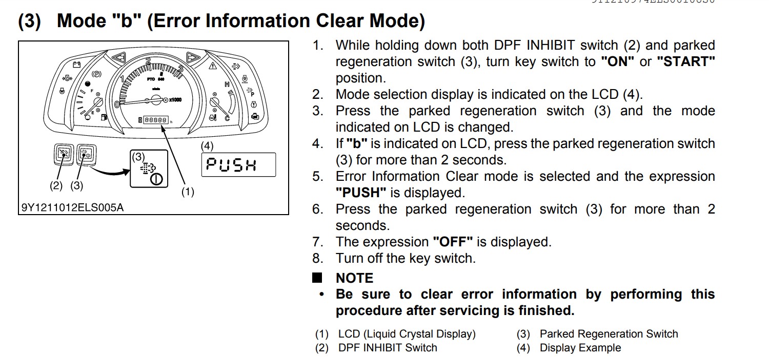

Thanks for the info. I will check that sensor. What is the procedure for clearing the codes?
captmikem
BX2660 MX 4800 and a bunch of attachments.
Mar 16, 2017
152
22
SW Washington State.
With the Tractor off, hold down the two orange square DPF buttons on the left side of the wheel while turning the ign switch 'on'.
release the two buttons, you should have an 'a' in the display.
Push the right DPF button once, you should have a 'b' in the display.
Push and hold the right DPF button for two to three seconds, you should see a 'PUSH' in the display.
Push and hold the right DPF button for two to three seconds, you should see an 'OFF in the display.
Turn the switch off, codes should be cleared.
Note, when you first start this, after holding both buttons down, the right button pushed and let go scrolls through your options:
a - Test Mode
b - Error Information Clear Mode
c - Acceleration Sensor Fine Adjustment Mode
d - Tractor Model Select Mode.
So make sure you have a 'b' in the display before push-and-holding the right button
until you push and hold the right button you have done nothing and can always just switch off and start again.
