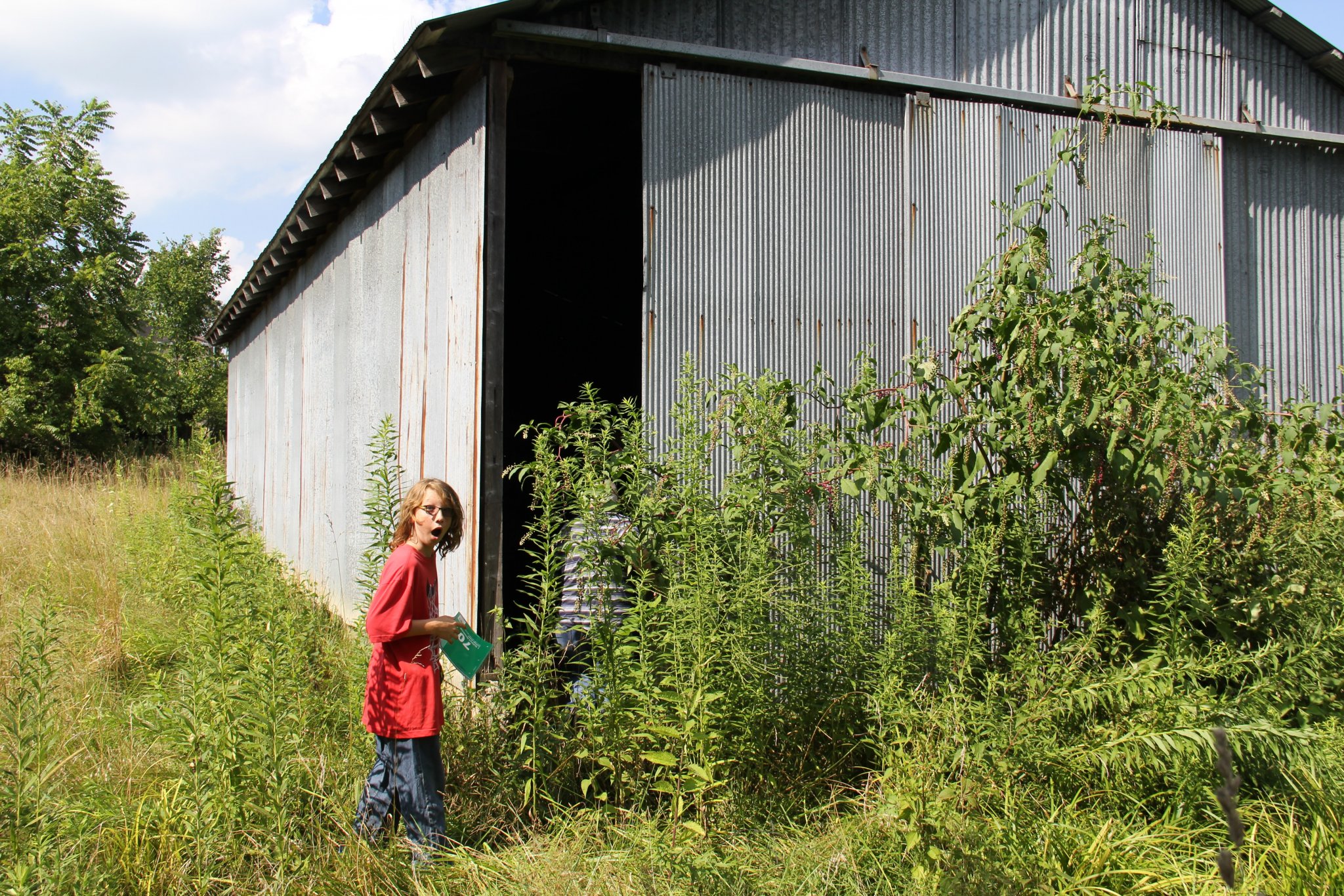

I will toss my 2 cents in, I'm a fan of the going slow. For two reasons, one which has already been pointed out, the other is when you are dealing with overgrowth, you just don't know what might be hidden in there. Going slow gives you time to respond to hidden stumps, implements, holes, fawns etc.
Here is a picture of the farm before we had started the clean up.
As we have been cleaning, we have found lots of hidden items and mud. Going slow will help decrease the chance that you get in a spot that you can't get yourself out or damage your tractor.
