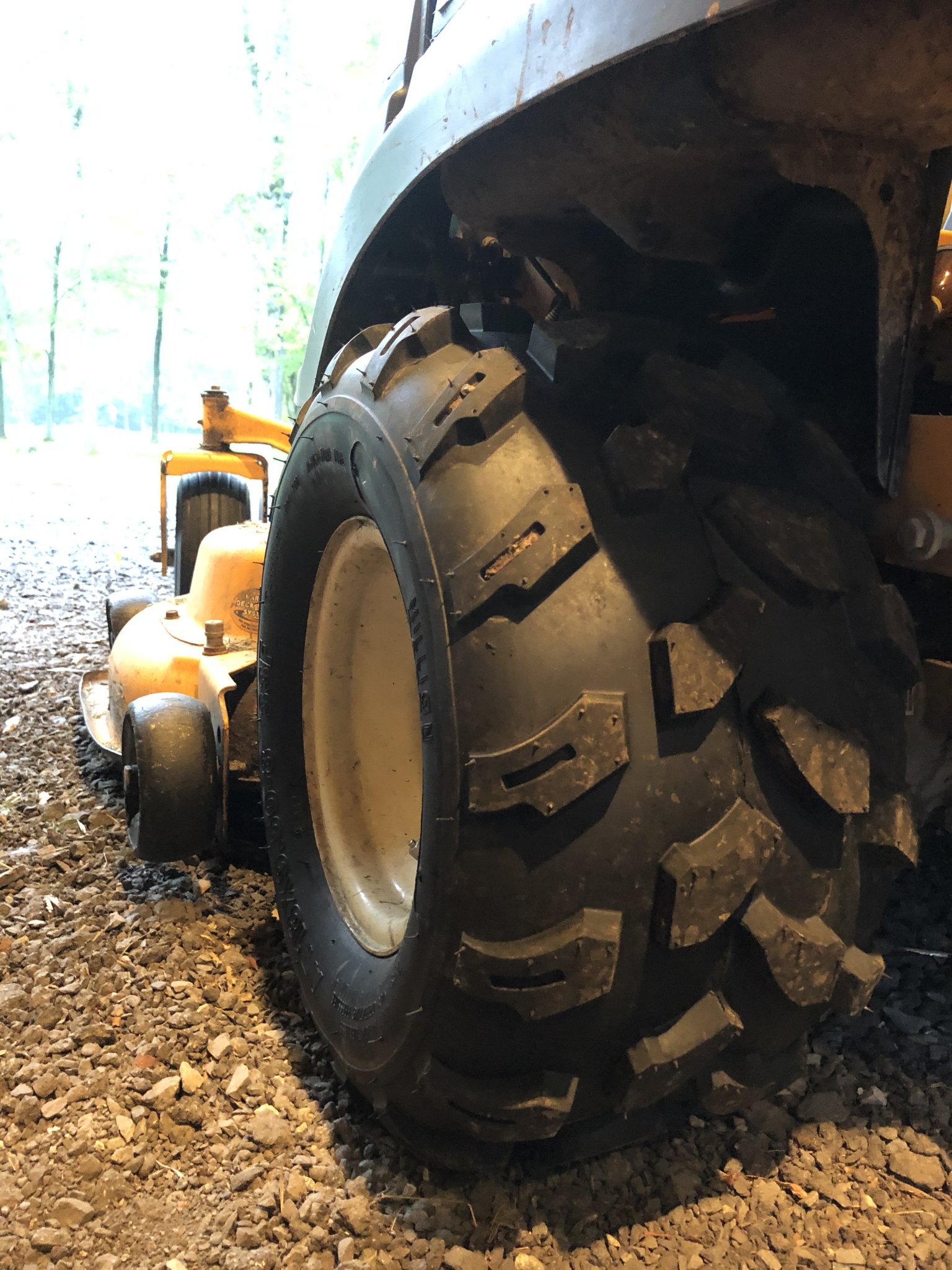

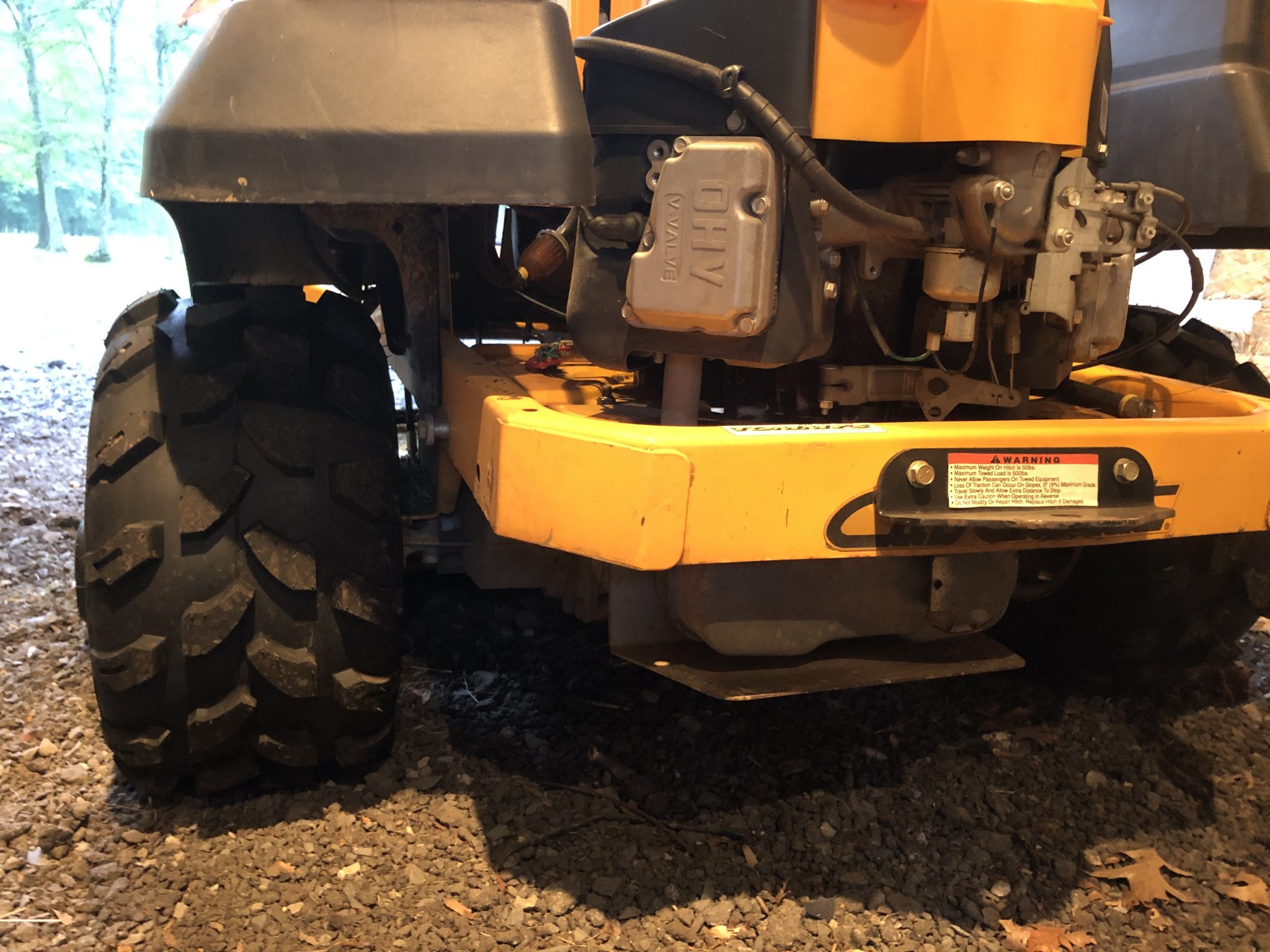

I found an interim "solution" to my problem...Installed some new shoes on the beater zero turn. OMG, what a difference! :pI used it this past weekend without any fear of getting stuck. The little mower ran up the berm of my shooting range without a hitch. I swear the slope in some spots on the backside of the berm is in excess of 45 degrees. I just had to make sure I backed down in a straight line.
$66 delivered to my door from amazon...well worth it in my opinion.
