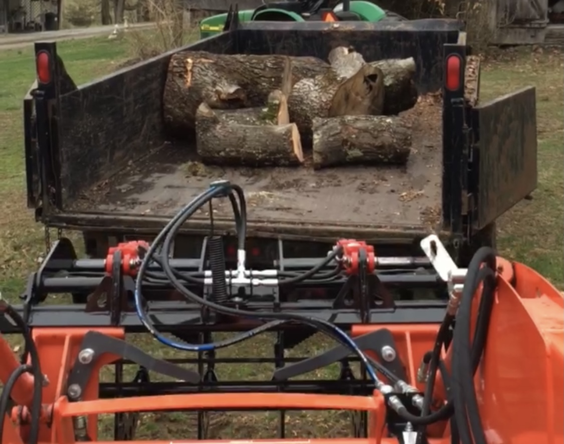

I had been in the same boat as you but wanted a ‘tweener’ that I could perhaps use with a tractor upgrade in a few years, so I ended up with a 60” 430# double-lid one. The double-lid was by far the BEST part about my pick. For my purposes and my long-term plan, the 430#er was perfect. I put a lot of ballast on the back end, especially since I later added another shim and now have my max pressure up to 2550psi from 2410.
Pic here was from before the pressure bump, though. I was easily getting two big ones at a time safely raised up and over the sides of this dump trailer. Same FEL as you, I believe.

Yep - LA525. Make and model of your grapple?
Looks like dead Ash in your picture which is what I am dealing with. My little B series would handle as many of those as I could stack in the bucket. A 18" x 8' log was an adventure but I have handled lots of them with the little guy. Undoubtedly more weight than the loader manual listed. Expecting much more from the L3901. The specs for it are roughly double the little guy.
