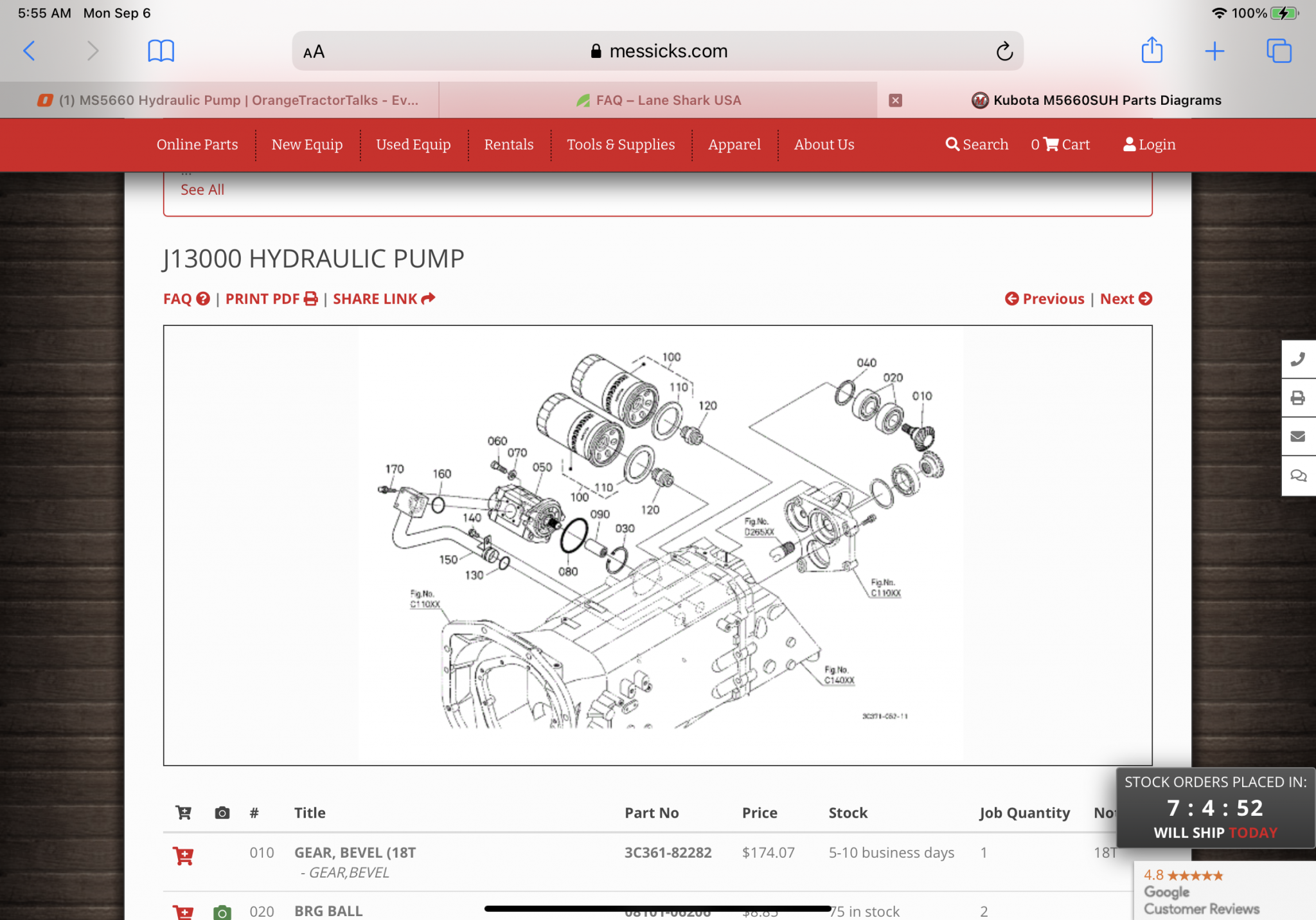

On my 2020 M5660, the hydraulic pump is on the right side of the transmission housing near the filters and it sticks out at a 90⁰ angle. It's driven by a bevel gearset.

What are you really saying? …that you’re willing to take a chance on spending $1500 on a pump that may not solve a problem you don’t know you have..?? …but you’re not willing to spend a $100 or two for someone knowlegeable and with the equipment to test the system for proper pressures and flows?
Even if you do this yourself you’re going to be down for two weeks either way….
I admire your courage and willingness to dive-in,… but at the level of capability you indicate you have, I’d recommend you take it to the dealer or call another tractor shop, maybe a mobile mechanic.
Here’s a pic of where your pump is located… item 050.
Hope this helps.

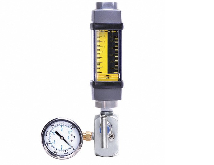

I have a couple nice new glycerkn filled pressure gauges on the shelf - cheap with or without a hose and adapters. An empty 5 gallon bucket and a stop watch is my poor man's flow meter.
Hope this helps.
Thanks for the diagram, that's exactly what I was
Thats kind of where I was going. My rig mechanic at work pointed me toward the Parker site for gauges, I just haven't made it over there to see how proud they are of them. He also mentioned glycerin gauges but my bout of Covid has prevented me from getting to town to go shopping until now.

A 2.5" 5000 PSI gauge should be about $15. - the fittings and hose will be as much as if not more than the gauge. That will give you mid scale readings with roughly 100 PSI resolution and plenty of head room.
I was serious - I have several new ones and the ability to make/provide whatever you need in the way of hose and fittings. I am no where near as proud as Parker. Grainger also sells Hedland test kits with a 15 GPM flow meter, 3500 PSI pressure gauge and adjustable loading valve all manifolded together for $120. Personally I haver had the need for that kind of flow measurements on a agricultural tractor but if you are a tool junky like me its a nice looking gadget at an affordable price.
I might get with you on one. My rig mechanic has some nice digital gauges down to fractional bar he hooks to my cranes occasionally but I don't have a $20k/month maintenance tool budget. LOL
