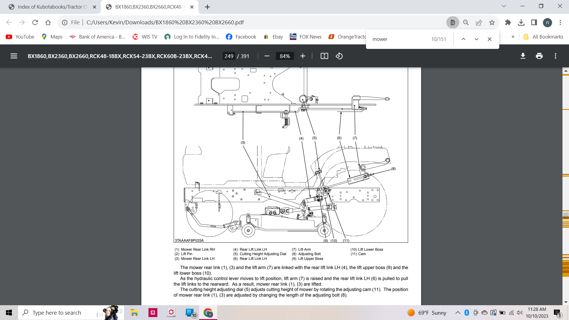

When I was under it, towards the driver's side but right by the knob shaft I saw a cable. It went into a 90 degree elbow. There was a nut on both sides of the elbow. I was wondering if that was related. Does that sound right, and if so, do you know which nut might be the one to adjust? The one on the horizontal or vertical part?
Either way, thank you for this info. Gives me a starting point.
You're in the wrong place. There is no cable associated with adjusting the lift on the mower. Take a look at this and see the instructions below the pic.

imnukensc - Thanks for posting the diagram. I appreciate it. Also, that cable I was referring to was with the deck off. It's right next to the height adjustment knob and shaft. I still don't know what it's for, but it's unrelated to this.

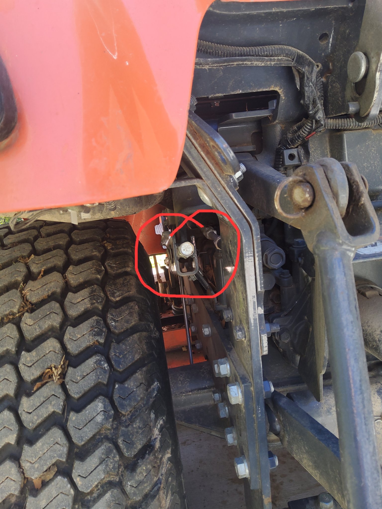

*** RESOLVED ***
Wanted to post an update.
Quick version - Seems to have been the bolt pictured below. Maybe considered the side link bolt. Rereading RCW's post, this is what he was referring to. I was picturing something under the tractor.
The service guy yesterday had suggested this, but given that the height knob turned fine without the deck on, we leaned towards the front link / attachment.
After pretending i knew what I was doing, looking at the manual, adjusting the front, throwing everything off and then trying to correct it, I tried the knob and it still wouldn't go into top.
I then brought in the bolt a bit, and it worked. I backed it out so it's about 1/4 turn in just enough for the knob to turn.
Thanks for all the responses. This is the best the knob has turned in the 11+ years I've had it. It's always stuck a bit at the top.
